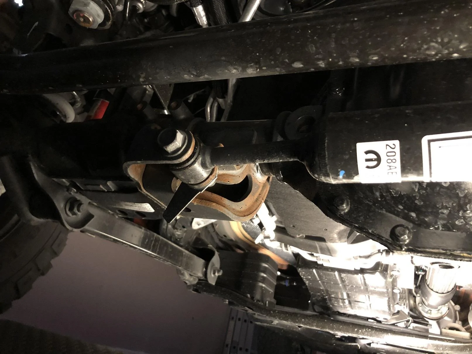

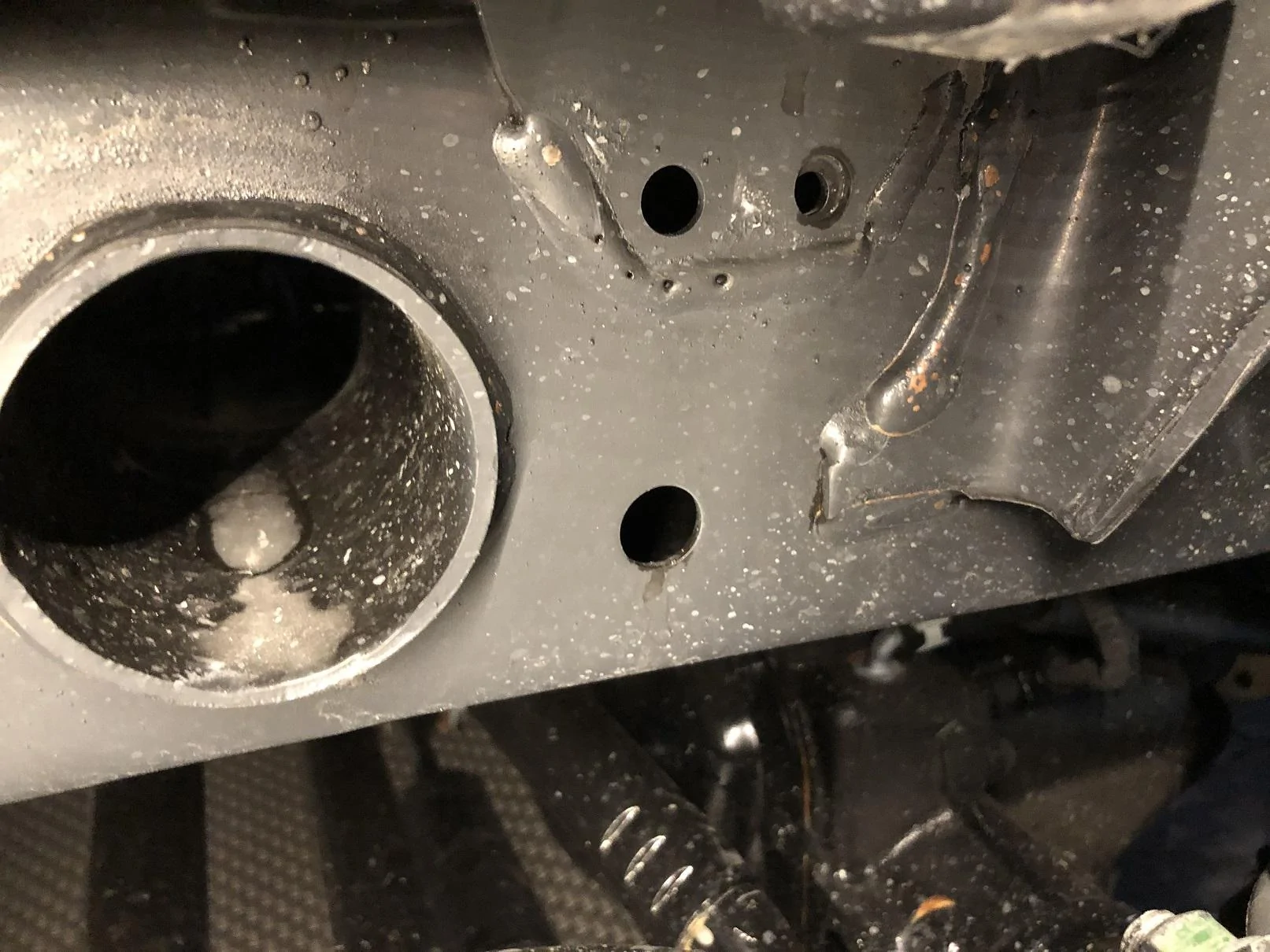

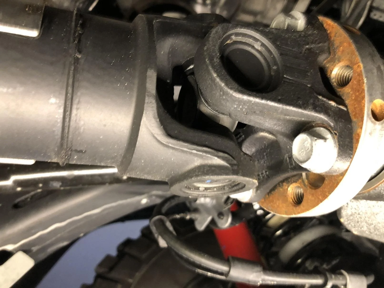

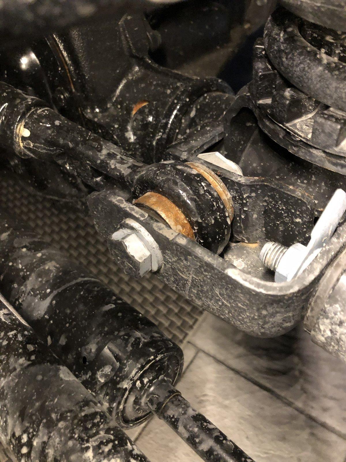

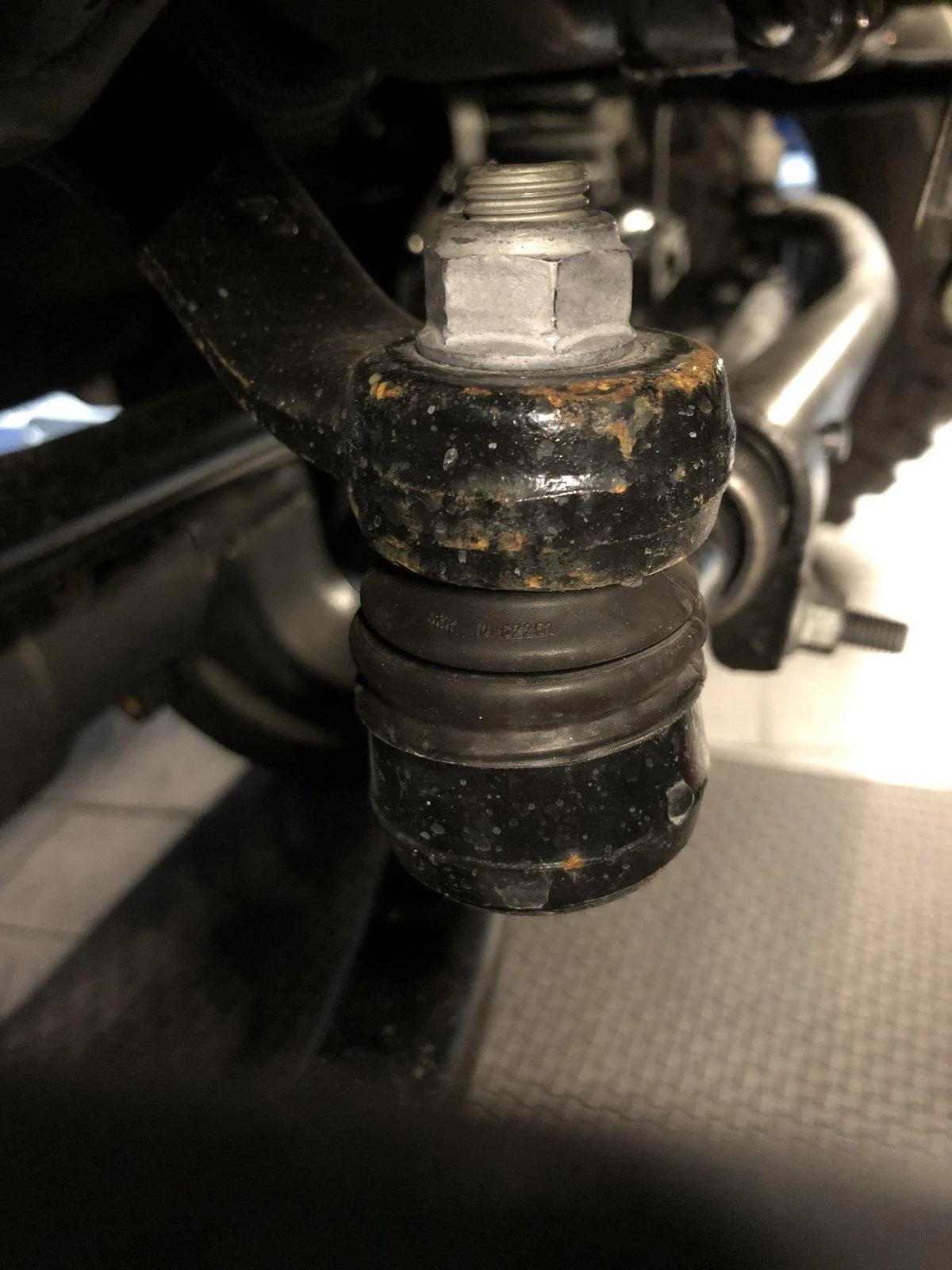

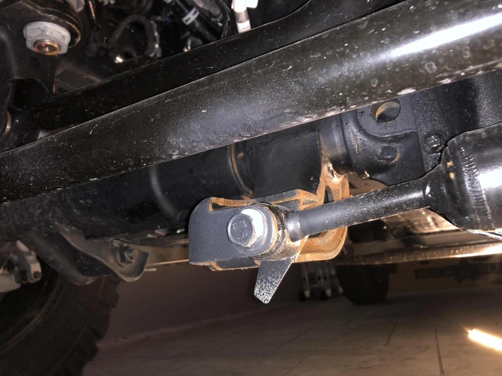

Yes, unfortunately I can report rust on JLUR 2020 (manufactured October, 2019) delivered to me this Tuesday - 2/11/2020 (7 months delivery time).
Went under the Jeep for routine inspection of front suspension as many people advise to do that after receiving the Jeep, and I found this:

I personally don't see any real rust in these pictures. Most of what you see is light surface rust. Similar to what you get on your disc brakes when a car is not used couple of weeks. I don't see anything here to worry about except the holes in some of the welds. Looks like they still having issues with the welds not being consistent.
I looked under my 2019 4Runner and noticed similar surface rust on different parts.

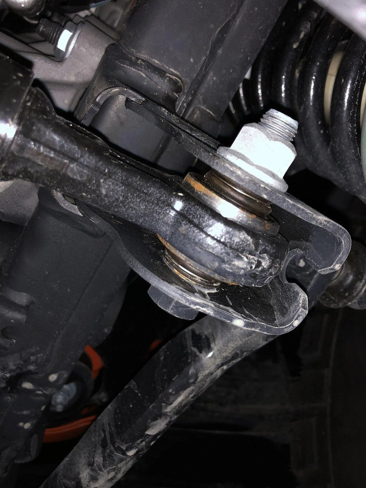

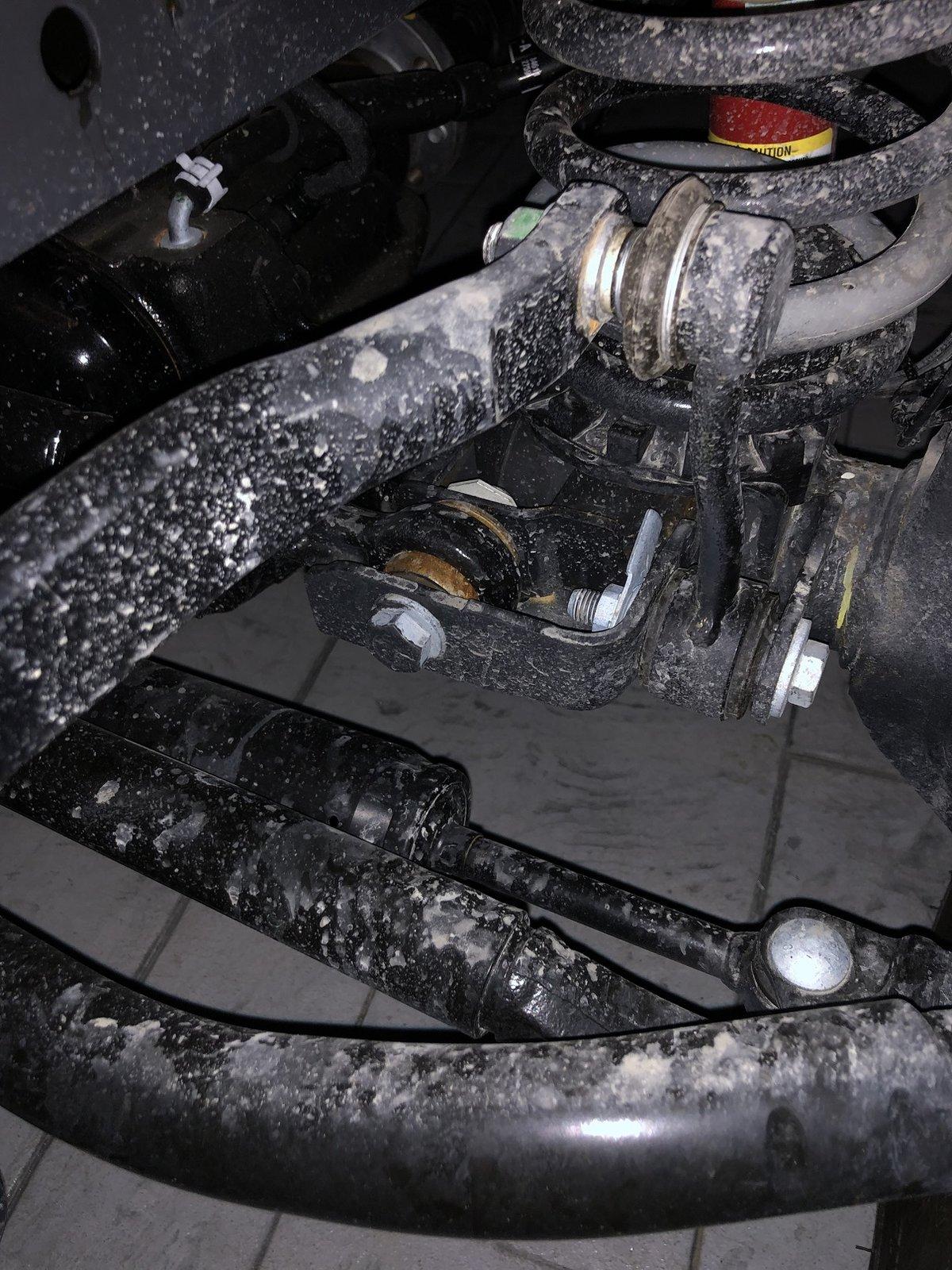

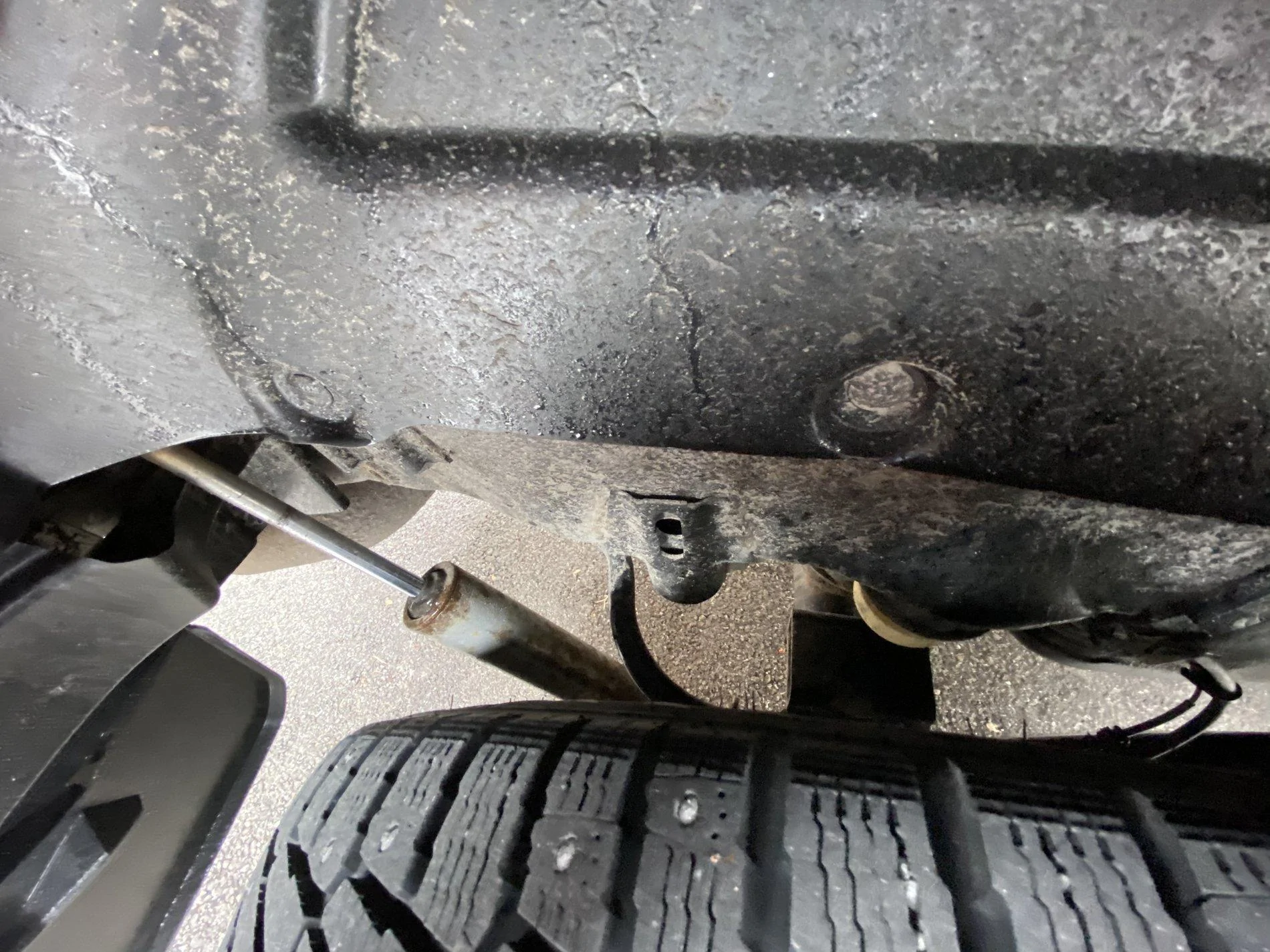

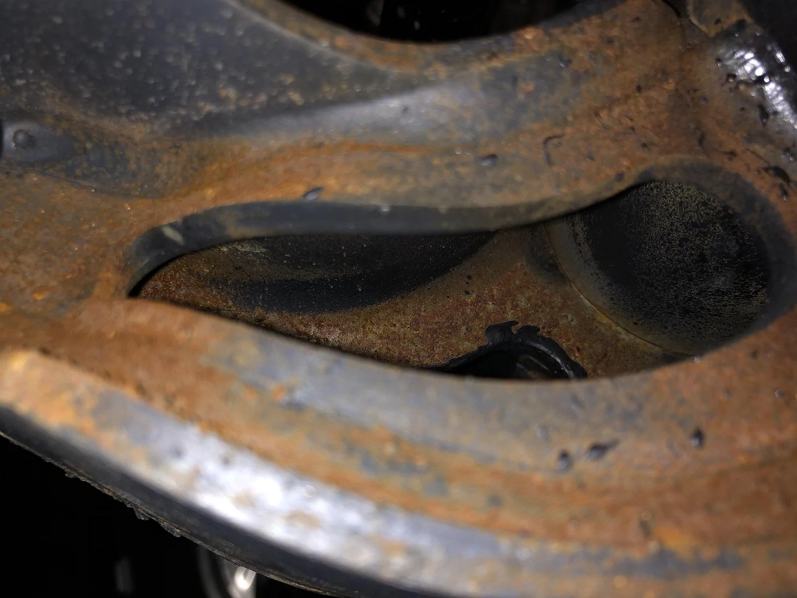

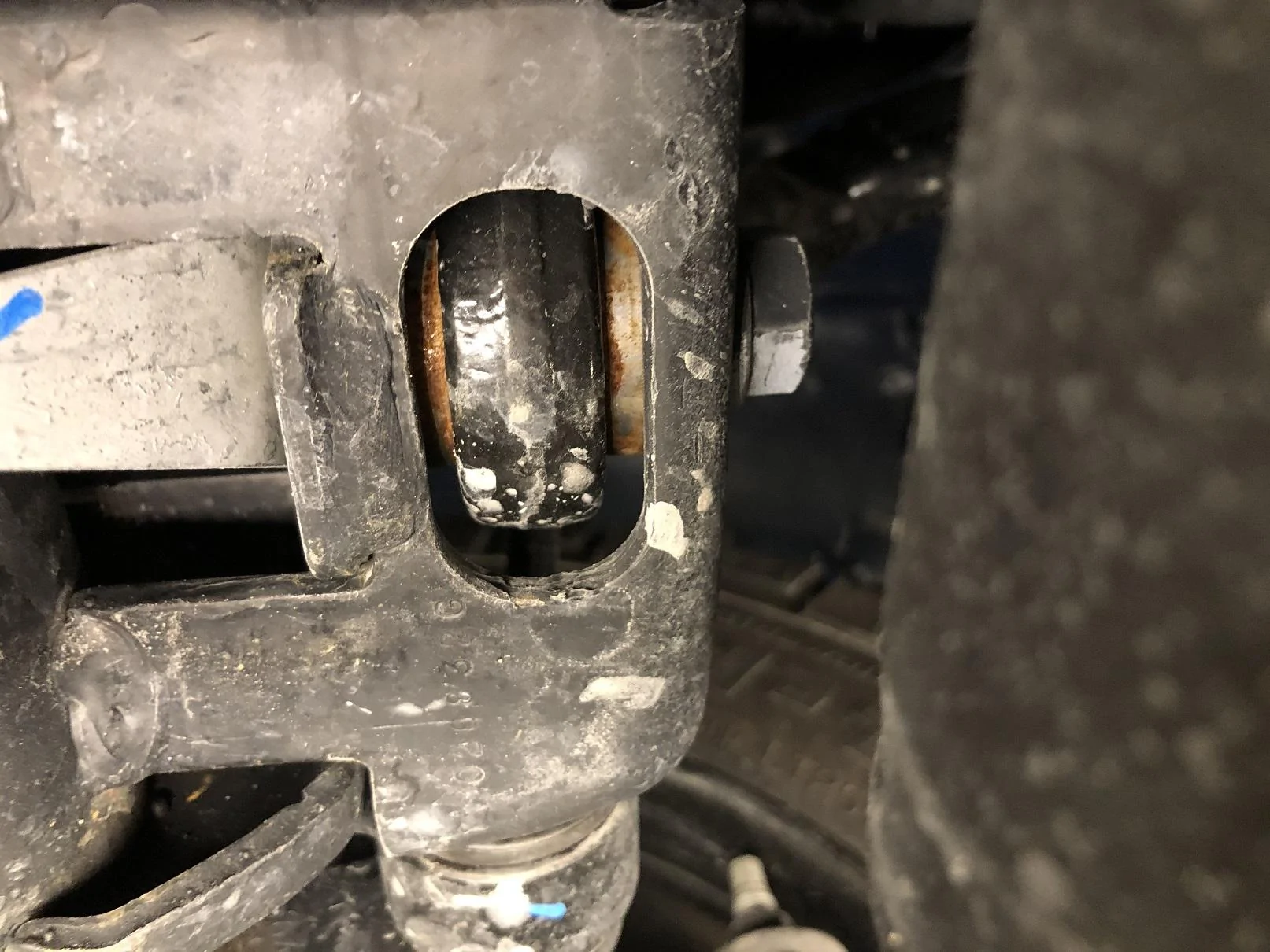

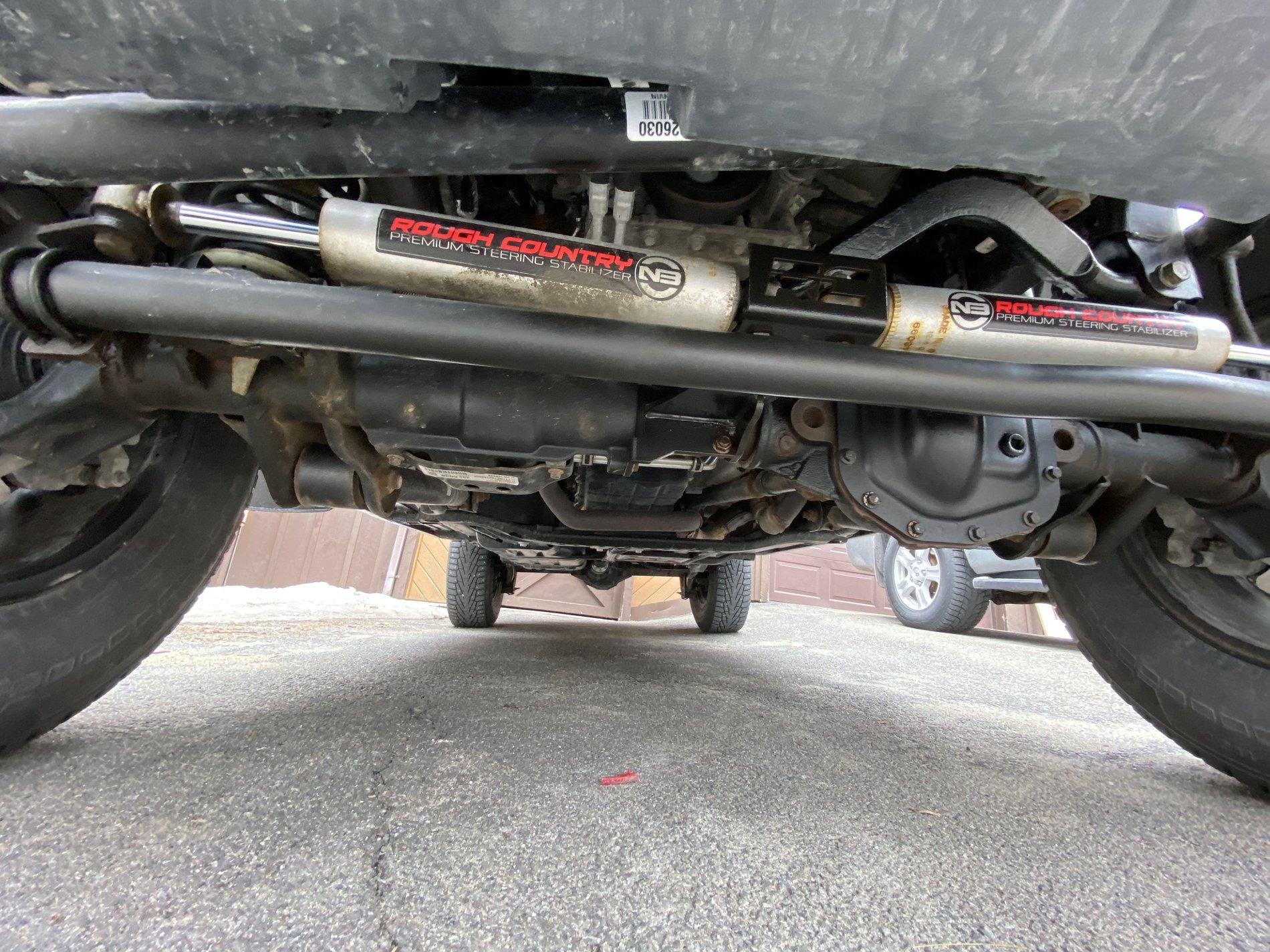

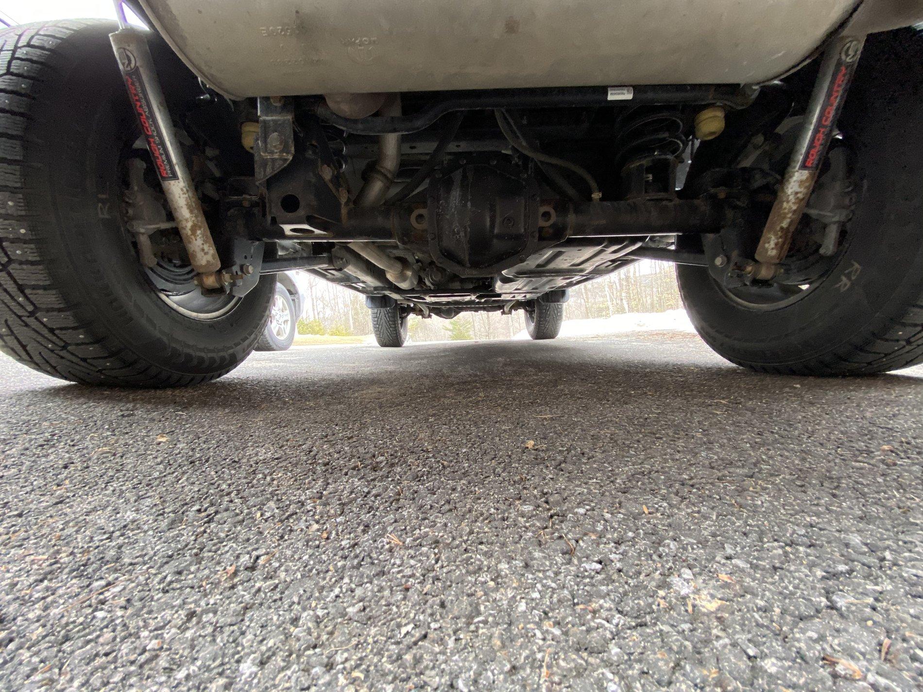

I have a Jeep jlu 2018 that has been through a harsh winter with salt on the roads and I have a little bit of paint chips and surface rust on the frame primarily in the back. Was wondering if anyone has any recommendations on touch up paint I could use on the frame.

Well, as far as I understood, the surface rust is more in our minds than a real danger. Salty winters are something most damaging - from your pictures I'd be more concerned about the rust on the shock absorbers, still not too bad I guess. Reg your question - I think simple cleaning from dirt, then mild treatment with harsh brush, degreasing with alcohol/white-spirit and painting with some good quality spray paint (e.g. "Rust Oleum") is more than enough, IMO.

That rust is insignificant but you could spend a little quality time under your Jeep with a Rustoleum rattle can.

No issues with what I see.

I agree, almost a year of wheeling and of course no issues. I just was surprised to see that on a brand new car just delivered...

Neither Jeep nor others go under the vehicle after asssembly with a paint spray gun. You are seeing the various painting qualities of the vendors of various parts, and the unpainted machined surfaces in some instances, where two parts must mate squarely, and a paint drip or bubble could become an issue. If concerned get out your rattle can and touch up once in a while.
