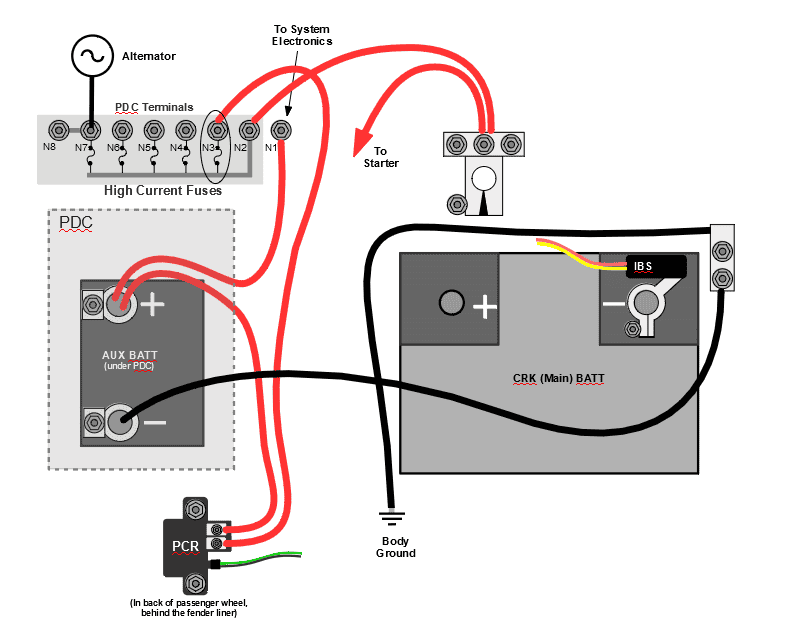

With a properly functioning system, the main battery and aux battery are wired in parallel except when auto stopped. If something is draining the aux battery and not the main battery, the batteries are no longer in parallel. A blown N3 fuse breaks the parallel connection between the batteries and prevents alternator power from charging the aux battery and powering the system electronics. The system electronics run off of the aux battery until the aux battery is drained.
You can verify a blown N3 fuse by a lack of voltage at the N3 terminal and you can move the wire from the N3 terminal to the N4 terminal to restore the connection from the alternator to the aux battery and the system electronics.

It sounds like your N3 fuse is blown and if that's the case, you can move the wire from the N3 terminal to the N4 terminal to get power back to the system electronics.

Update: I have spoken to my mechanic and Jeep wants to replace the entire PCB. I asked him to change the high amp bar next to the battery since it’s possible that the N3 or N4 fuses could be blown. So we will see what happens

There's probably nothing attached to N4, that's what makes it an option to move the N3 cable to.

Jeb do you think replacing the bar will fix it ?
As you describe the problem, I think it's likely. But temporarily moving the cable will test and verify. Using a temporary jumper to get 12v to the N3 terminal will also verify if it's a blown N3 fuse. If the main battery is charged, not seeing 12v at N3 also verifires.

If they change the fuse bus, there is no need to move the cable. Moving the cable is a temporary work around until the fuse bus can get changed.
