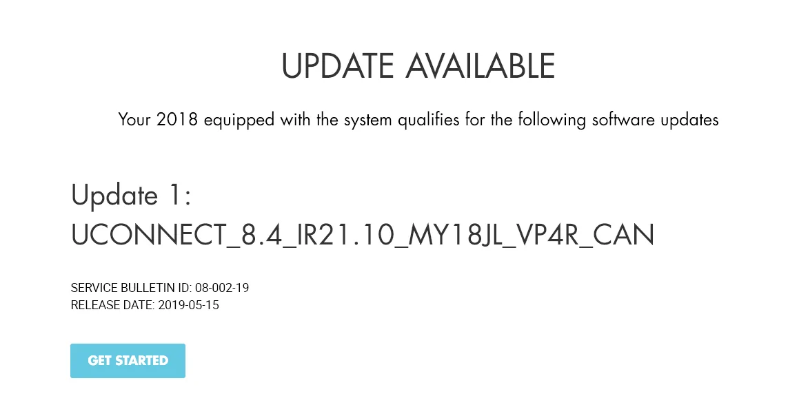

there is actually a new software update out (May-15th for me) on the Uconnect site (provide your vin) that you can download yourself and flash, and it specifies to fix blue screen and audio/radio issues.

@Arterius2 awesome to hear, but i went to drive Uconnect.com, but it doesn’t Show an update for my VIN. Where did you see yours? Thanks

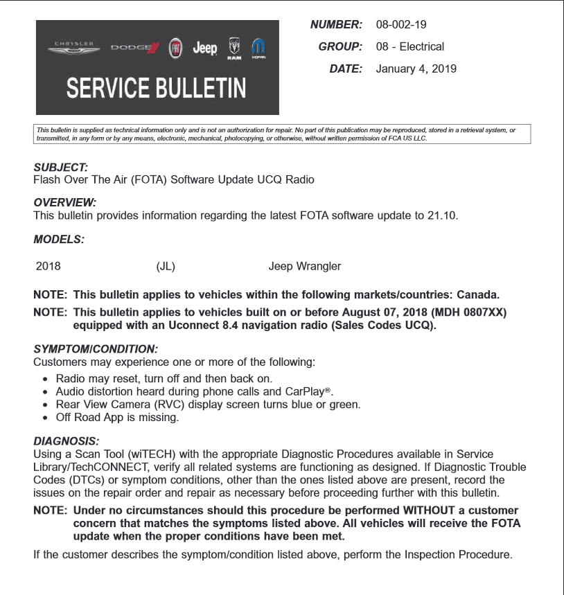

I can do a screen capture when I get home, (will be a while though) giant download- 9.3GB! I’m planning to install it tonight, have it downloaded earlier today, I think they may be releasing the update in batches according to vehicle manufacture date, mine just barely made the cut, it says for wranglers on or before August 7 2018, mine was built on August 7th, haha.
The update specifically mentions blue screen of death and intermittent audio issues.
