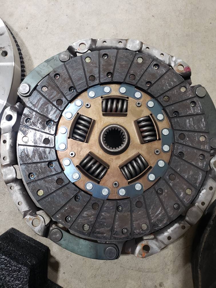

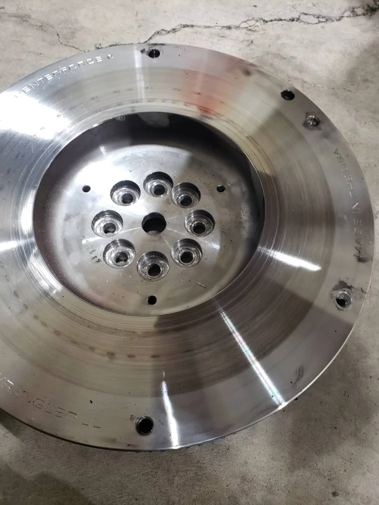

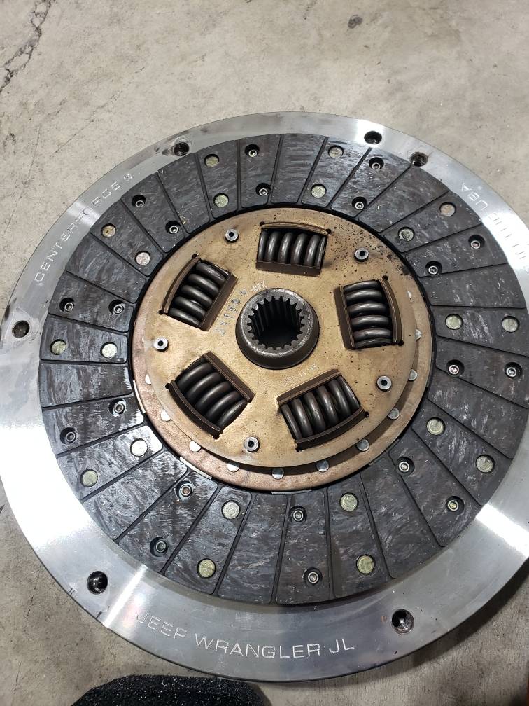

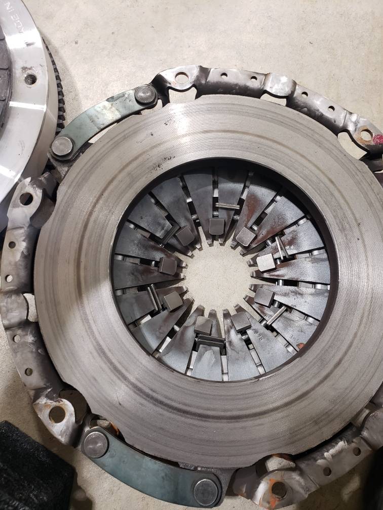

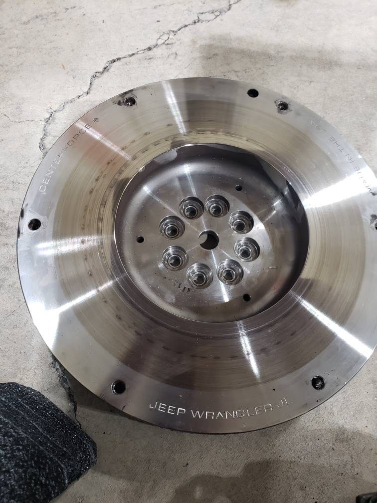

Ok so we got it apart and this is what it looks like
Jeep Wrangler JL 1st and reverse problems after market clutch 6774A311-274B-41ED-A470-6FF03FEA89BE
Jeep Wrangler JL 1st and reverse problems after market clutch 41B480EA-D2F2-4E16-96E5-9B11631B7F34
Jeep Wrangler JL 1st and reverse problems after market clutch BCB60874-B7CC-4666-9C45-9CEED3DEA60D
Jeep Wrangler JL 1st and reverse problems after market clutch D8205CBA-708E-4F02-983D-551659E69ED8
Jeep Wrangler JL 1st and reverse problems after market clutch 5C63041E-D43C-4360-9A79-9298C4938C7E
Jeep Wrangler JL 1st and reverse problems after market clutch 4C343BCB-52E1-4840-AD8B-1E886E5AD5F0
. Not sure why it looks like this. But definitely some burn going on. Summit has already sent a new clutch to replace it.

Sucks to have to do it twice, but good luck with round 2!

You would think a dealership will have someone good in the back shop. If not they will be after the recall comes down!

interesting. looks like it wasn't working properly. kind of looks like just the center was engaging on the clutch plate. almost like the outer edge isnt moving at all

I talked to cf I sent them the pictures of the cf clutch, I was having problems with, they requested to send me a new clutch plate that they tested on the bench to go with the new clutch kit.
I put it all back together with the new plate from cf and so far so good, 150 miles on the new clutch shifts great, and everything operates as it should.
My conclusion is that the clutch plate was not sliding on the shaft and not disengaging.

It appears the release bearing has some offset wear between the center plastic guide and outer bearing housing. The center plastic guide slides on the trans center hub so I'm assuming the release bearing fork pivot was not seated on the ball correctly causing the bearing case to not contact the pressure plate flat and shift to the side causing it to contact the plastic center.
OP, did you see this when you disassembled the clutch? Is there anything else that would cause the outer bearing case to shift and rub against the plastic center?
