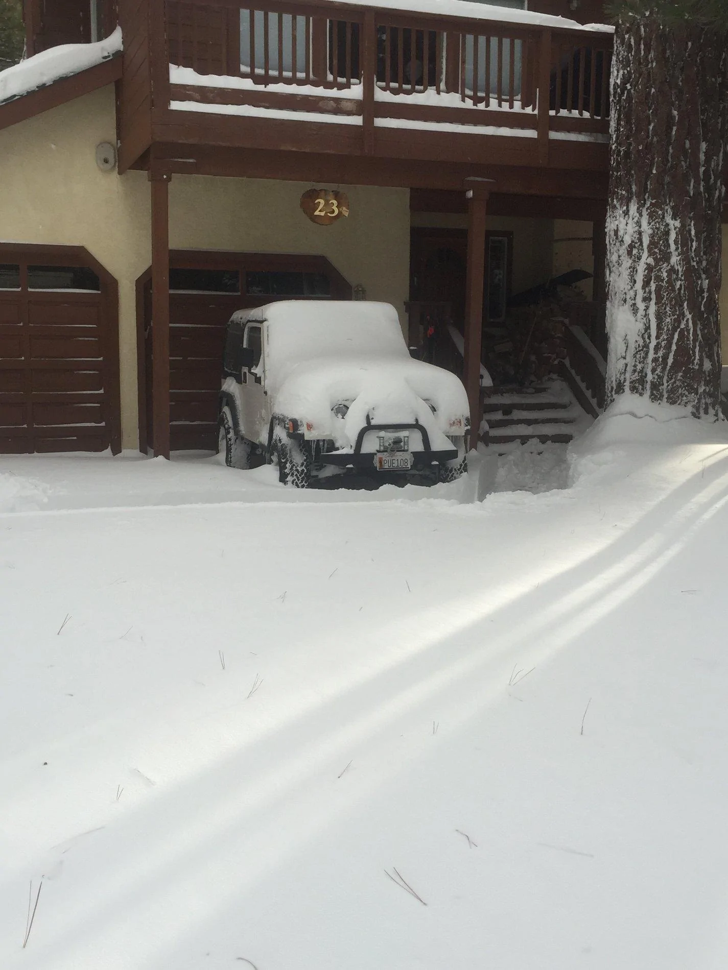

I seldom use my lockers in the snow. In deep snow the tires seem to pack it down to ice and the wheels just spin. The best thing in deep snow are old fashioned ladder type chains.
Jeep Wrangler JL Lockers v. Limited Slip Differential in DEEP snow IMG-0866
