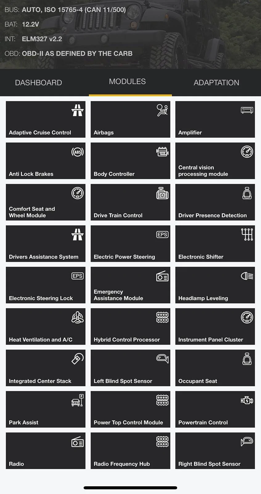

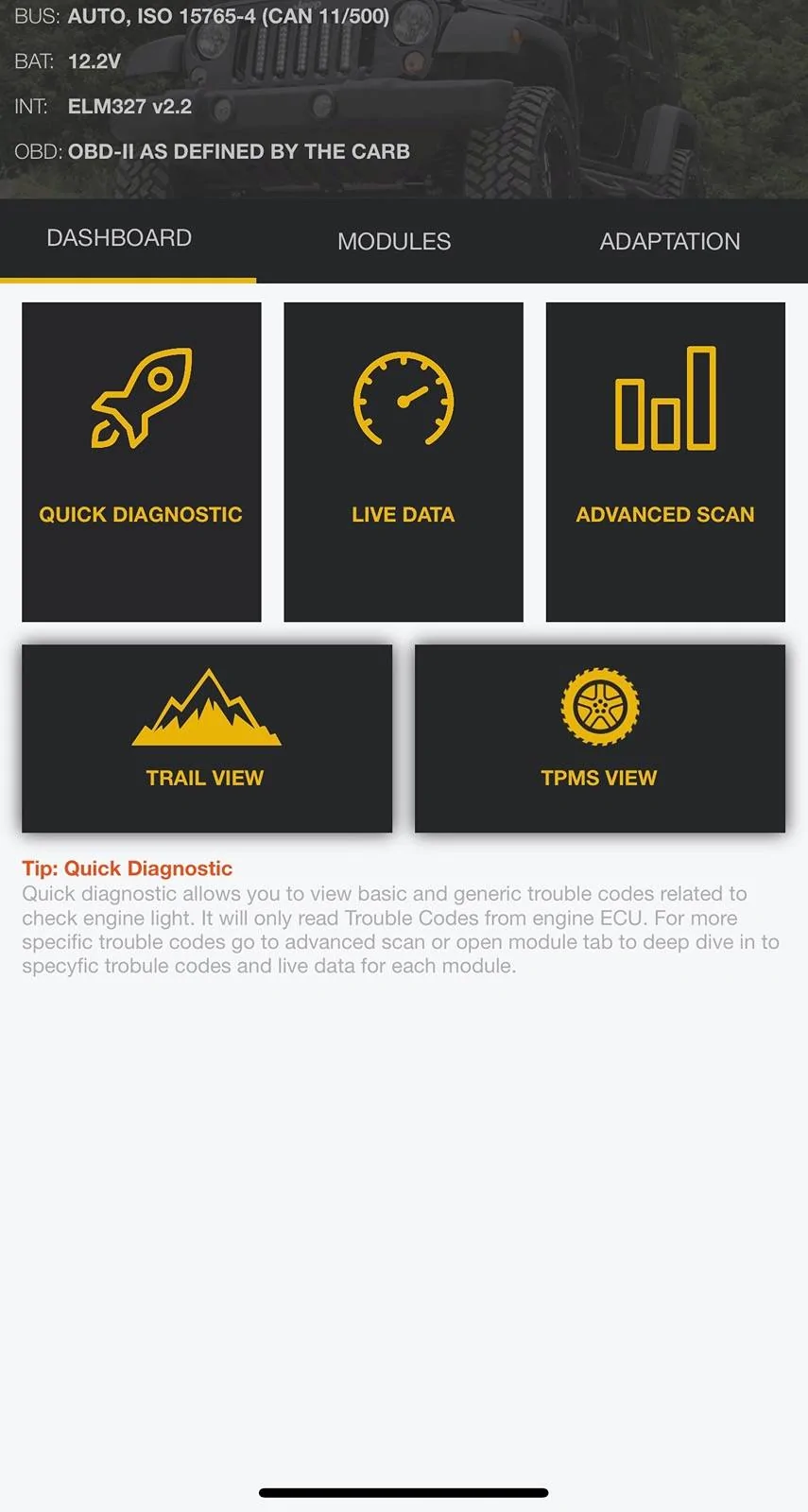

Has anyone done this process with their JScan app? I’m trying to run this procedure now but cannot find it in the app. Any advice is appreciated.

or go to adaptation -> vehicle maintenance -> PCM CLUTCH REPLACEMENT EEPROM RESET PROCEDURE

Sorry, should have mentioned… I can’t find any search functions (IOS). I looked through some of the modules but could not find the transmission module will not connect…

@surferbandit
You need to update your JSCAN app! This adaption is a very very new add to the app..... SO, you need current / latest JSCAN app update.
Version v25.04.2024.18:45 is current version and does have -> PCM CLUTCH REPLACEMENT EEPROM RESET PROCEDURE
