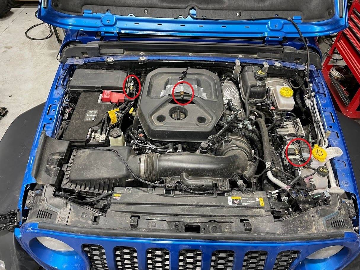

TEST EQUIPMENT

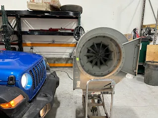

For these tests, we loaded a bone stock 2024 Jeep Wrangler 2.0 turbo 4 cylinder on a load bearing hub dyno made by DYNOmite. By doing so, we were able to conduct all the tests in a controlled environment and were able to load the Jeep (provide resistance at the axles) to stimulate real world driving. The dyno has its own built in weather station to describe ambient conditions:
Jeep Wrangler JL TOTL Innovation H.E.R.O. Hood Performance Testing Results (Temperature / Cooling Measurements) TOTL-Hood-Testing-WeatherStation
To take readings, we turned to Banks Engineering who we consider to be at the pinnacle of the aftermarket industry. They use their own products for internal testing so we followed suite. We ordered their Banks Data Monster and coupled it with 3 separate temperature sensors that we strategically placed throughout the engine bay. We wanted to sample an average engine bay temperature as well as temperatures at critical electrical components.
Jeep Wrangler JL TOTL Innovation H.E.R.O. Hood Performance Testing Results (Temperature / Cooling Measurements) TOTL-Hood-Testing-EngineBay

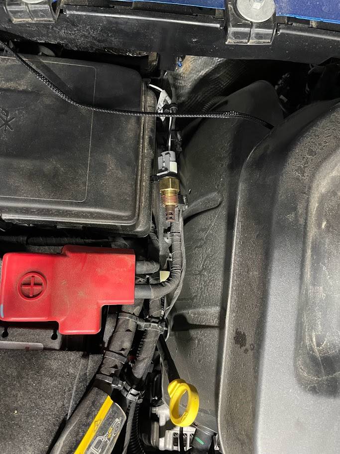

The first temperature sensor was placed close to the fuse box located by the passenger side firewall
Jeep Wrangler JL TOTL Innovation H.E.R.O. Hood Performance Testing Results (Temperature / Cooling Measurements) TOTL-Hood-Testing-FuseBoxTem
The second temperature sensor was placed on top of the engine cover and was spaced away from the surface using a foam pad. This was meant to give us an average engine bay temperature reading.
Jeep Wrangler JL TOTL Innovation H.E.R.O. Hood Performance Testing Results (Temperature / Cooling Measurements) TOTL-Hood-Testing-EngineTem
The last temperature sensor was placed by the factory ECU on the driver’s side
Jeep Wrangler JL TOTL Innovation H.E.R.O. Hood Performance Testing Results (Temperature / Cooling Measurements) TOTL-Hood-Testing-ComputerTem

To begin each test, we let the Jeep idle until we noticed all 3 of our temperature sensors had reached a consistent temperature. At the point, we considered the engine bay to be at its saturated operating temperature and an equal starting point for each test. We would like to note that we monitored coolant and oil temperatures at the same time and couldn’t use them as a reference for starting each test because they reached their specified operating temperatures well before the engine bay temperatures.
Once temperatures were reached, the test started and we logged each one for approximately one minute. Once a test was complete, we waited for temperatures to reach the same baselines previously established before moving on to the next test.

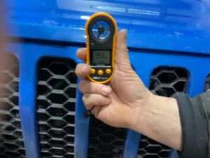

For the speed test described below, we measured that the wind speed at the front of grille was 35 mph when the dyno fan was roughly 25” away from the Jeep so we decided to run these tests at that speed to try to simulate as close to real world as we could.

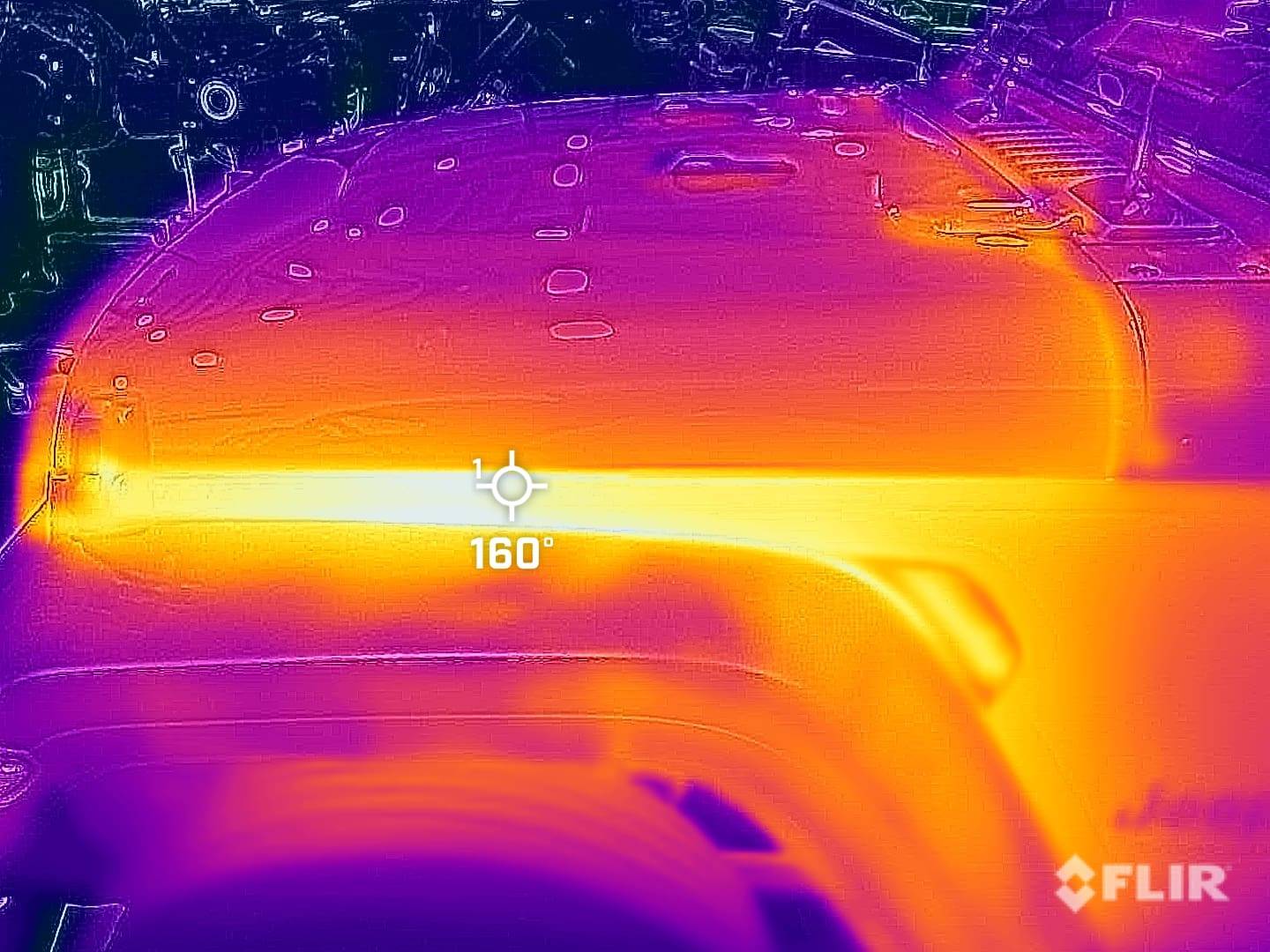

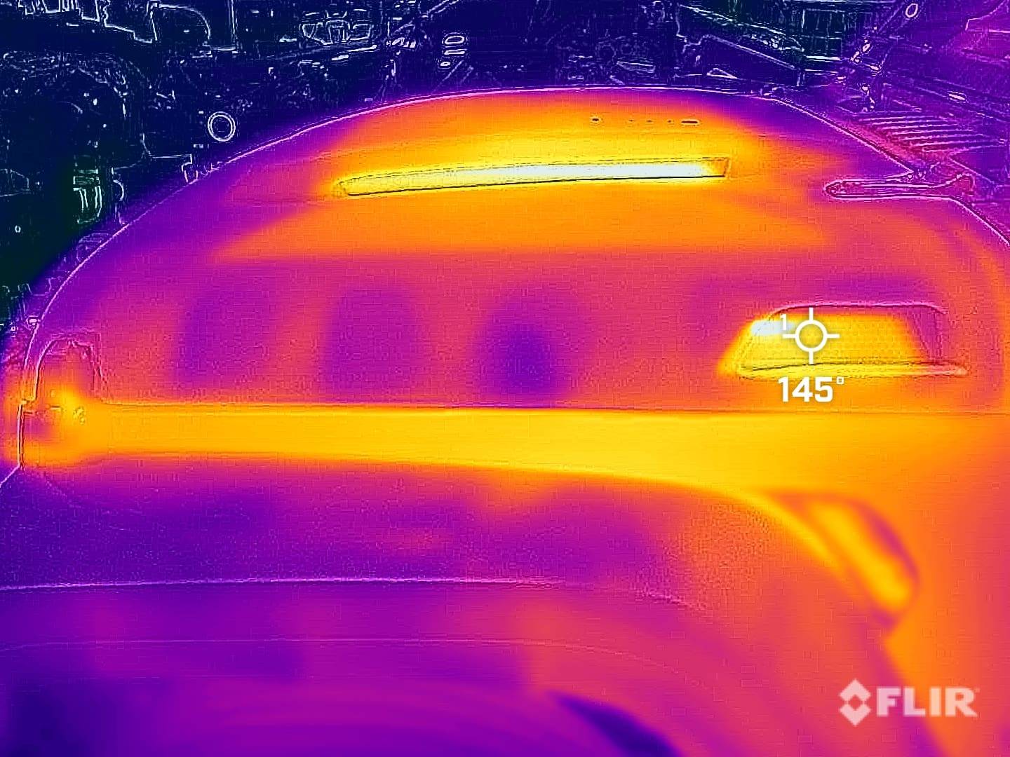

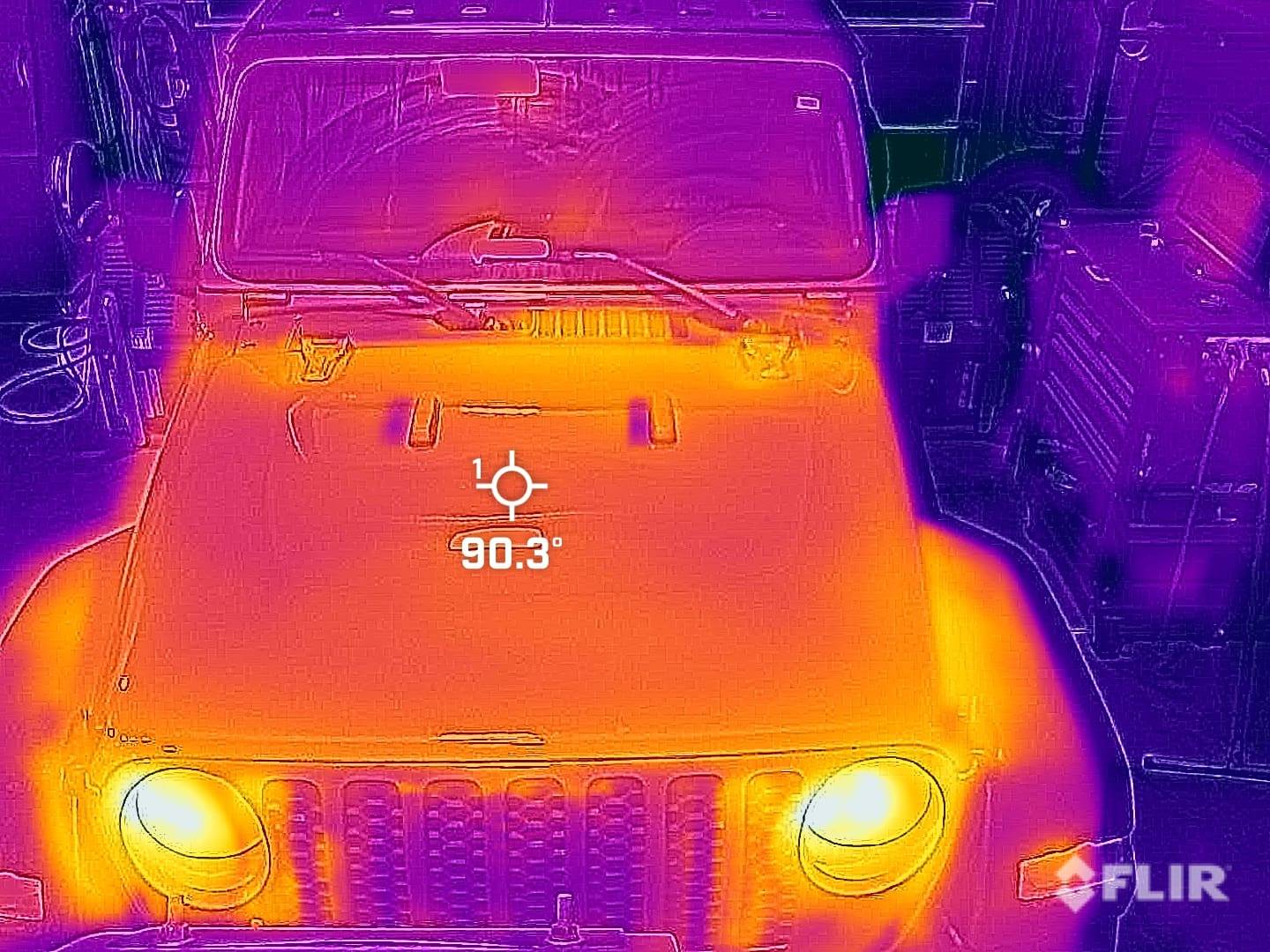

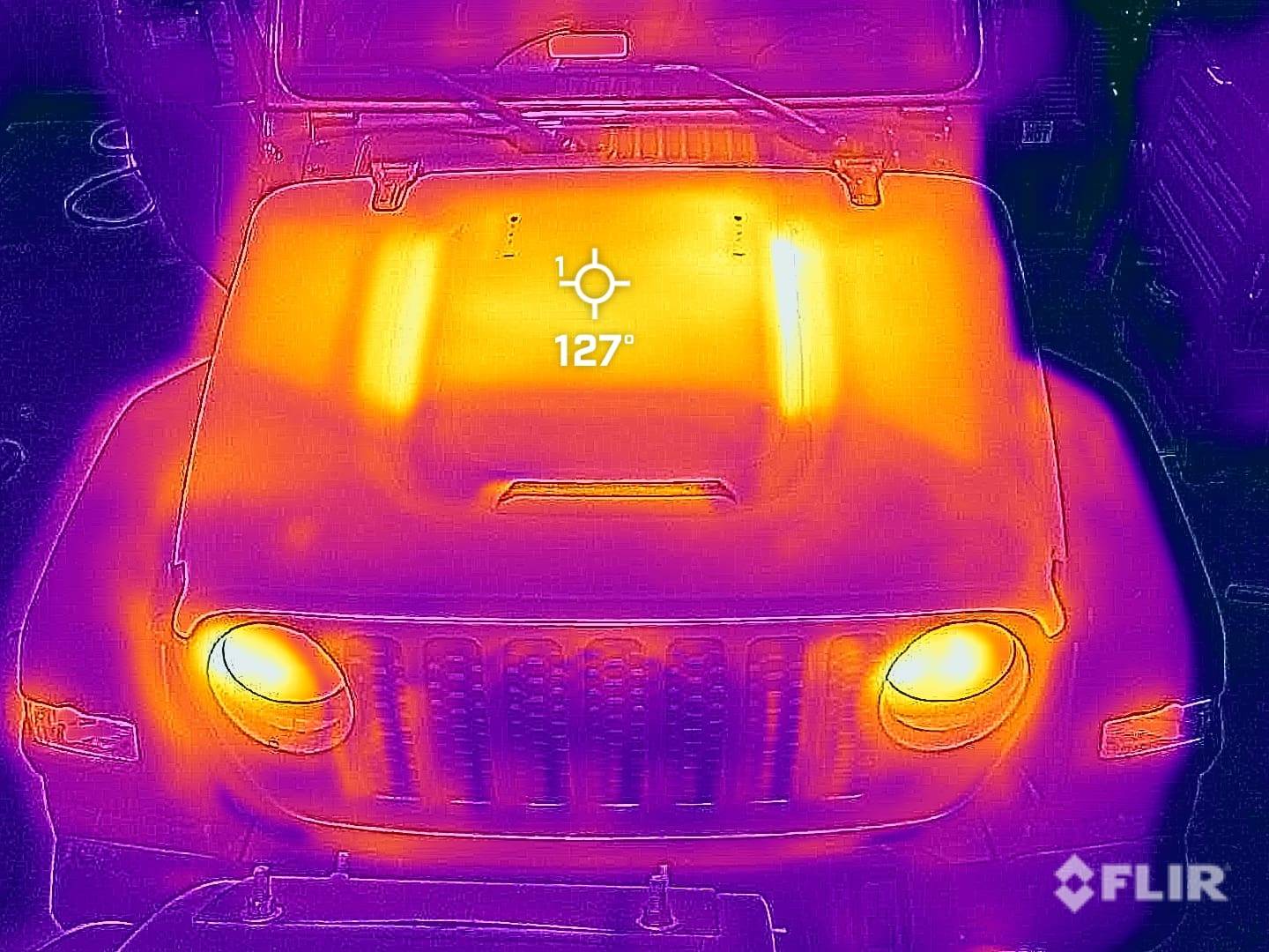

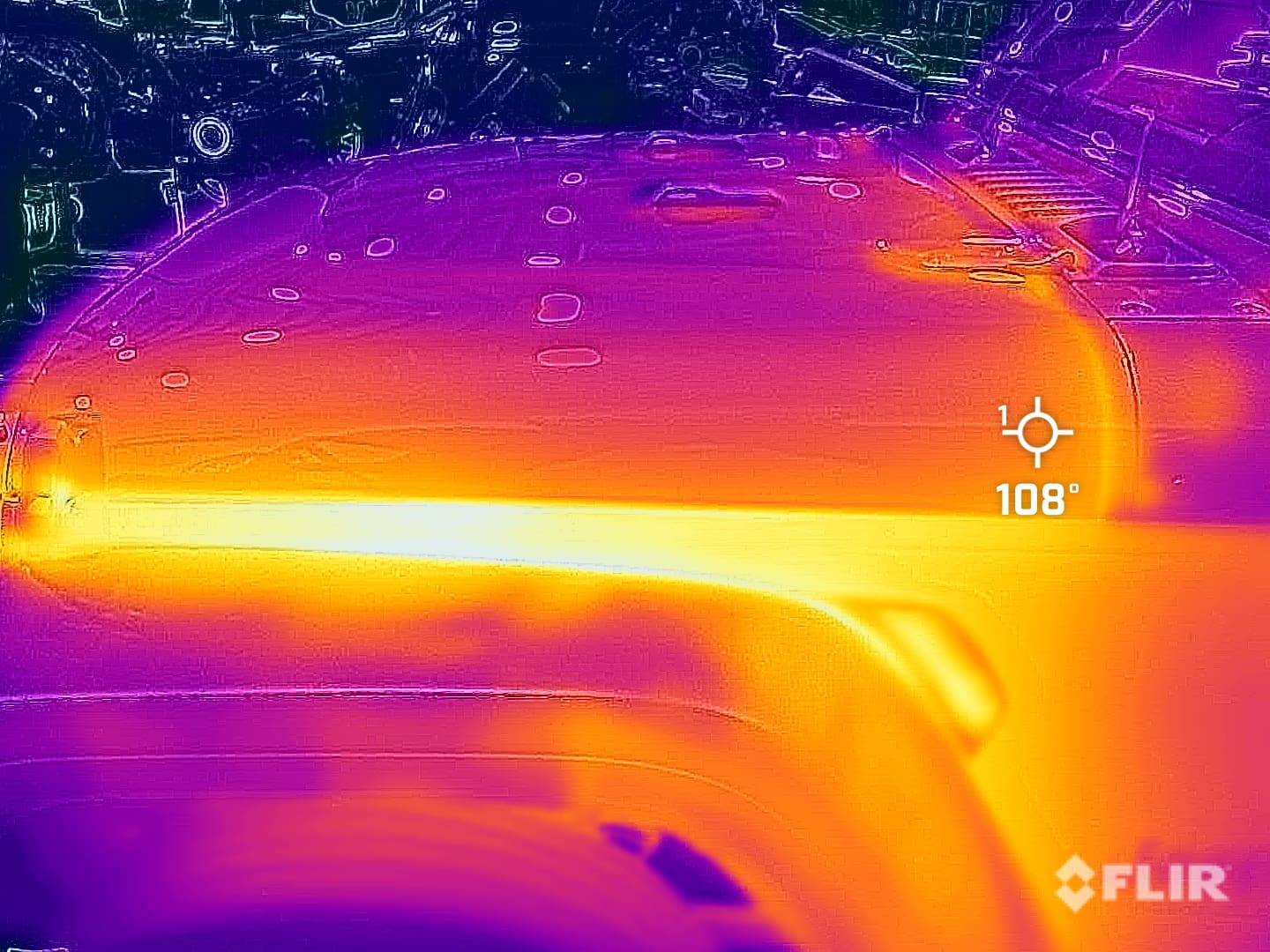

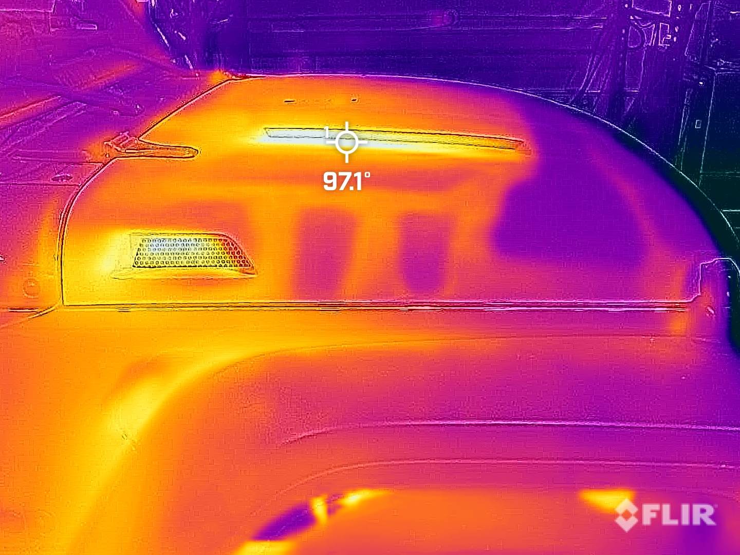

IDLE TEST
The first test we wanted to perform was a Jeep sitting at idle. We wanted to see what is happening in the engine bay without any sort of external factors so the dyno fan was not running. This would be similar to a real world traffic at a stand still type of scenario. We also wanted to measure the impact that any hood would have on the engine bay so for this round of testing, we actually tested the factory hood, our H.E.R.O. Hood and one additional test where the hood was rested over on the windshield. This would give us a floor of the best conditions possible had nothing been covering the engine bay at all. This was the only test where we tested with the hood completely removed from the equation. All other tests were the factory hood vs. our H.E.R.O. Hood
Looking at the summarized averages of the three tests below, you can see that there is roughly a 60 degree difference across the three temperature sensors between having no hood and running the factory hood but look at how much heat is able to escape the engine bay through our two stage vent design. Switching over to our H.E.R.O. Hood netted an average 26 degree drop across the three sensors.
OPEN HOODFACTORYTOTLDIFFERENCE
Fuse Box Temp (°F)122.00187.27163.8823.39
Center Engine Bay Temp (°F)149.99210.03184.6325.40
ECU Temp (°F)115.31187.86159.2628.59
What really surprised us on this test is what was happening inside the air box once we got all this heat out of the engine bay. The air temperature going into the motor also dropped by 25 degrees as measured by both the Air Mouse (Ambient Air Temp) located in the air box and the factory ECU (Intake Air Temp) resulting in a slightly better ambient air density. For those interested in reading why we are focused on air density, Banks has a pretty detailed explanation:
AIR DENSITY, WHAT IS IT AND WHY IS IT IMPORTANT?
Ambient Air Temp (°F)115.28144.46119.2625.20
Intake Air Temp (°F)105.25156.20131.1825.02
Density Ambient Air (LB/1kFT³)54.4751.8654.01(2.15) Increase

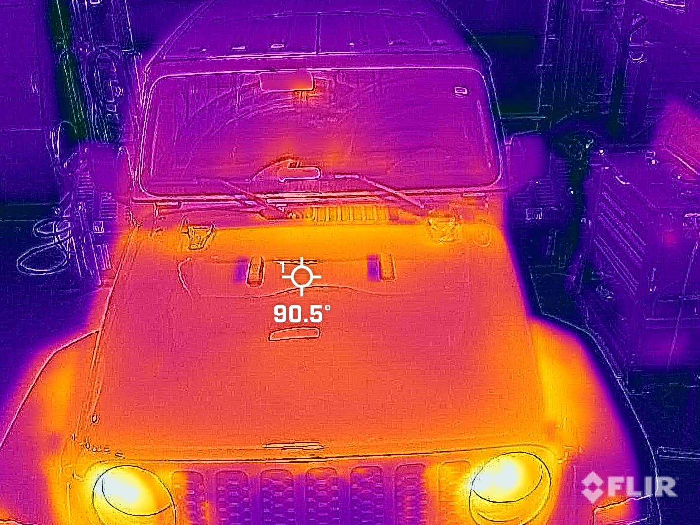

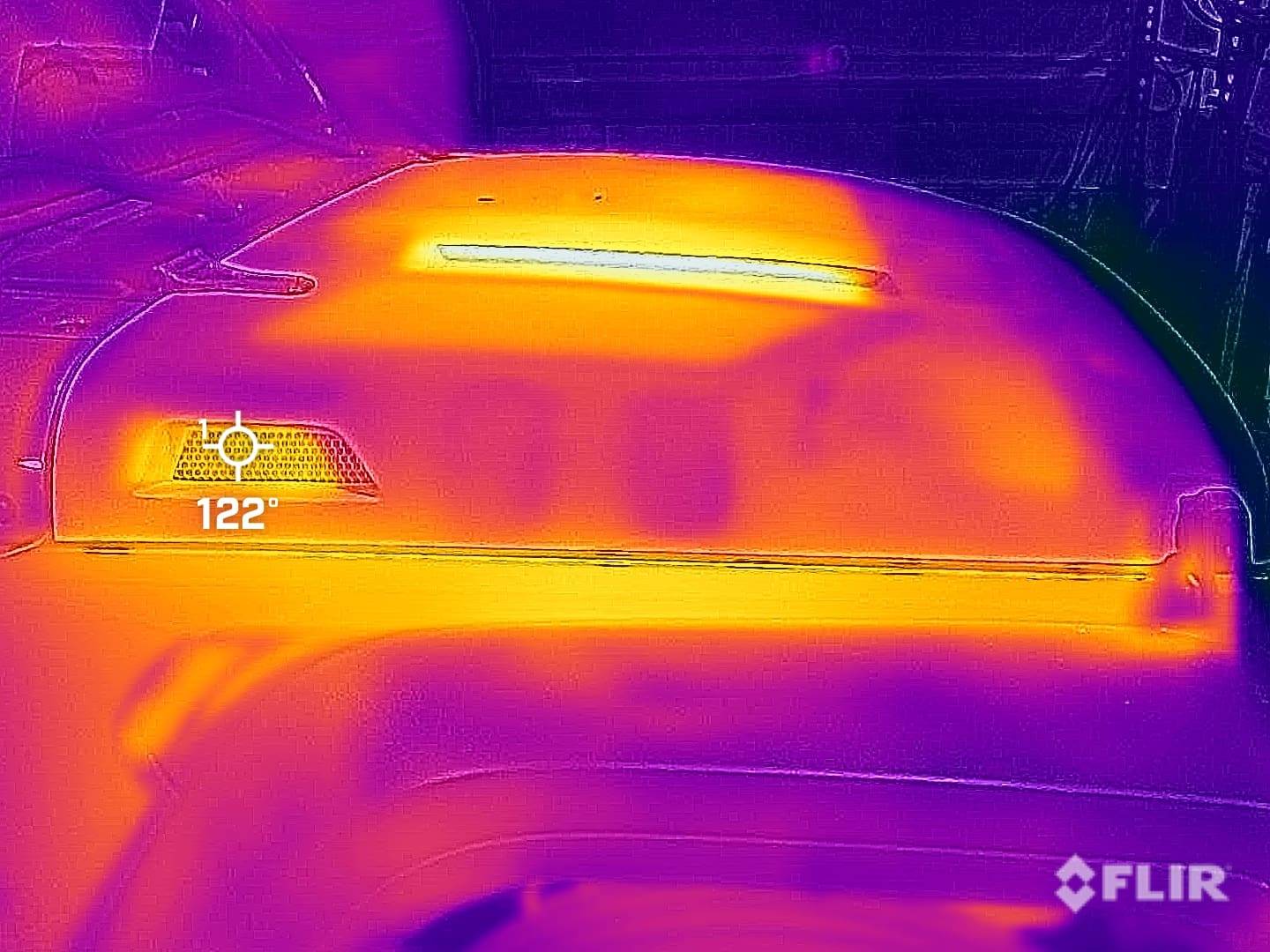

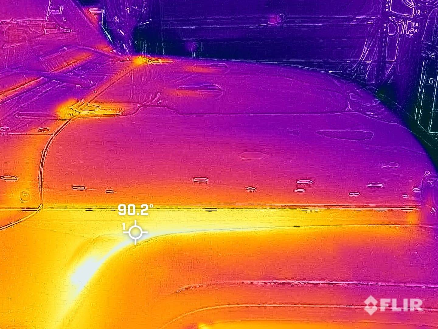

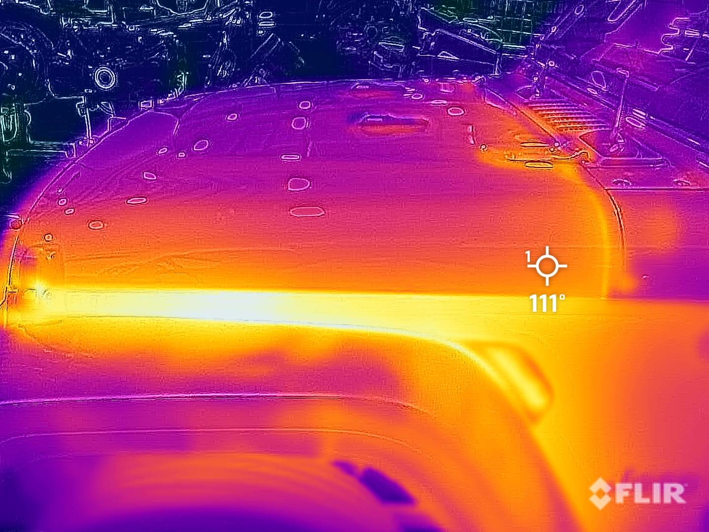

Below are the thermal images taken during this test. It gives you a pretty good idea of how much heat is escaping from the vents on our H.E.R.O. Hood.

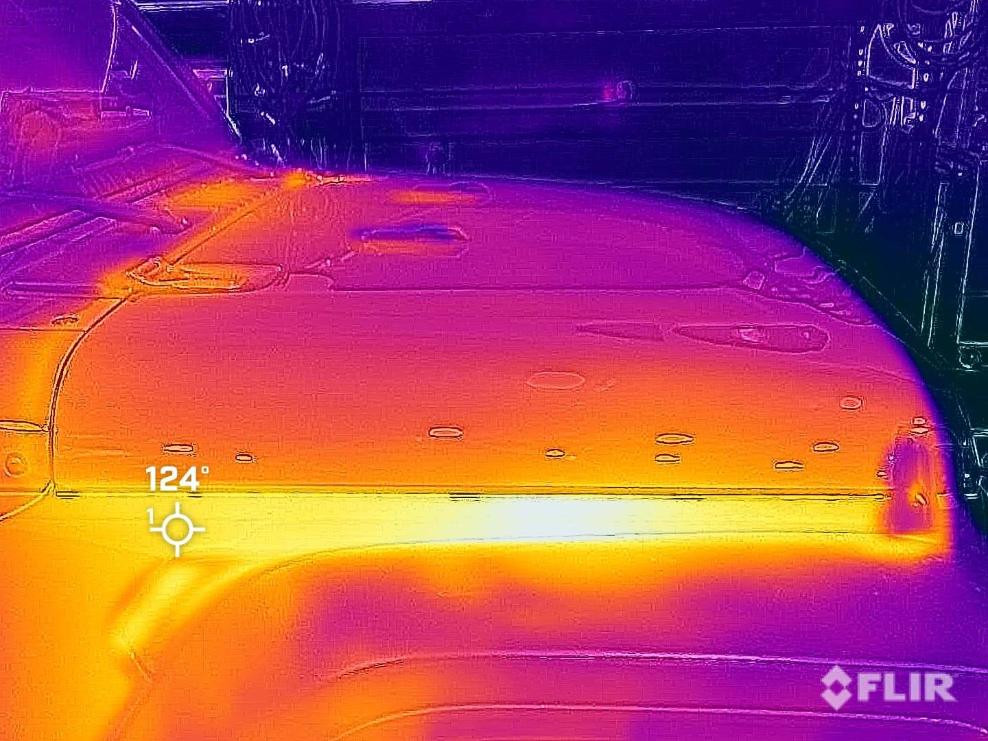

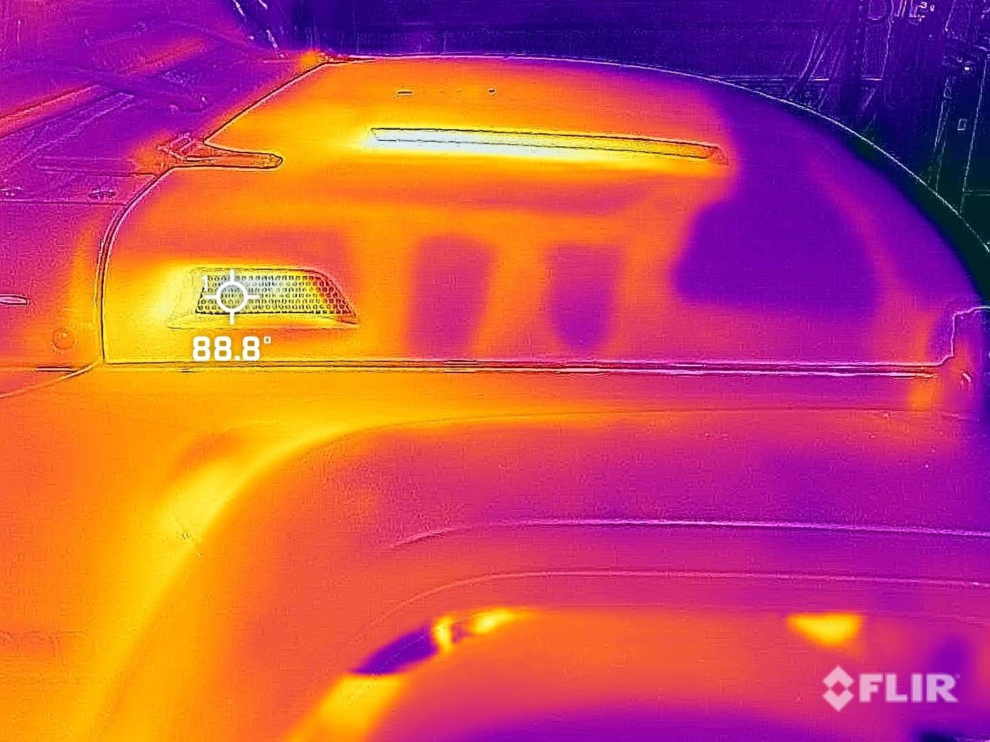

The thermal images from this test were very similar to the idle test but you can see that temperatures have increased.

If a picture is truly worth a thousand words, then of all the tests, I think the thermal images from this last test tell the most. In particular, you can actually see the cold ram air in action represented by the blue section going from the air scoop directly to the factory air box pre chamber. How cool (pun intended) is that?
