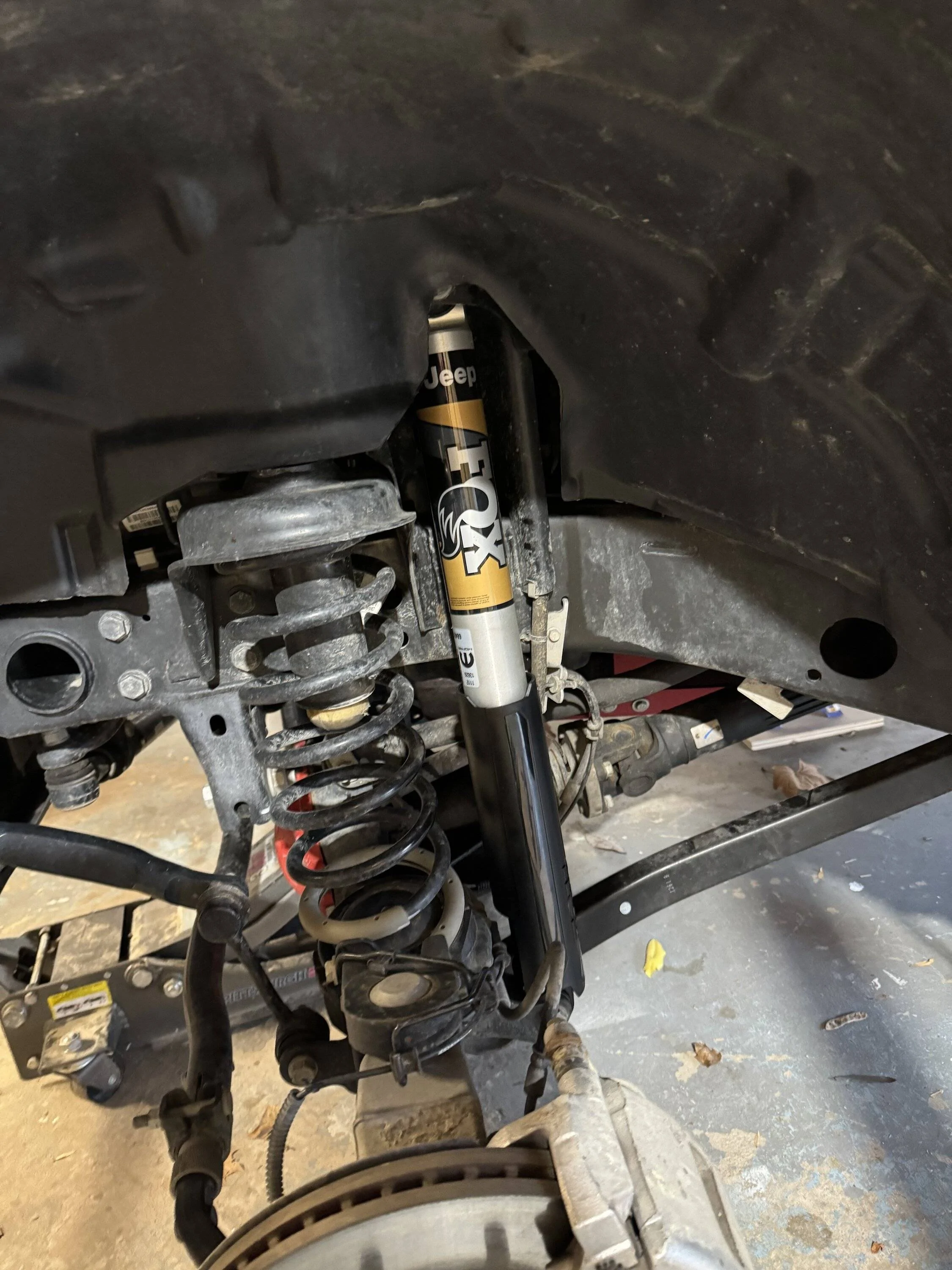

A stock 392 comes from the factory weighing in at6,100 5,100 lbs and my diesel rubicon came in at ~5,800 ~5,000 lbs (I keep seeing different answers on this weight) so I think it's a pretty even swap between the two. The install was straight forward, and everything fits perfectly.

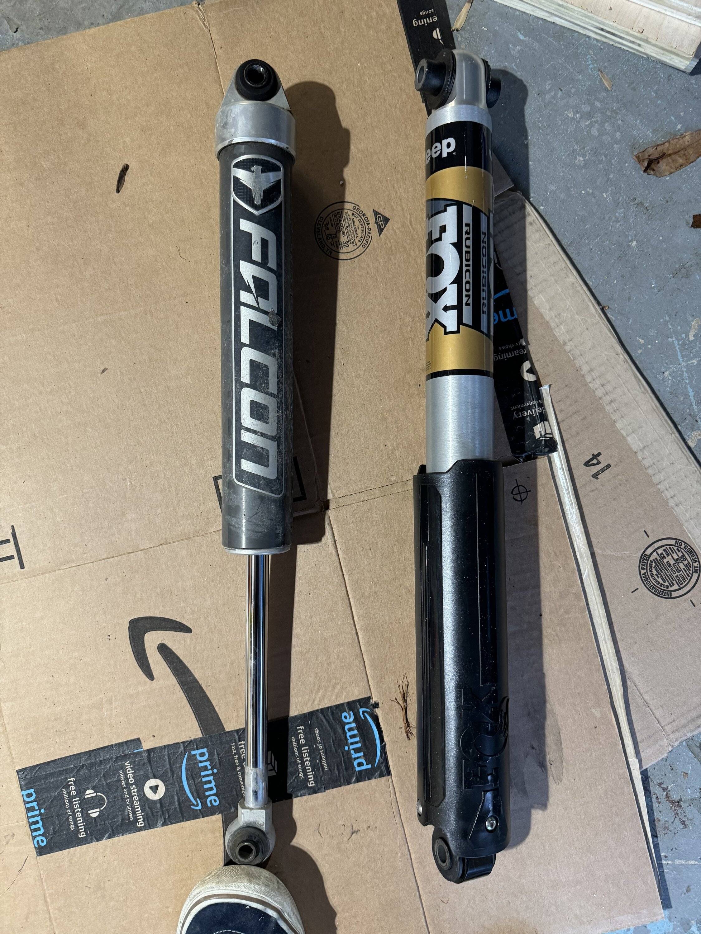

The 392 shocks are the exact same length as the Falcons and maybe 1/8" smaller in diameter of the shock tube, but it's very close. For reference the Falcons are about 1/2" longer than the stock red shocks that came on my Rubicon. One of the only differences is that the Falcons are offset at the top to push the shock valve away from the frame to fit their wider diameter (mostly at the top of the shock where it mounts). The Teraflex shocks do not have a shield on the fronts, but they do have one on the rears.
My initial impressions so far are that I actually like them more than the Teraflex set! The Falcons were very stiff which was great for 'spirited driving,' but weren't ideal for comfort and could be a little harsh. The Fox shocks feel softer and are valved a little better for a diesel. It's not a massive difference or anything, but for on road driving I prefer Fox. I'm interested to see how they perform off-road. I would highly recommend scooping a set of these up; lots of 392 owners scrap them when installing a lift, so they're a bargain for what you're getting.
