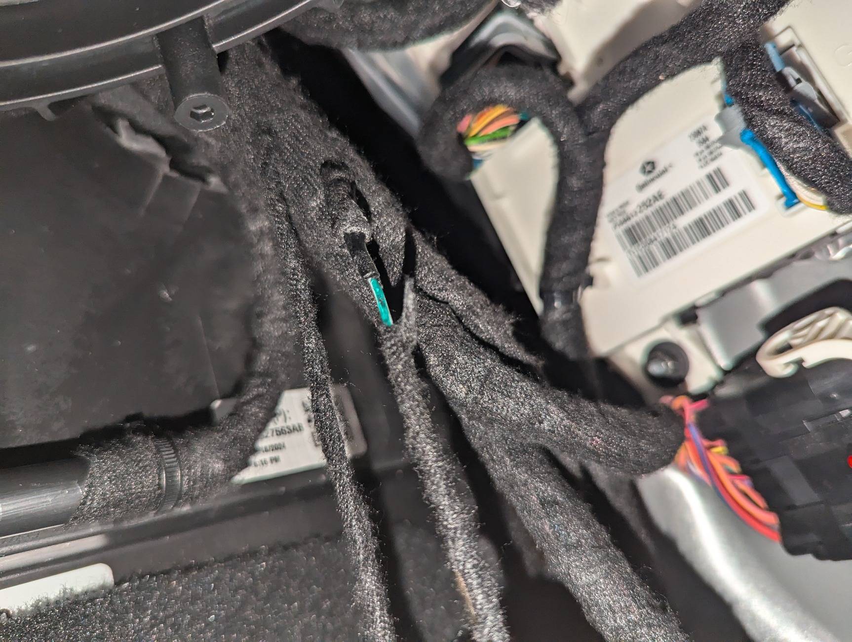

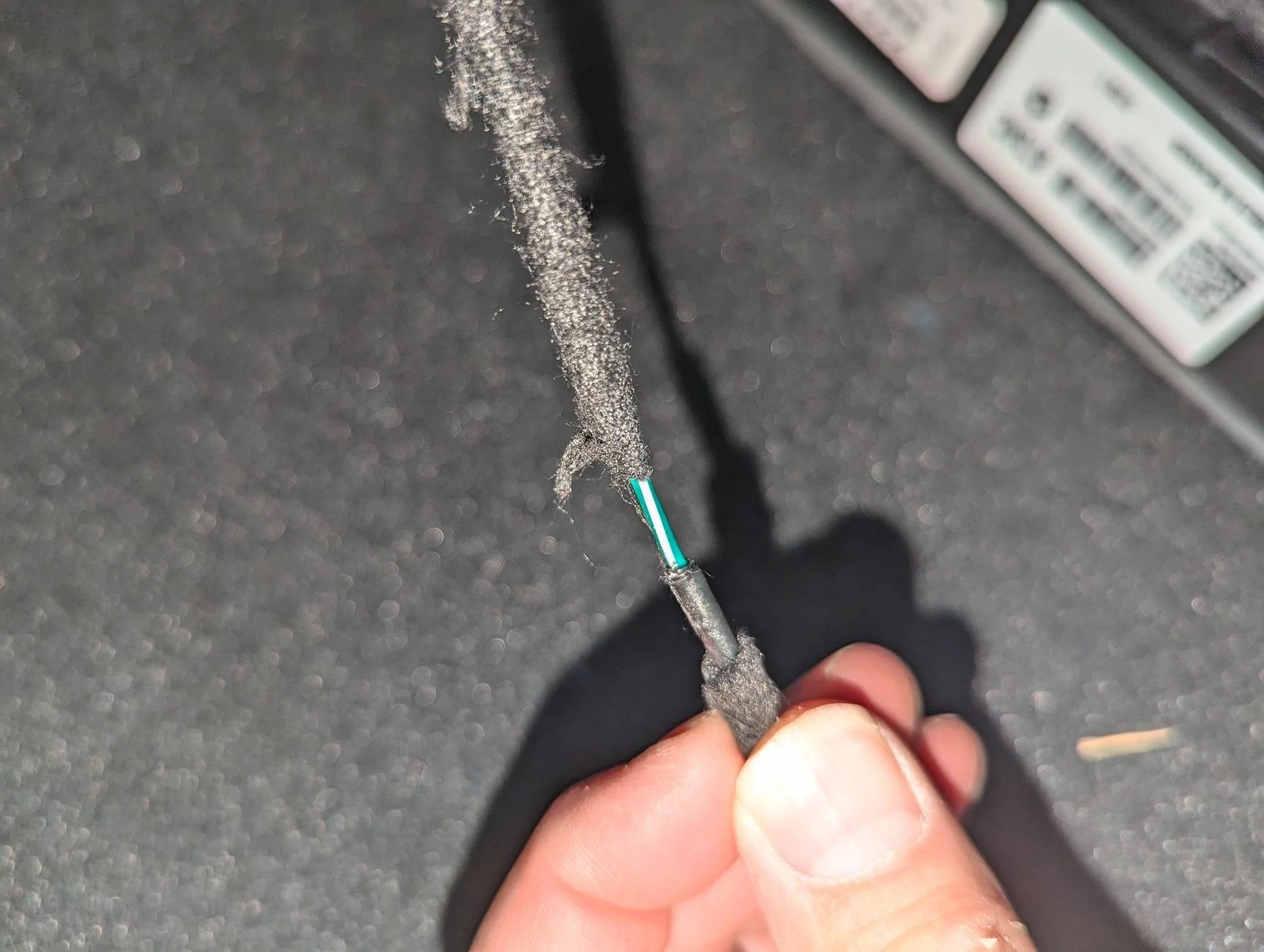

So, I went digging for interior leads(passenger footwell). I have a 2024 Willys with factory aux switches. I found 1 lead, green/wht. Can't find anything else that's not plugged in. Anyone dig into a 2024 and find all 4 leads?
Pics below:

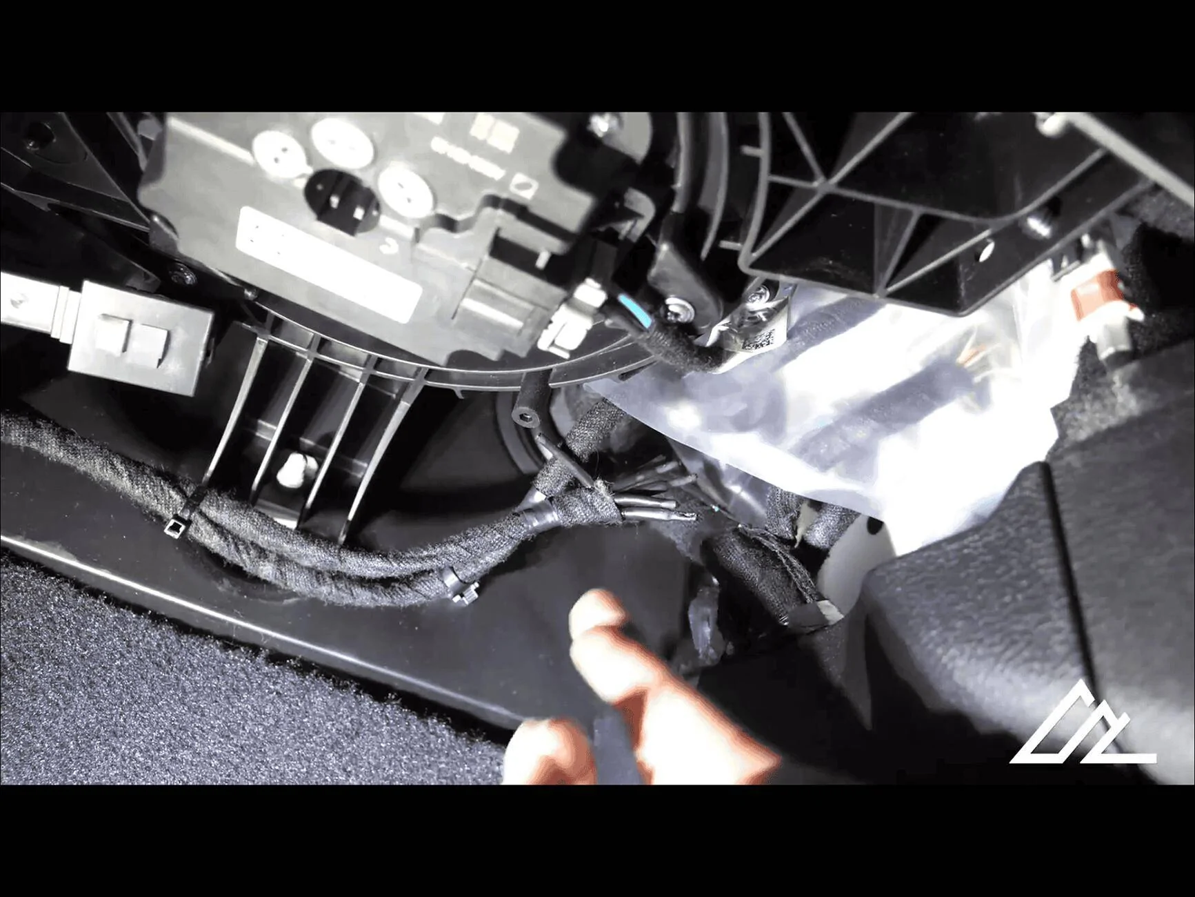

i have a 2023. I don’t know if anything has changed? You’re looking for a bundle of 6 wires (aux 1-4, battery + and ignition+) wrapped in Tesa tape with black heat shrink on the end of each wire. The picture below shows that bundle. But mine were folded over and Tesa taped to another wire harness. Not so obvious

That green wire with the white stripe is the brake signal wire for an aftermarket trailer brake controller.
