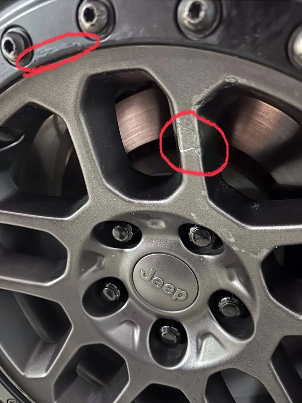

Chipped a couple of my XR wheels. Need some touch up paint, but cant find any.
Can anyone help with a paint match or paint code?
The dark wheels, or the bronze? And, the wheel, or the trim ring?

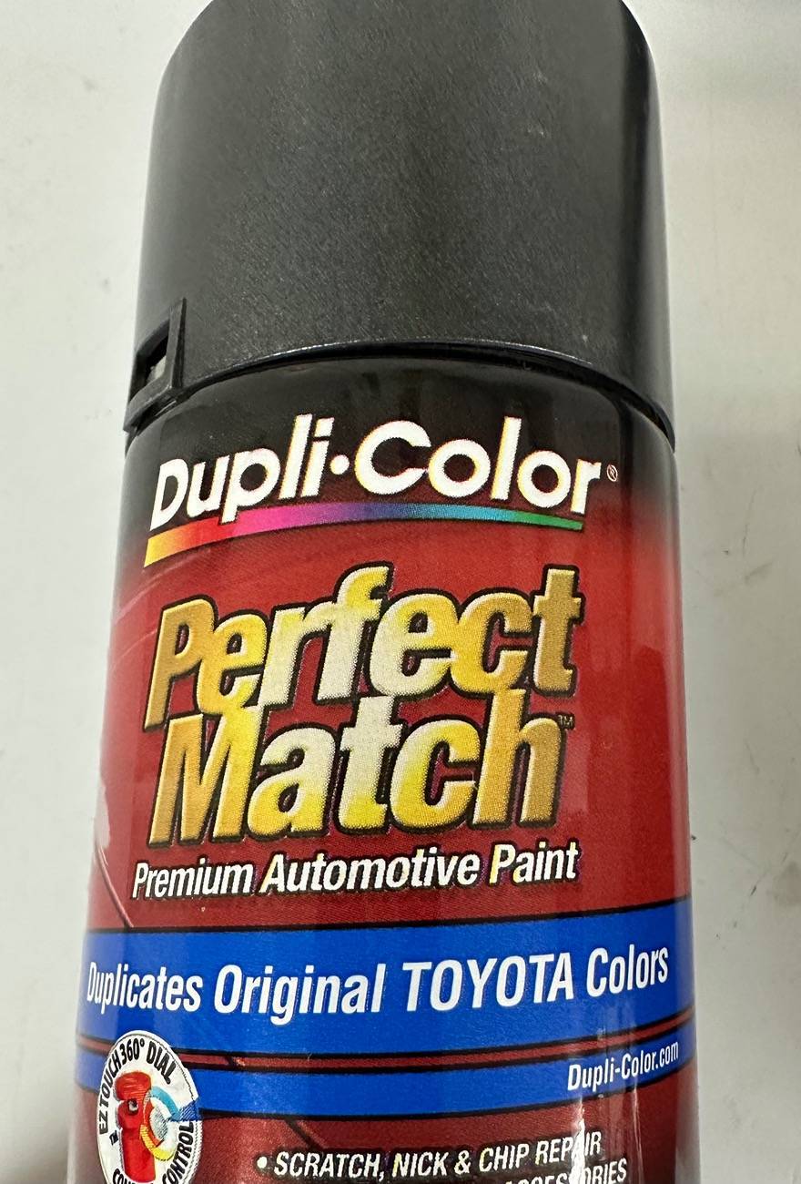

@Terrymo didn't you use some kind of Toyota paint for your dark wheels? I can't find the thread now.
Terrymo
Terry
Jun 17, 2022
10,745
33,200
2023 JLURXR 3.6 ET

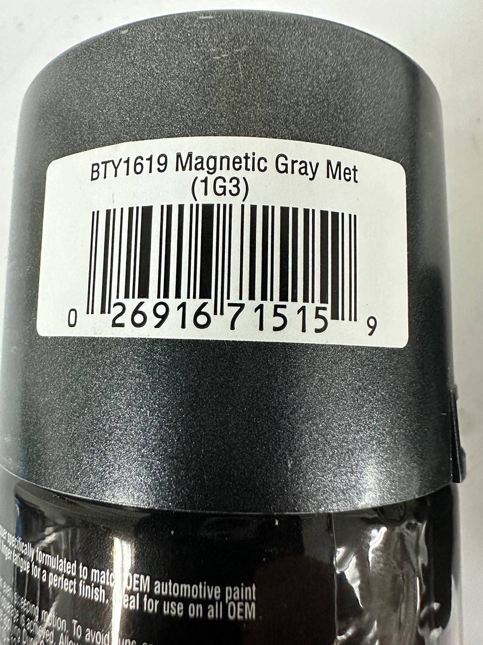

Rustoleum Satin Black artistically applied on the trim ring gouges with a Q-tip after each trail run…hey don’t judge me. And the Toyota grey touch up after I slid sideways off of a large rock and had a close and unexpected encounter with another large rock.
