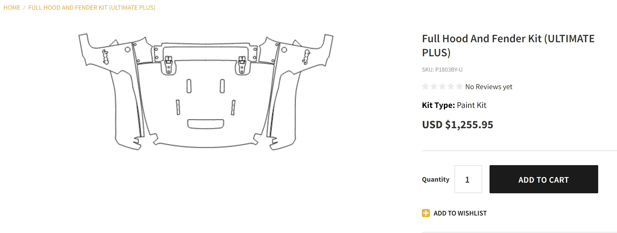

The pattern in your pic is exactly what I was hoping to receive in the first place (maybe with the edge of the film being a bit closer to the hinge). I'll go back to these ass clowns in a few weeks (waiting to see if a few little bubbles disappear) and I will ask them to redo it. Your pic is a custom cut, right?

No this is a pattern cut
Sorry if this sounds stupid., but by "pattern" you mean someone typing the make/model/year of the car into some software and then using a cutting machine to "Print" patterns (i.e. individual pieces), correct? I.e. no manual cutting of any kind.
What film is in your pic? I am asking because the guy actually showed me Xpel's software on his laptop and I could clearly see huge holes around the hinge area. Same thing is shown on their web site:

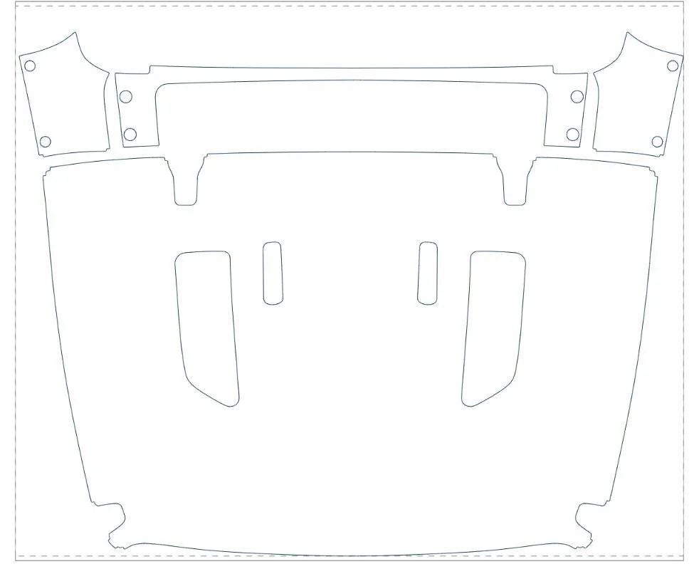

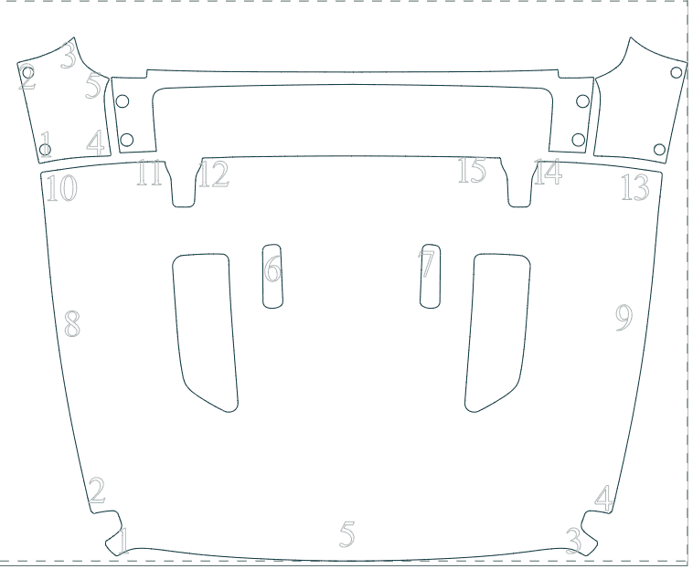

That's correct. There are two main software programs used for PPF right now, DAP (Xpel) and CORE (owned by Eastman), with other small ones but these are the big two. This is STEK film, cut with CORE software. This is how our patterns look in core for the 392 (1st photo) which is much larger around the hinges than the standard Rubicon (2nd photo). If this were me installing it, I would use the hinge section from the standard and blow out the edges so that the only piece I had to line up was the hinges, and hand cut the edges. The cowl would get hand cut and the windshield bumpers would be removed.

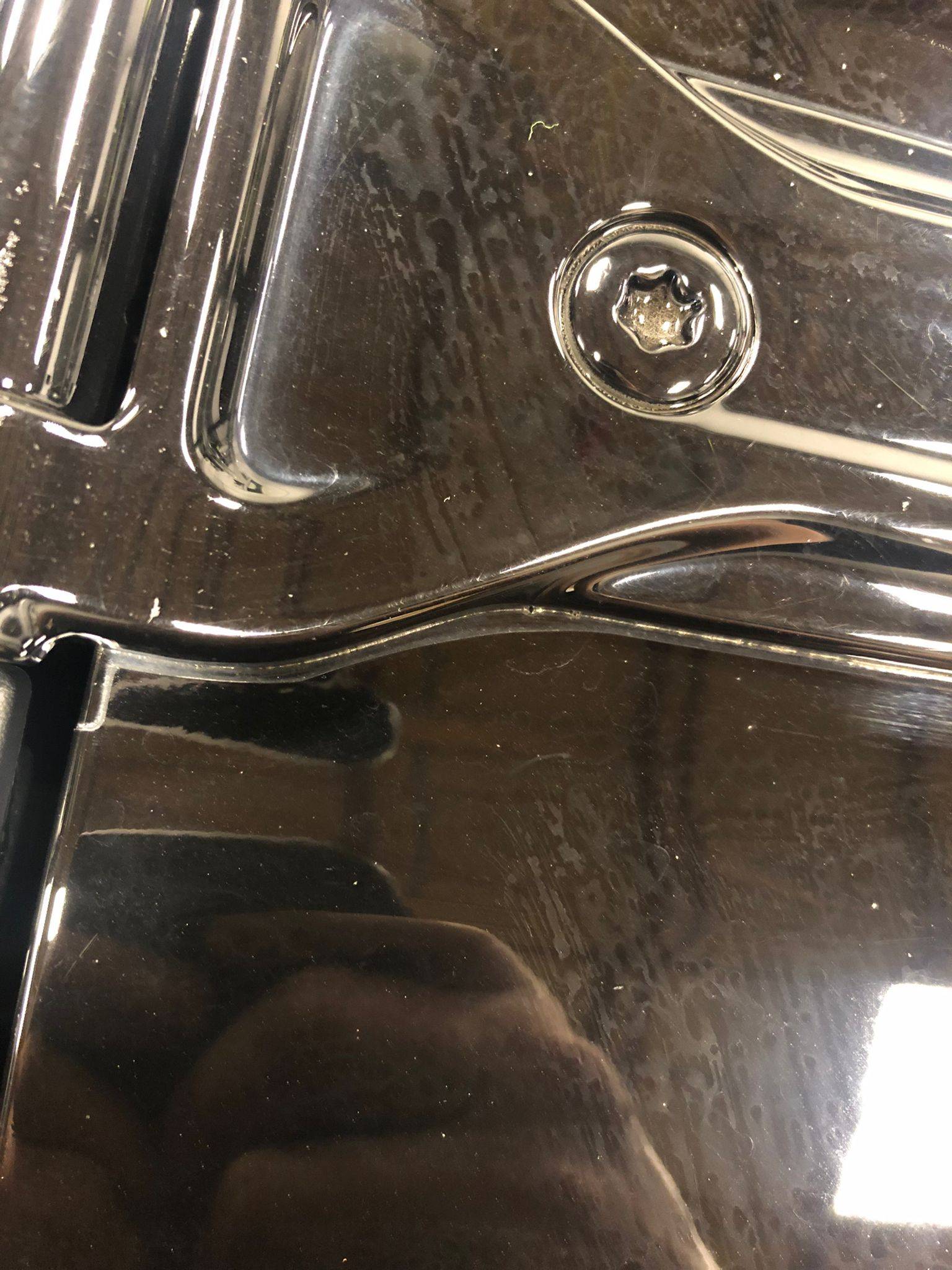

I did my own PPF since i do it for a living. It is possible to cover closer to the edges.
Jeep Wrangler JL Xpel ultimate  - hood hinges 969ac453-972a-49c6-aca5-d16df9bce4d1
Jeep Wrangler JL Xpel ultimate  - hood hinges 75d0e590-a0a7-4ea4-b2e8-ac9ca76fd607
Sorry for the dirty images. Jeep is dirty and i just went into my garage to snap it real quick.
This is the first JL I did in 2018. I just snapped a quick photo for you to see. It was precut on core software using Llumar platinum paint protection.

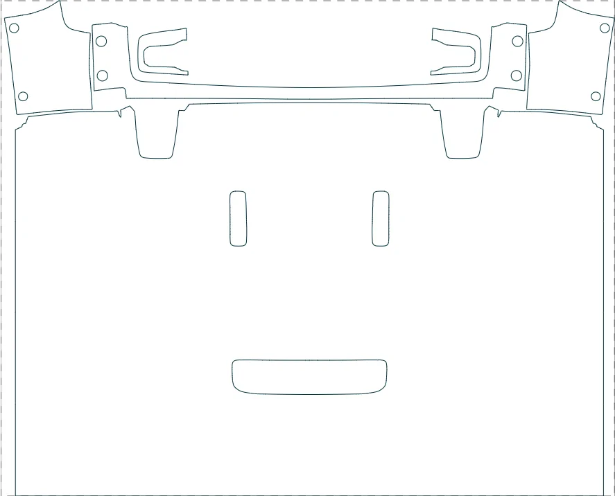

This is my pattern i used. As you can see it doesn't cover 100% but its close enough. unfortunately it looks like xpel pattern doesn't cover all the way in. Which also surprises me since its supposed to be one of the best.
You beat me to it LOL I just screenshot my own core software.
Jdub is correct. with a little extra time the installer could have extended out the hinge areas using xpels software.
I'll be honest. At times when I cut film out for customers that have special requests. It makes our job sometimes more difficult.
Sometimes we dont know how well it fits or where the film ends. Its hard to estimate howmuch we need to extend it at times. We just cut out what we are given from the manufacturer and the customer gets what they get.
The only time I would redo something is if the precut is extremely bad with poor fitment. what you have i would consider industry standard for 95% of North america.

Can you please take a pic from a distance of like a foot? Something that shows the entire hinge with film coming close to it. The guy kept telling me that what you have in your pic is "impossible to do without removing the hood hinges" (direct quote) and I kept telling him he does NOT need to remove the hinges because film goes AROUND them.
