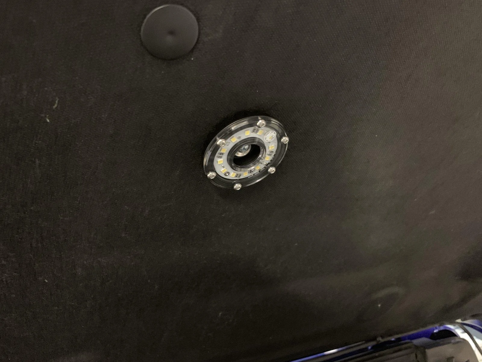

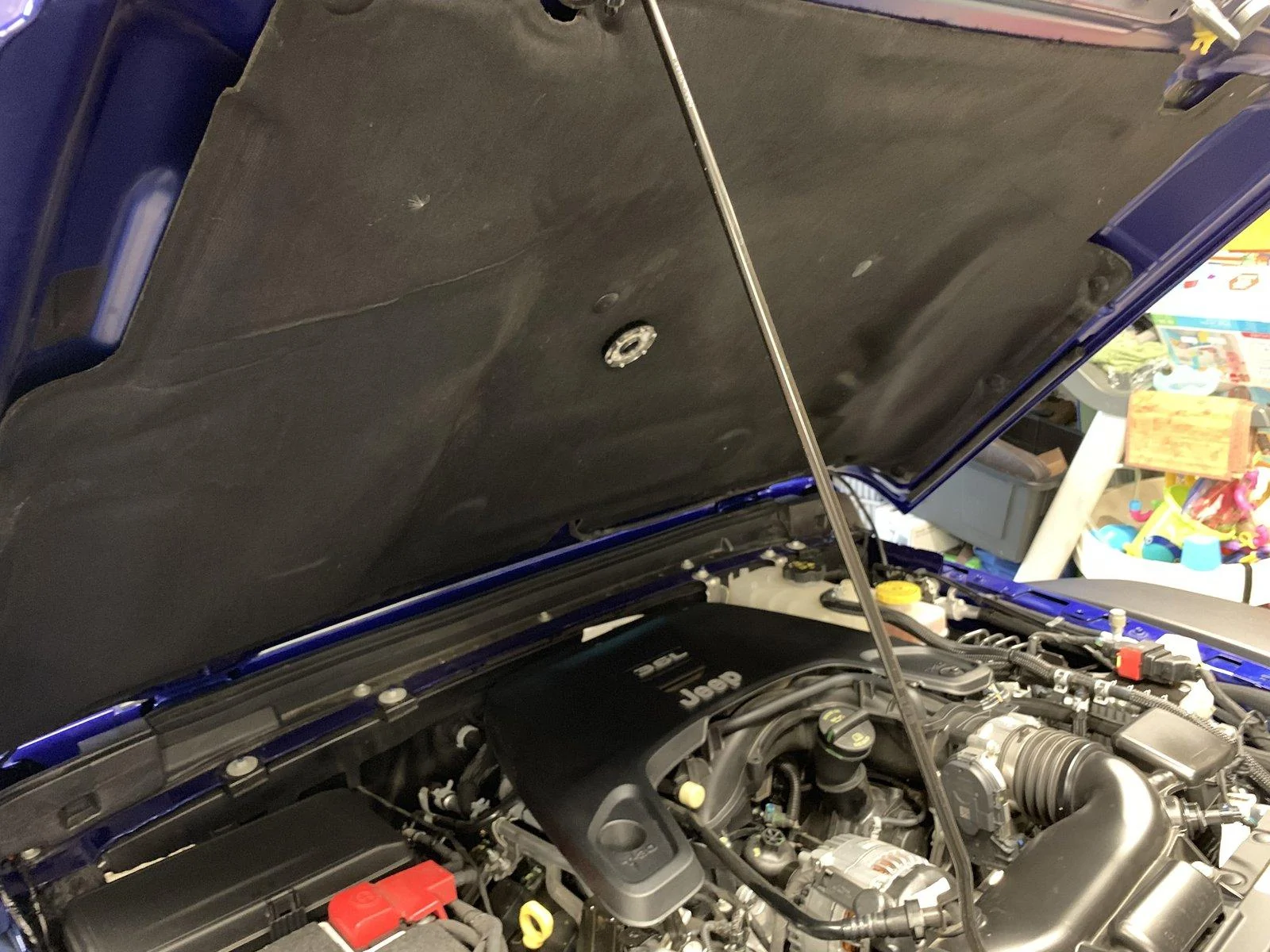

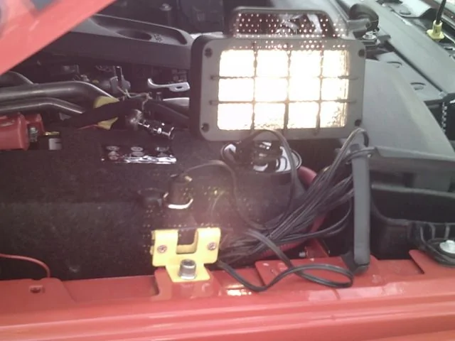

This is cool! Any details on how/where your routes the wire?Buy a KC Hilites Cyclone light. I wired the light to one of my factory Aux switches. Works like a champ!
I removed the hood liner clips and dropped the hood liner down. Then I found a good location on a under hood brace to mount it to. I marked where I wanted the light to go then measured from that location to the nearest hood clip hole for reference. Then reinstalled the hood liner using the two center most clips. I then translated my measurements I took to the under hood liner and drilled a small pilot hole through the liner and brace for the sheet metal screw to go. (Be careful not to let the drill bit pop through the hole you just drilled potentially hitting the under side of the hood itself) I then dropped the hood liner down once again and fished the wires through. Next I taped the wires down in a few locations to the underside of the hood liner to keep it routed in the direction I wanted towards the left lower hood corner nearest the battery. Then I reinstalled the hood liner securing it with all of the clips and screwed the light in using a washer and short sheet metal screw. Then wired it to a 15 Amp factory Aux switch located off to the side of the battery. And that's it, pretty straight forward.This is cool! Any details on how/where your routes the wire?

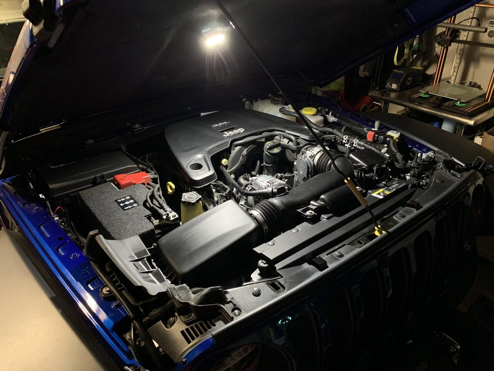

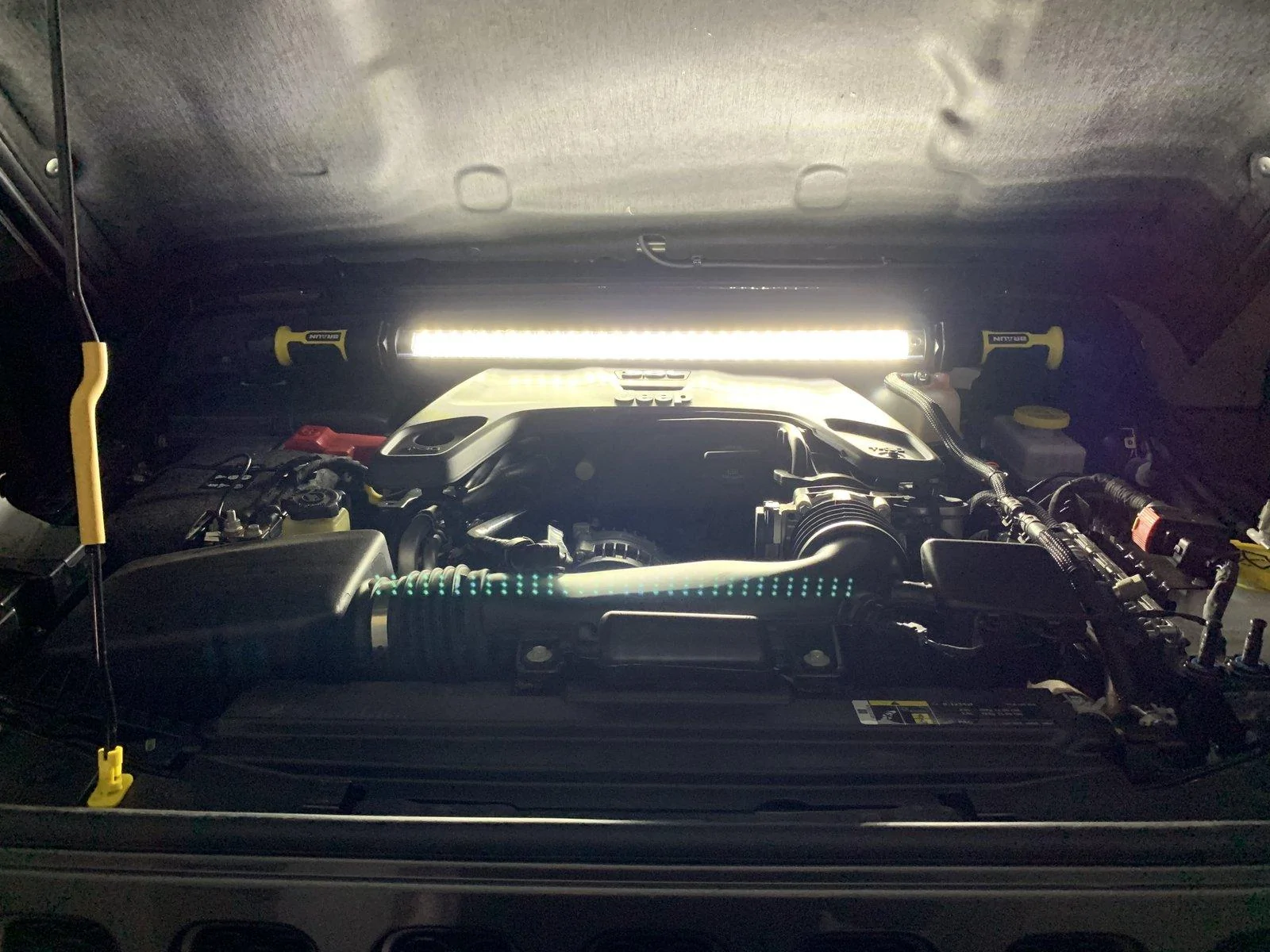

OK, I ran out and bought the big one for $32 (25% off sale price was slightly cheaper than the $34.99 coupon). It’s not as good as the small one that I originally linked. For its size, it isn’t as bright as the small one. Also, the battery isn’t removable. Not bad for $32, but just FYI.Serendipity. This just arrived to my inbox: https://www.harborfreight.com/845-lumen-underhood-rechargeable-work-light-63990.html
$34.99 with coupon. Not sure if you can combine with 25% off? I’m going to try...
Also like that it uses a standard 3.7v rechargeable battery. I have several lights that use them and an independent charger, so swapping batteries when the light dies is simple. The big light requires that you plug it in to charge, which I don’t like. I think it’ll be a cool camping light, through. It has hooks on both ends for hanging, and the caps unscrew to reveal bungee attachments so you can stretch the hooks as needed.I have a couple of the HF lights... I like the 90-degree flex & if I ever had the need to do some midnight wrenchin' one alone lights up under the hood & beyond.

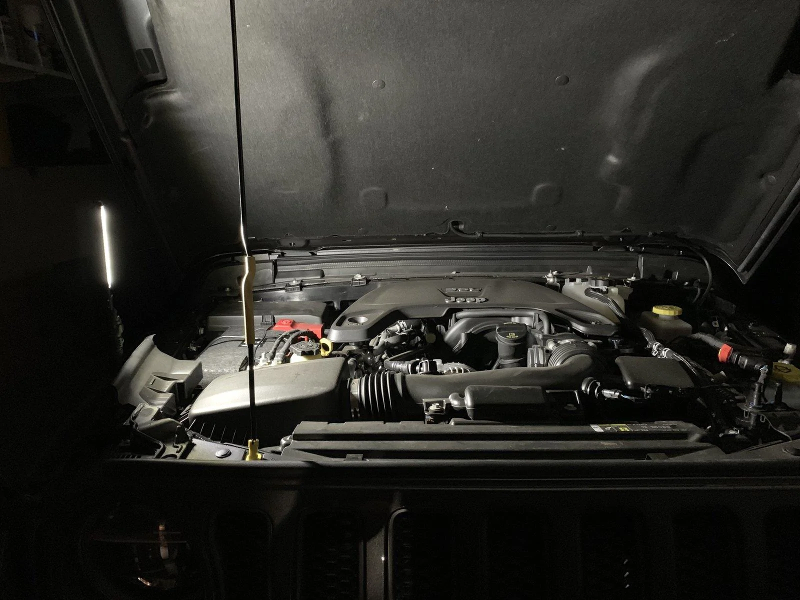

real simple solution: and I only say that because if I can figure it out, I'm sure you can too:Clearly, the JL is my first Jeep. And maybe it’s common knowledge among previous Jeepers. But honestly, I was shocked to open my hood only to learn there was no illumination whatsoever in the engine compartment!
I’m even more surprised that I can’t find a single thread anywhere on the forum discussing this situation and what people have done to remedy it. Surely I’m just not working the search function properly. Can anyone help me out here?
I have found one kit over @extremeterrain to add manually operated lights. But I can’t find any write ups or videos of any JL owners installing them:
https://www.extremeterrain.com/kc-hilites-cyclone-led-under-hood-lighting-kit-8717-yj-tj-jk.html
I don’t mind being the first, but I’m awfully nervous about that hood liner, which seems like it’s not going to play nice with removal and reinstallation.
