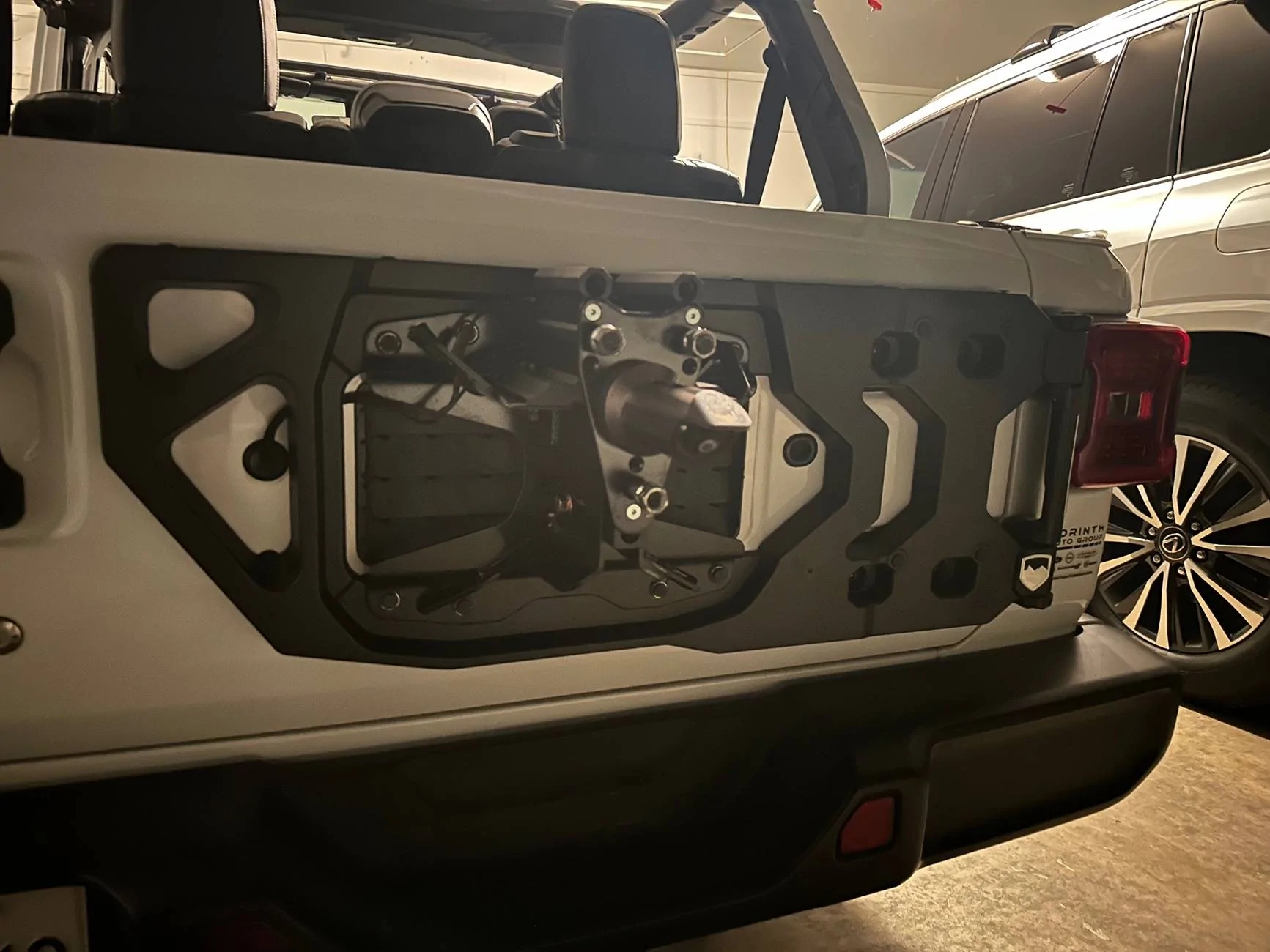

One of my favorite mods. Teraflex alpha HD tire carrier and tailgate reinforcement.
But for the size you have, you shouldn't have problems. I ran a 37 inch tire with just the alpha Hd carrier without the reinforcement for a year on a previous JLUR with no trouble.
