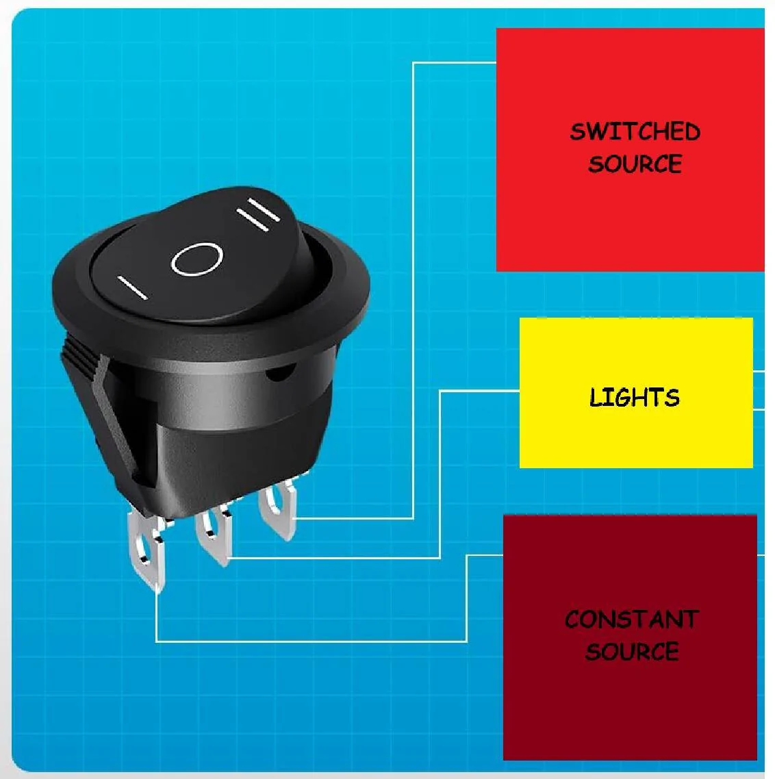

I'm attempting to incorporate an a/b or power source switch for one of my lighting accessories. The goal would be to switch between two power sources.... A: ignition B: constant, thus allowing me to either turn on the lights with the engine running or not without keeping the ignition in run mode.
I was looking at a standard three position rocker switch but they appear to only be one source in, two leads out, whereas I'm looking for two sources in, one lead out.

Wire that switch backwards from what you are thinking. Inputs as the two outputs. Output as the input. Relay between the switch and the light.

Being a bit of a novice, could you maybe clarify that??

Looks like it.

I have my light bar wired up sort of like that, with a double throw center off switch, with up for ignition and down for on with the high beams. The switch powers a relay that powers the light. I used a 2 wire cable through the firewall, one to send the output to the relay, and one that is tapped into the high beam positive. I got the ignition hot from the accessory switch harness that is under the passenger side dash.
I live in a rural area, with the nearest street light 5 miles away, so it is nice to be able to use the light bar but be able to turn if off very quickly.
I also wired the rear bumper LED lights similarly, with up for battery and down for on with the reverse lights.
