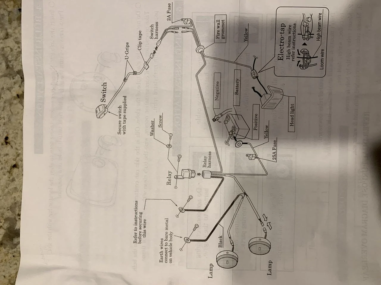

I am trying to install IPF 900 Series driving lights using the JL auxiliary switches from factory but not sure how to bypass the OEM switch as noted on the diagram
Jeep Wrangler JL JL aux switch wiring {filename}
Assitance would be greatly appreciate, looked everywhere on the internet without succes, I would like to just use the auxiliary switch and not use the high beam option either. Thank you

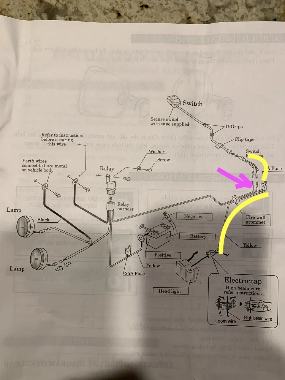

@JFox97 just looking at that wiring diagram, and you saying that you don't want it to be tied to the high beam, I would say that the Yellow wire, with the 2A fuse is not necessary.
This means that you should be able to wire into the harness where I put the pink arrow. The diagram looks like the switch harness is in two pieces, one that brings in the Yellowfins High Beam wire, and then a second piece after that to the supplied switch.
I think that if you do with out those, you should be left with a positive and a negative, that you can tie into the Aux switches.

Will,
thank you for the response and great input this makes sense on how to bypass the switch, after thinking about this using that though then do I still need to go through the OEM relay with the power coming from the Jeep auxiliary switch Since the relay is receiving power directly from the battery. I have tried to do some more research but for IBF lights there is not much information but understanding a light circuit should be the same regardless of the manufacture. since the auxiliary switches are fused and have a built in relay circuit should there be an aftermarket harness out there to take advantage of this scenario ?
