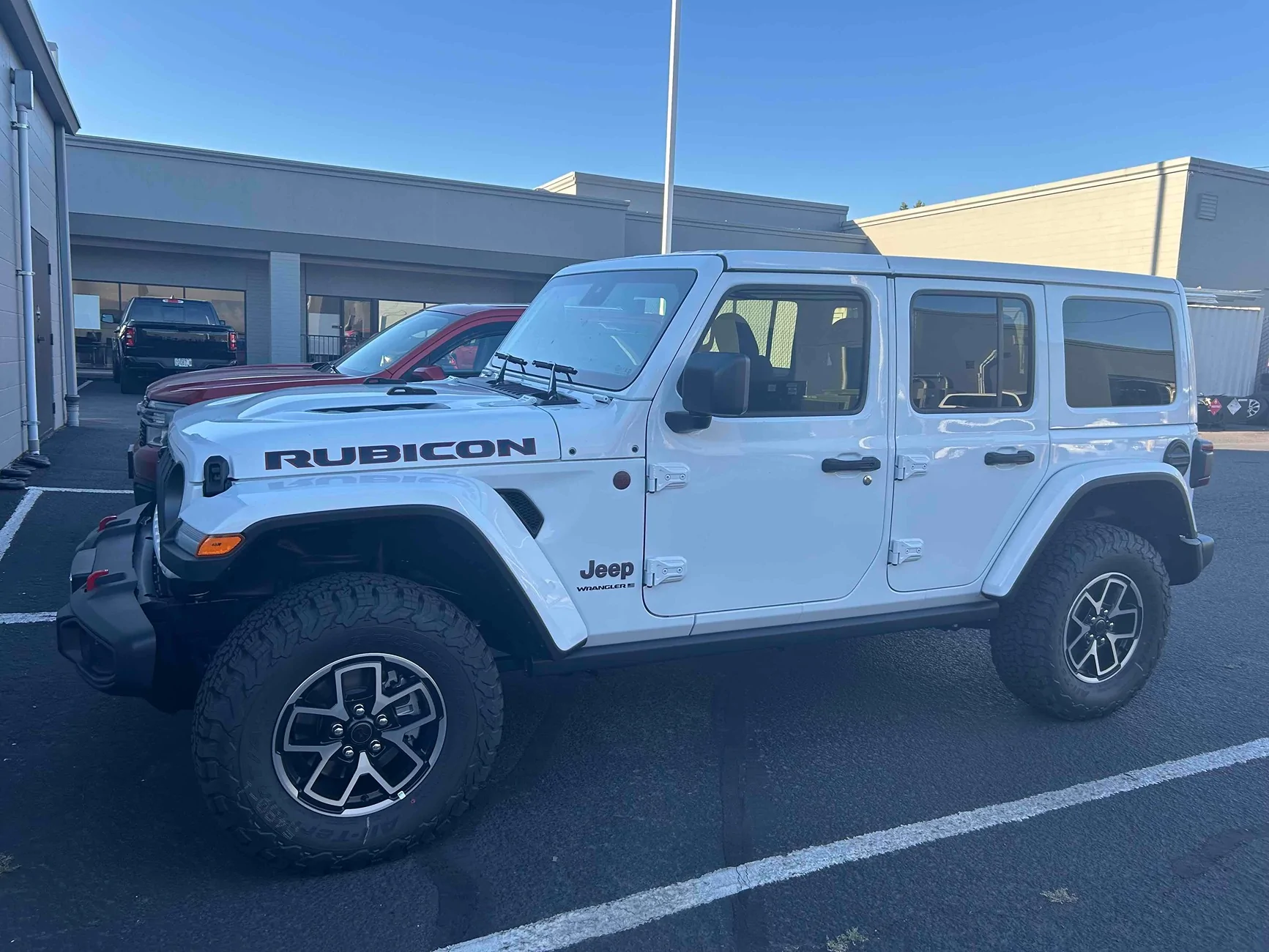

Really high pitched noise coming through passenger door, 2025 rubicon 4dr less than 2000 miles. Jeep cares say it’s normal, not. Have test drove other 2025s and they are quiet compared to this one. Dealer has changed door gaskets and hands tied. Added some temp gasket materials between door and pillar has help. Wondering if any good aftermarket fix

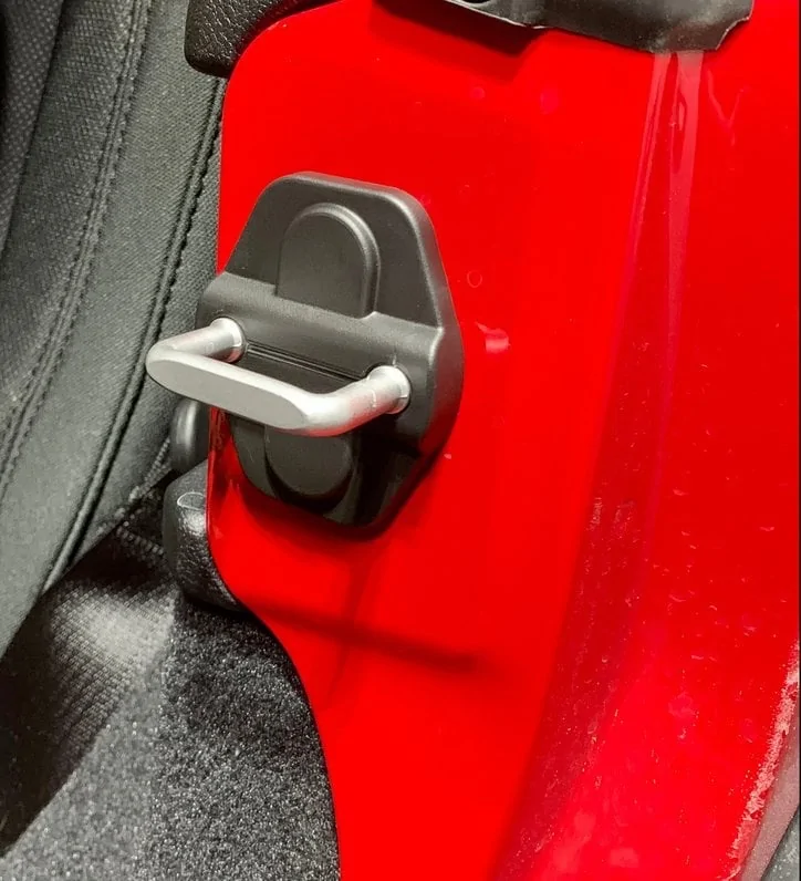

Had the same issue along with water dripping in durring light rain when driving. The leak was the t shaped gasket between doors and hard top. (Top of b Pilar. The wind noise was solved by just moving the striker in about 1-2 mm. Manual says rear of door should be flush IIRC. Firmly believe is should be just under flush. All my other JLs were and never had much of any wind noise unless I was on the freeway pretending it was a race car 😂

I have same problem . I know the t shaped gasket your refer to but what is a striker?
It's what you door holds on to when it's closed.
The striker is the u shaped piece where the door closes, if you ever used tube doors, then you would know exactly where it is.
