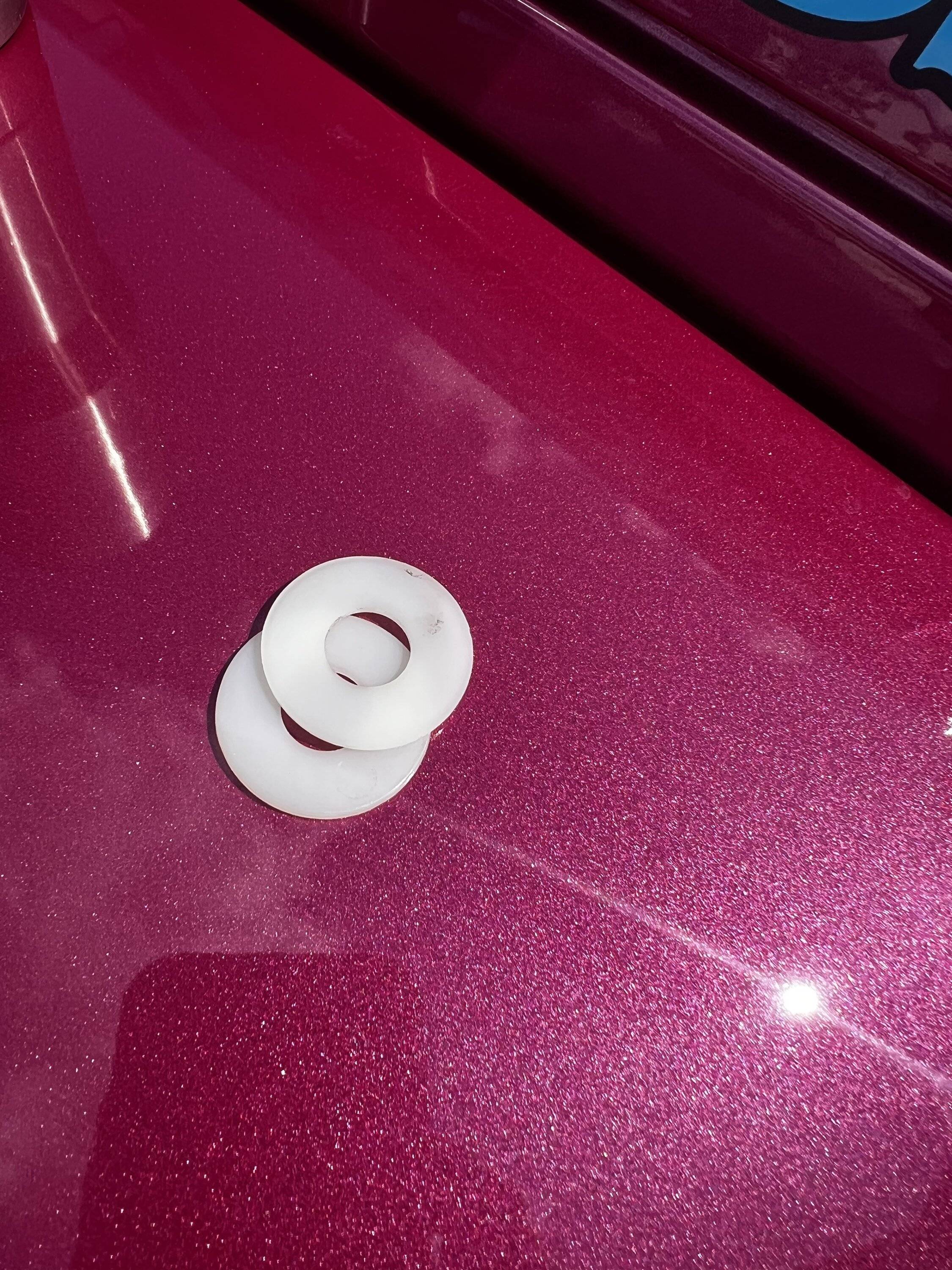

Works great, driver side goes in the 2nd hole and it’s nice and tight. Passenger side is too long for long hole and can’t get to short one. Added an extra nylon washer inside and out and everything snugs up with no rattle.
