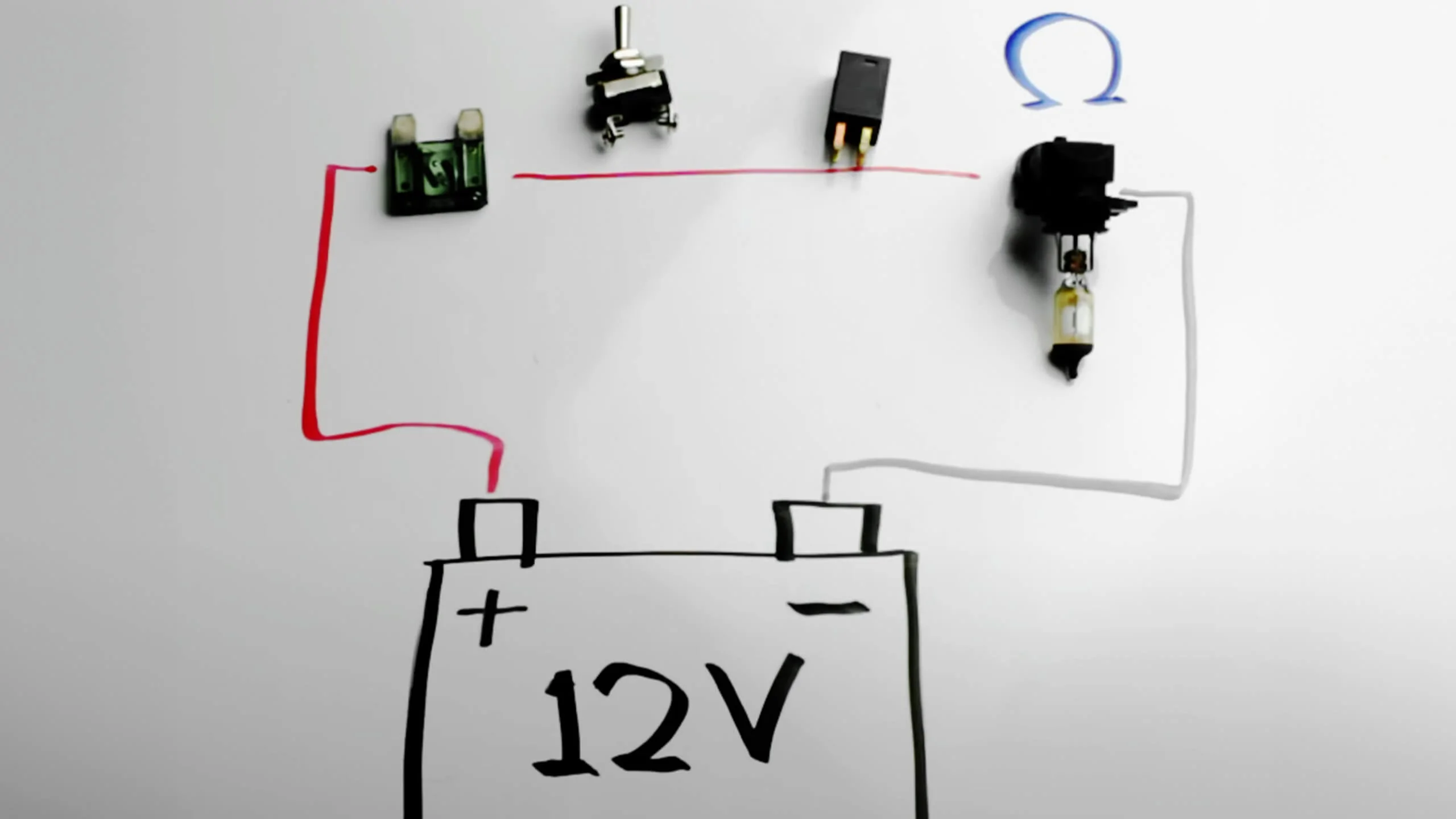

Before we delve into the potential causes of a malfunctioning headlight, it is important to have a basic understanding to headlight systems operation. So that we can understand why those reasons may be the culprit of a headlight not working.
How do headlights work?
Most vehicles have a relatively simple design for their headlight working system, of course, some modern vehicles will have adaptive headlights or a design where the headlights share the same bulb as the daytime running lights. But it basically involves a car battery, fuses, a light switch, relays and bulbs. When the headlight control switch is activated on the car signal lever or panel, it triggers a relay that allows the flow of electricity from the battery to the headlights, enabling headlights working. During this process, the fuse will act as a supervisor and protect the normal circuitry, in the event of excessive current or a short circuit, the fuse will blow itself and stop the whole system working.

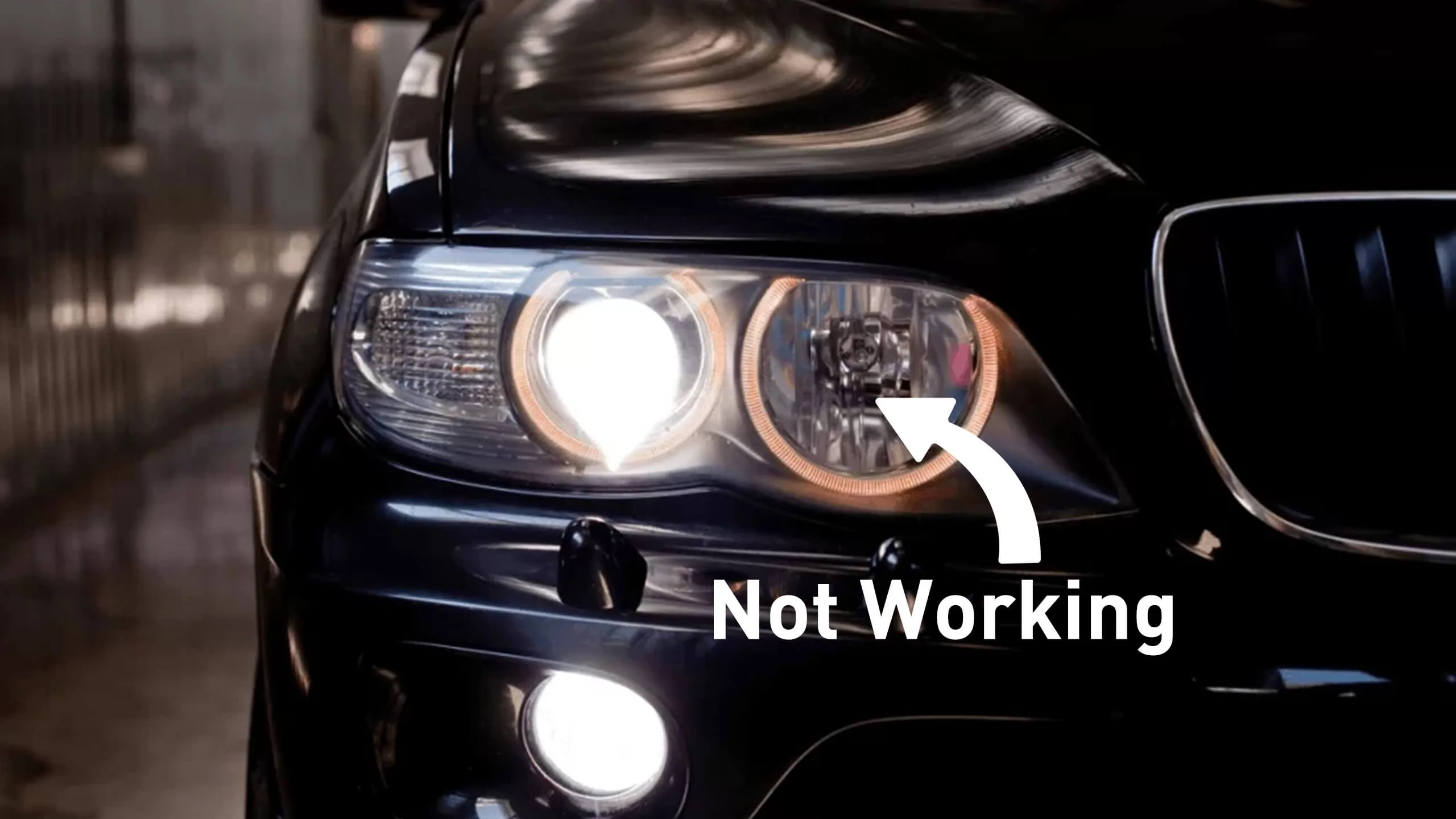

Therefore, there are the following possible causes of one headlight not working.
The causes and fixes of one headlight not working

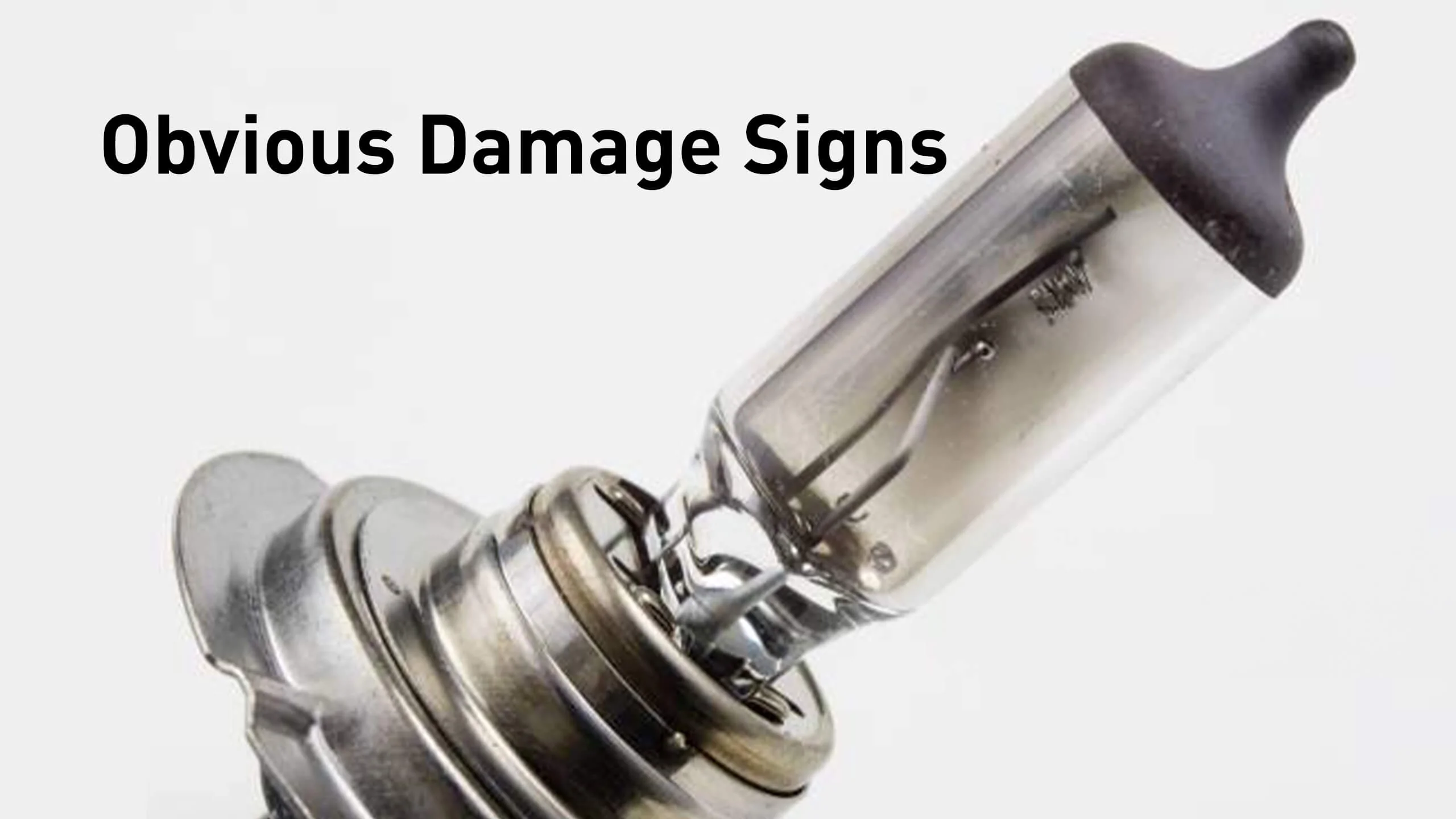

Burnt-out headlight bulb
Headlight bulbs are affected by various external factors during use. The filament may break due to the vibration of a car driving on an uneven road or the interaction between the temperature change of the weather and the heat emitted by the bulb when it is working. In severe cases, the glass outer tube of the bulb may even break, which may further cause the bulb to burn out. (At this point, the LED bulb burned out performance is the chip damage and affects the brightness of the light or directly does not light)
If it is not visible, find the installation location of the problem bulb, take out the light bulb and twist it slightly to check whether the light bulb is removable, and check whether the pin connection terminal is damaged or corroded.
Of course, you can also directly test the bulb with useful tools like multimeter or choose to find another good bulb of the same size and insert it into the bulb socket to verify whether it is a problem with the bulb.

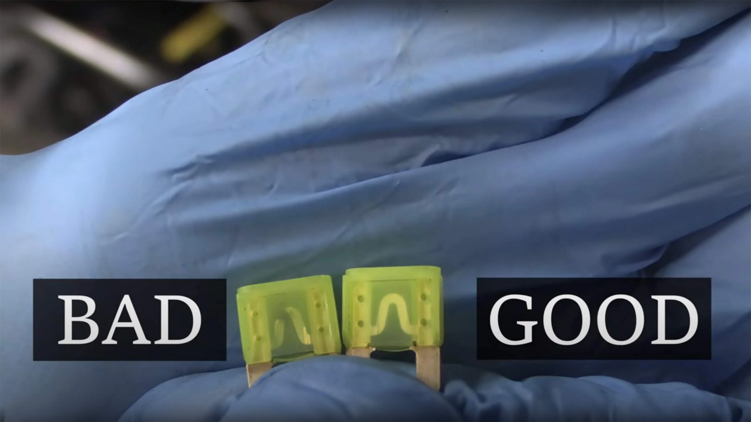

Blown Fuse
One of the most common electrical problems that cause a headlight to not work is a blown fuse. It is also one of the easiest to fix. Each headlight has separate fuses for the high beam and low beam. When a headlight bulb is energized and operates with more current than the fuse's allowable amperage, the fuse will interrupt the circuit connection by blowing, thus preventing a short circuit and damage to other related components. If either fuse blown, the light will go out.
However, it is also possible that the fuses themselves may have failed accidentally, for which it is sufficient to replace them.
Next, use a working test light to check the power to both sides of the fuse. If either side does not illuminate when tested by the test light, the fuse can be removed and the metal strip inside the fuse visually inspected for breakage or burned out.

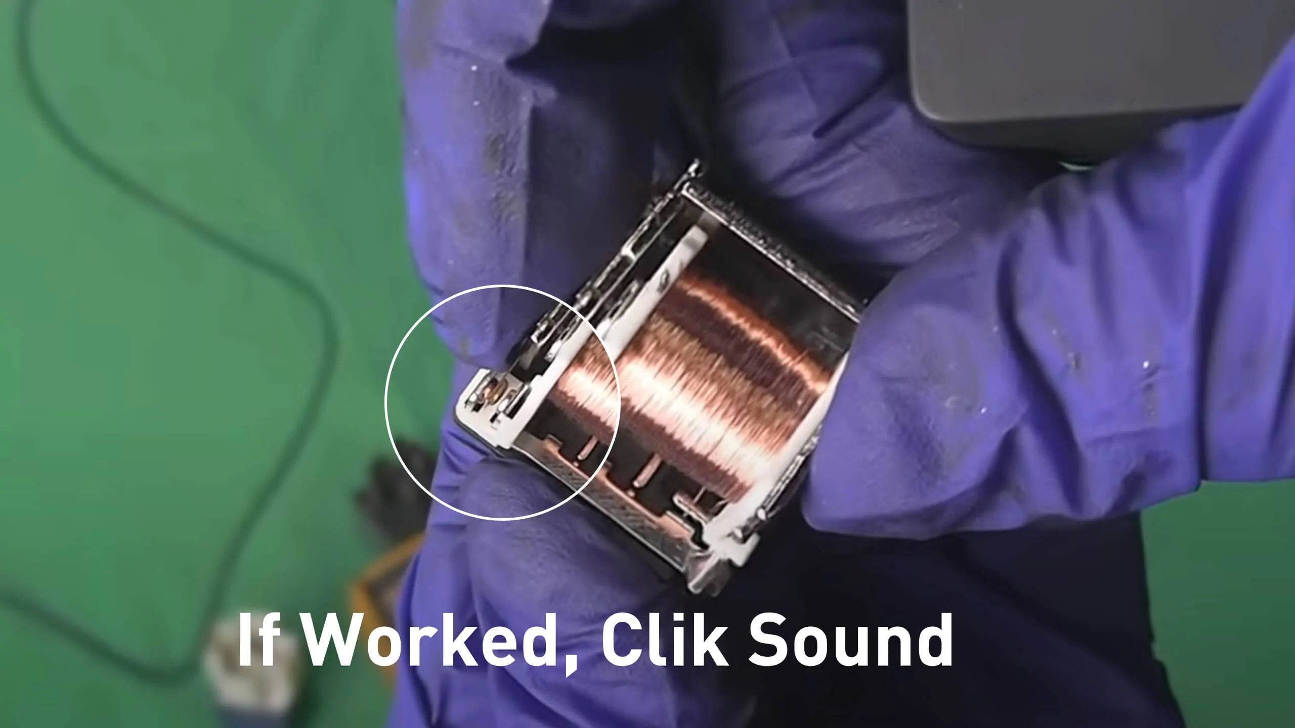

Bad Relay
Most automotive headlight systems have relays, one for each high and low beam that control the current operation of the headlights and act as voltage regulators. Although it has a long lifespan, as time goes by, its performance will continue to be consumed due to factors such as frequent switches, heat and resistance, and there will always be a day when it fails or suddenly deteriorates. Once the relay is broken, it will prevent the battery power from connecting to the headlights for power operation.
You can also listen to the clicking sound the relay makes. Relays make a clicking sound when they operate and receive signals, if there is no sound then it may indicate a faulty relay.
In addition to this, using a multimeter to check the resistance reading of the relay can also diagnose if the relay is malfunctioning.

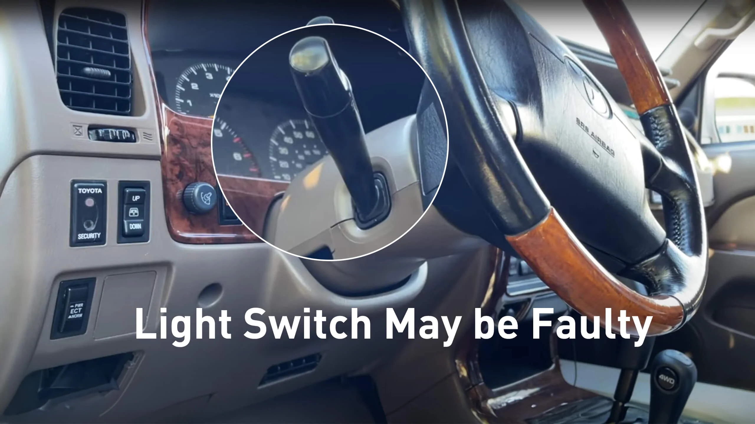

Faulty light switch
Although this situation rarely occurs, there may also be problems with the internal parts of the switch module, causing the switch to prevent current from flowing to the headlights, or the headlight system cannot receive the turn-on command and therefore does not light up as expected. Especially when switching low beam or high beam mode, one of them doesn't work.
Then use a multimeter to further determine the working status of the switch module. This test is relatively complex, so is advisable to left to a mechanic for a professional diagnosis.
