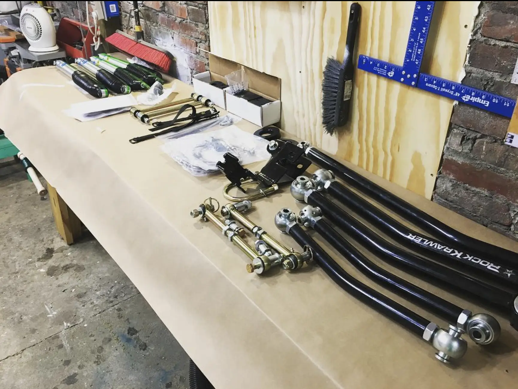

How much of a spacer do I need?
Does the LCA cause issues because it's longer/droopier with the lift?
Sorry for the new guy questions. I had a pretty good kit on my JK and there were no fitment issues, just trying to learn and understand.

I see you are installing a Rock Krawler kit. I have one on myself. The RK lower control arms are laterally straight (not just RK - many others are also). Your factory LCAs are bent inward towards the center of the Jeep; this gives more tire clearance at full steering lock. Another issue is that it looks like you have the more narrow non-rubicon axels.
Rock Krawler lists very specific wheel offsets for their kits. These are NOT suggestions - rather absolute requirements.
Go to their website, if you haven’t already; and lookup your specific lift kit & for your application. In the product description, you’ll find the wheel requirements. You’ll definitely need new wheels and/or spacers (which are not recommended).
That's my old jeep - I was saying I didn't have any fitment problems with it and it is my only point of reference.
