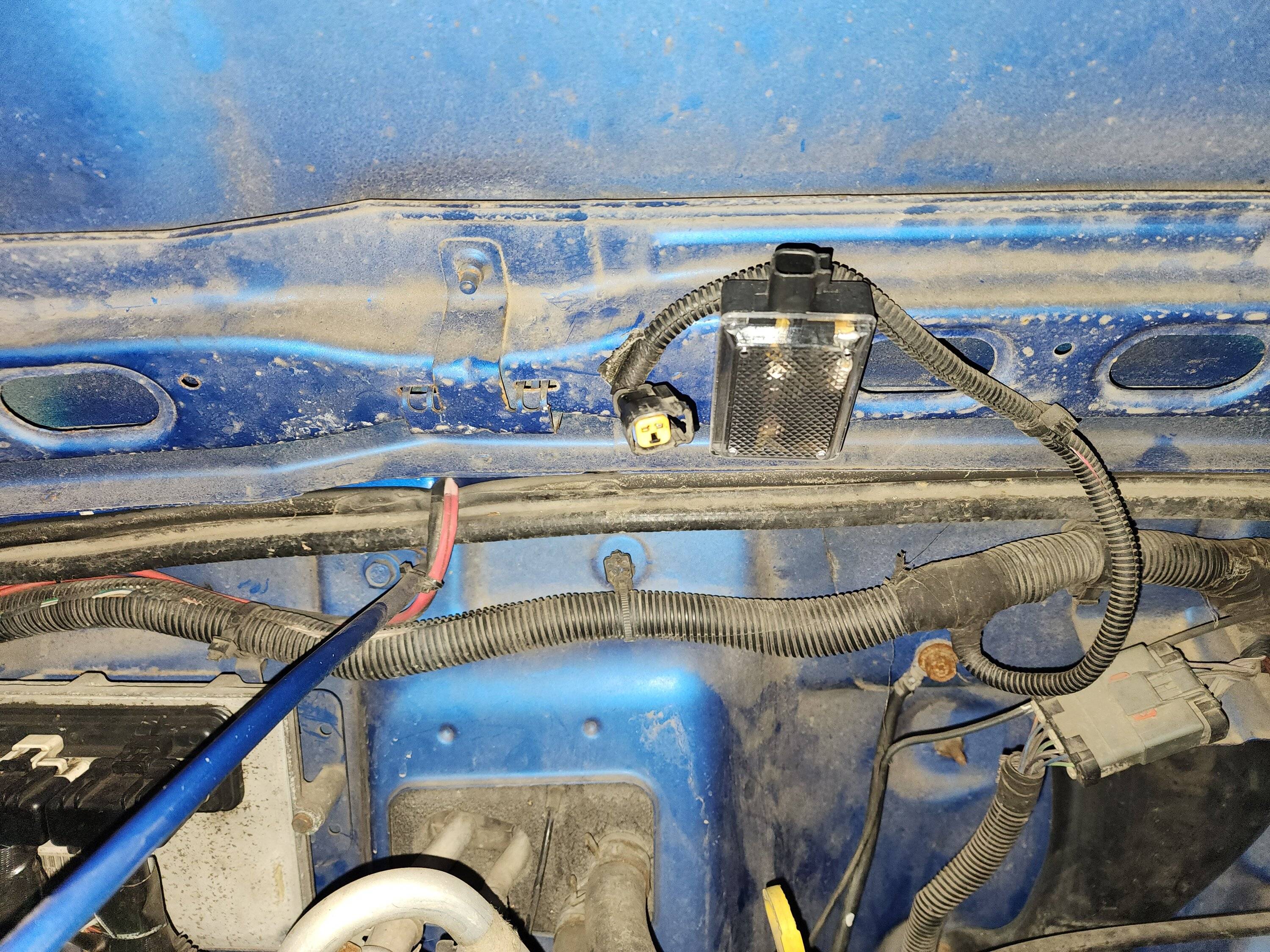

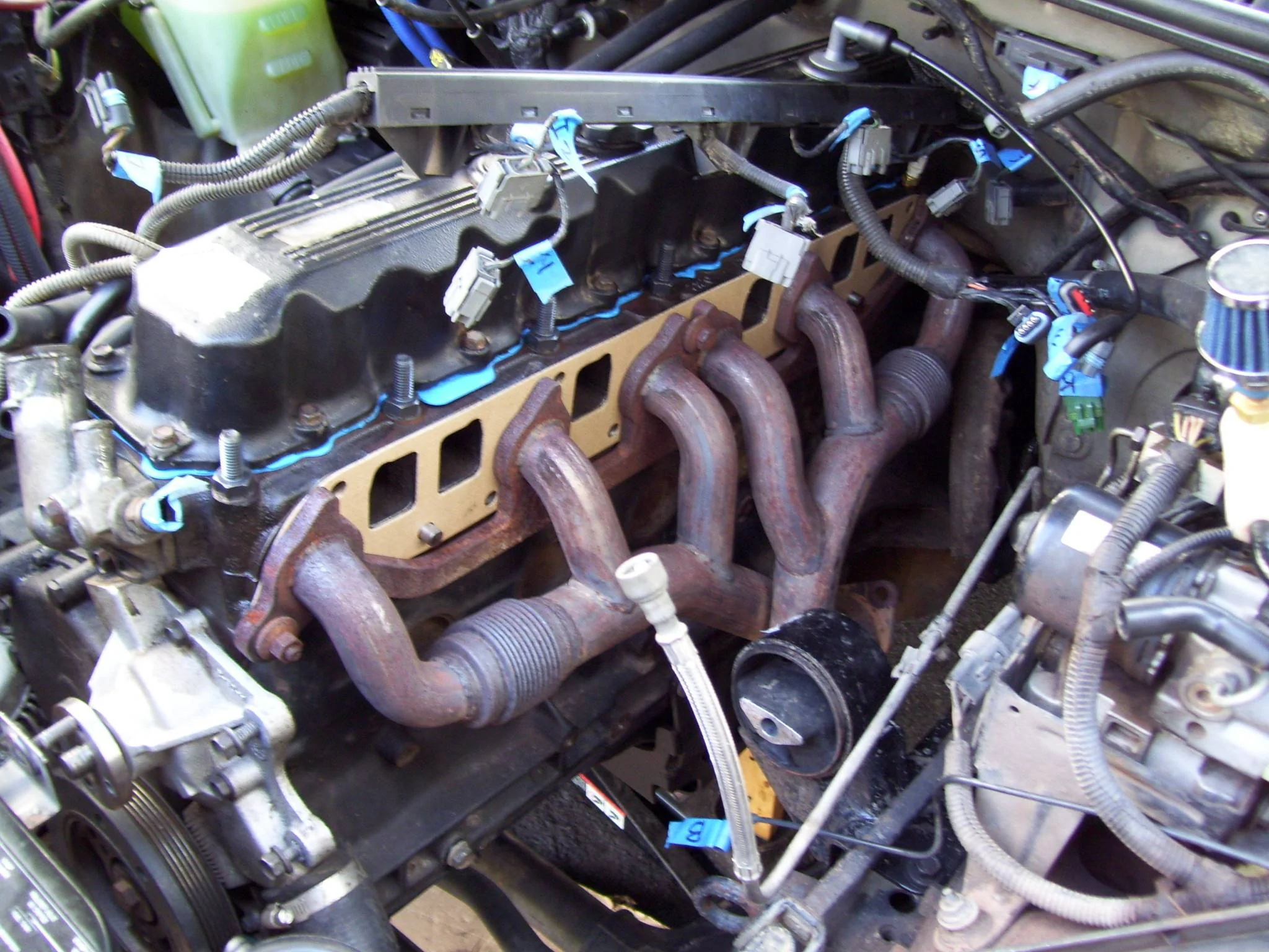

Jeep Wrangler JL Where does this cable go? IMG_20240111_120310_628[1]
Replaced the head on our 2002 manual 4.0 Liter jeep Wranglar. Can not fine where this plug goes. No check engine light on, everything works great except the heater. The blower comes on, the heater hose get hot. No hot air comes out and the vents do not cycle. The parts and service manual is useless.
The cable is laying on the cross member support,
An positive ideals are more than welcome.

I was able to view the links, however I could not see the cable in question. Its the first cable that comes out of the primary bundle that attacjes to the PCM. I know this is crazy... got to go somewhere

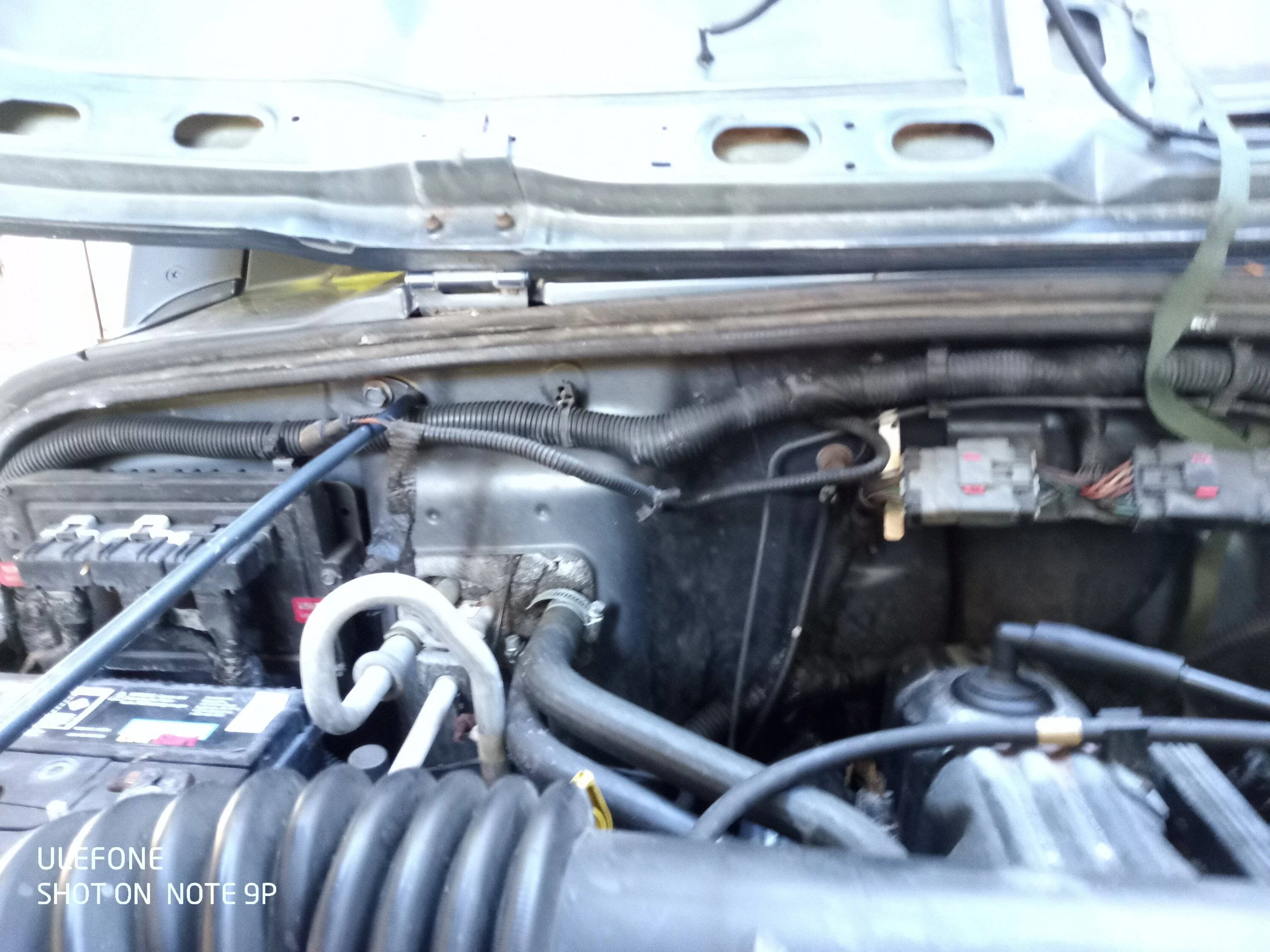

I finally remembered to look at my TJ. That is the hood light wire.

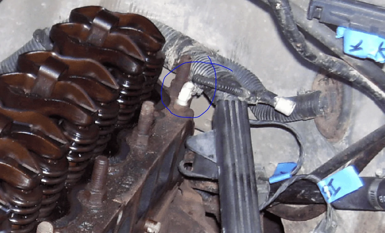

my best guess, look near the back of the head against the firewall, driver's side --> engine temp sending unit, it's hard to find especially with the cover on

Thanks everyone. I belive it the hood light too. My does not have the light. I am thinking it came liise while changing the Head
