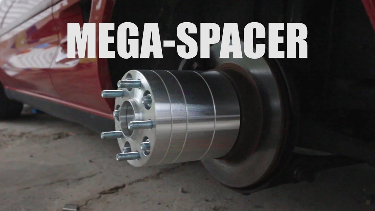

He could do this, I'm pretty sure this doesn't put any strain on any of the components.
Now that's funny!
.... However I have seen a few 4x4s around the area that have followed the "mega spacer" trend
