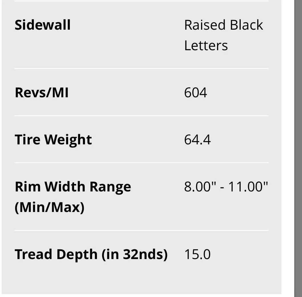

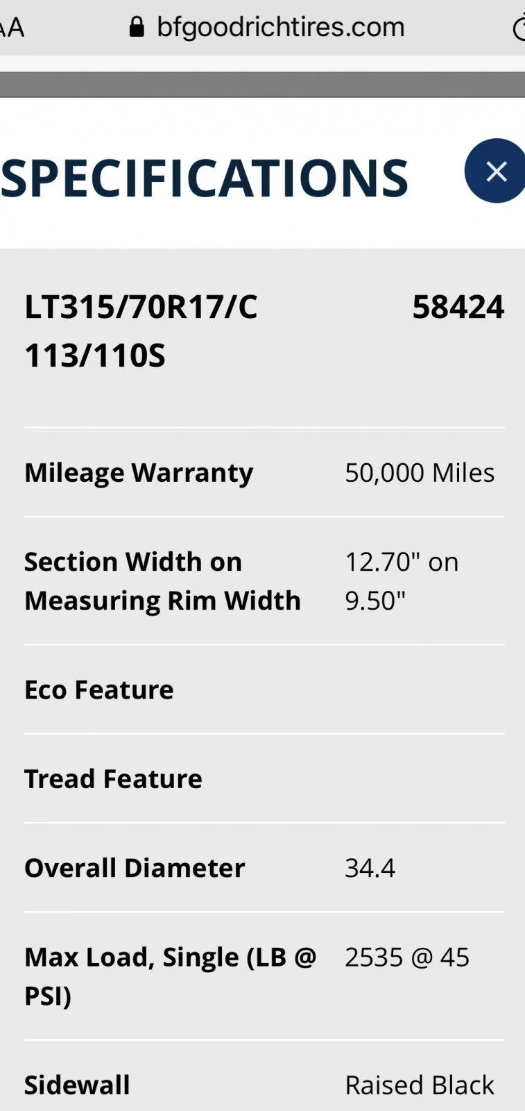

The stock BFG’s on a rubicon are load rating C
Save yourself the headache and get 17” wheels and go with the metric 35” BFG KO2 which measures 34.4” (according to them) and is also C LOAD RATED just like the stock ones are. :like:
