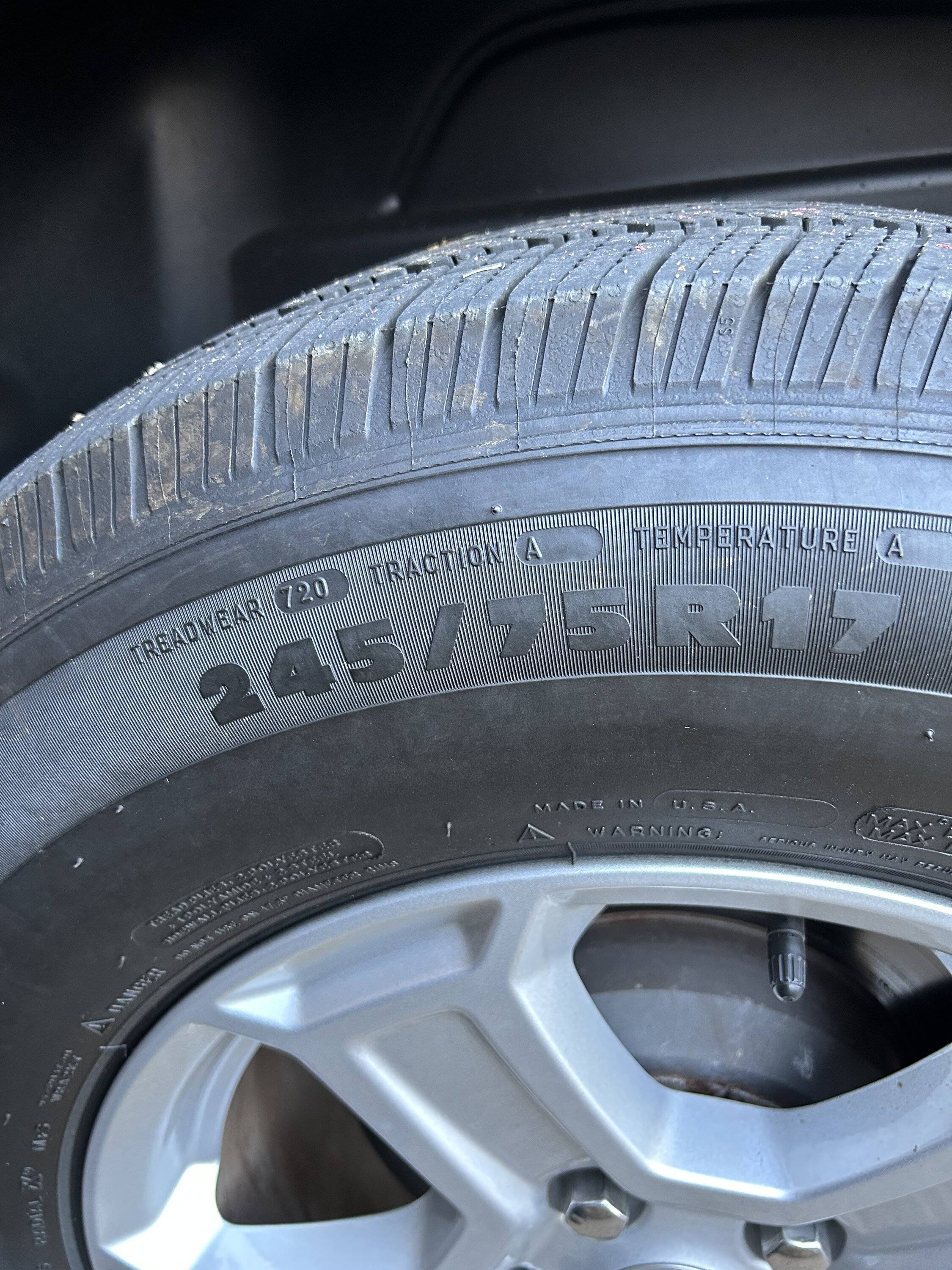

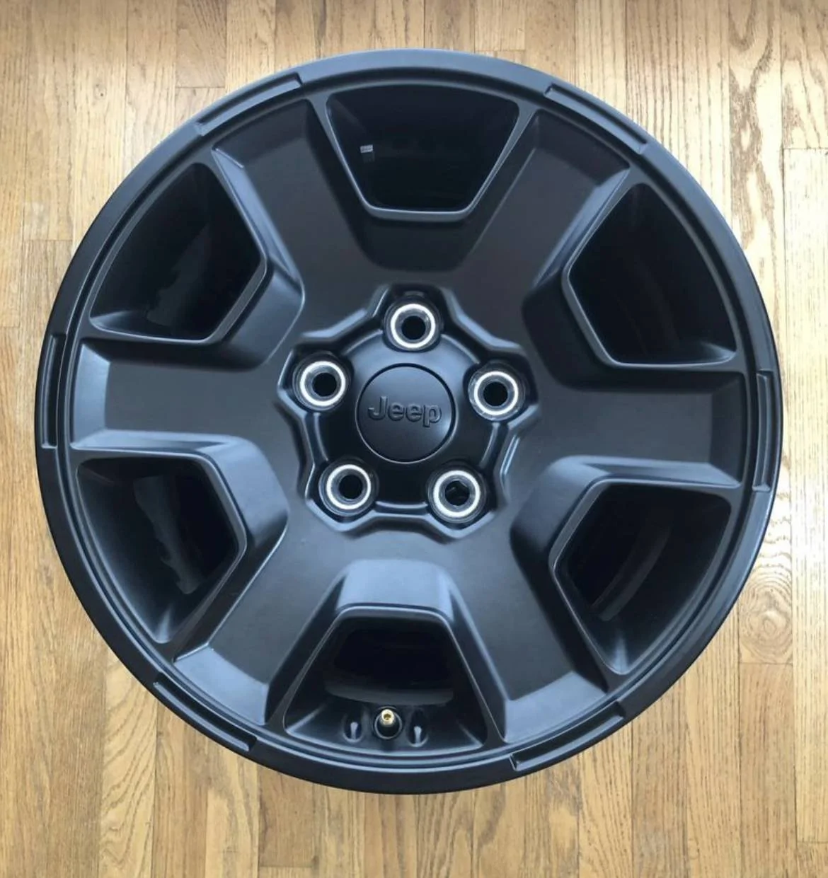

I’m considering purchasing a set of OEM Jeep wheels off of a 2022 Gladiator Mojave. Will they fit on my 2019 Wrangler Unlimited JL Sport? I’d like to put a set of 245/75R17 tires on them. Here are the specs on the Gladiator Mojave wheels: Size 17x7.5, 5x127 bolt pattern, 71.5 center bore, +37 offset. Thanks!

Did you post in the wheel sub-forum? I stumbled across this by mistake. They will fit. I believe they will poke a tad more than your stock wheels. Center bore and bolt pattern are shared across both vehicles, they use the same front axles with the occasional subtle difference like FAD close-out or some of the non-Rubi models get wide-track axles.
