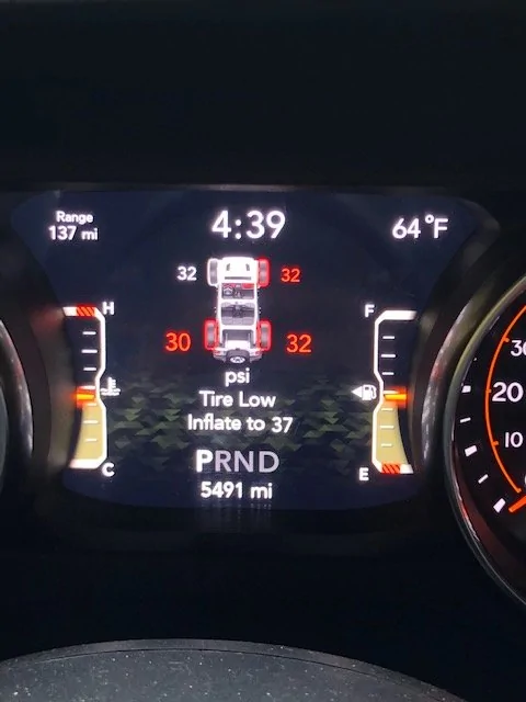

I aired up a little after hitting some trails the other day and saw this on the dash. I can't figure out why one tire at 32 psi is ok but the others at 32 are not ok. How is that possible? It stayed like that till I aired up to normal the next day.

You need to go over 35 to clear the TPMS warning.
But it will display warning at 30 psi.
Your 32 was fine because it never dipped under 30.
You can pump the tires to 35, then lower it to 32.
