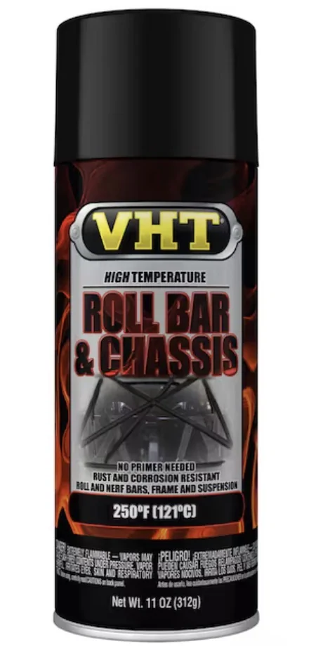

I’m swapping in rubicon Dana 44s on my Sport. They are take offs that are trussed and already geared to 5.13 for some 38s im going to run.
I want to paint them prior to install so it looks nice and fresh. Best rattle can paint to use? I was thinking VHT roll bar and chassis paint. What do the experts say?
