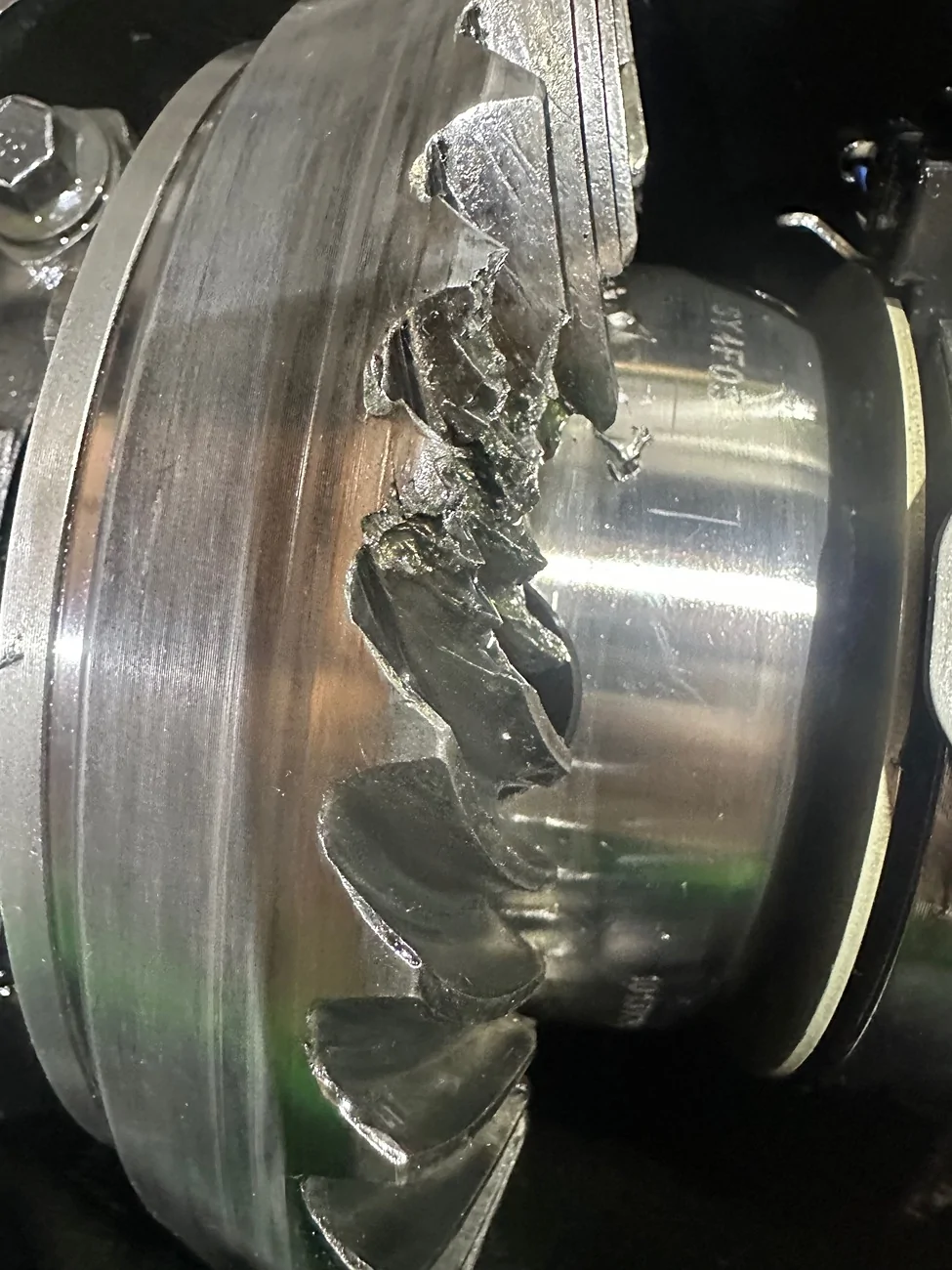

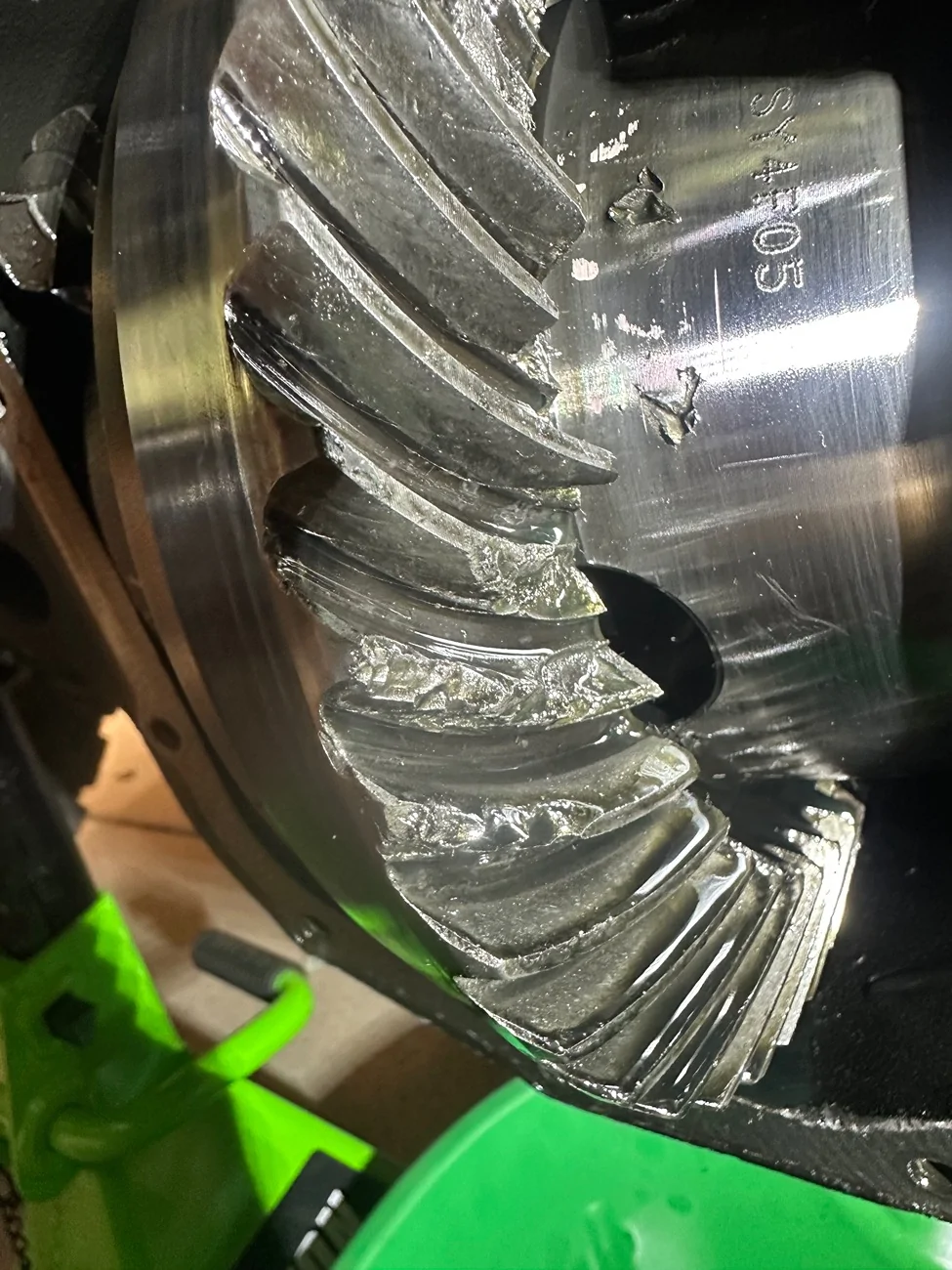

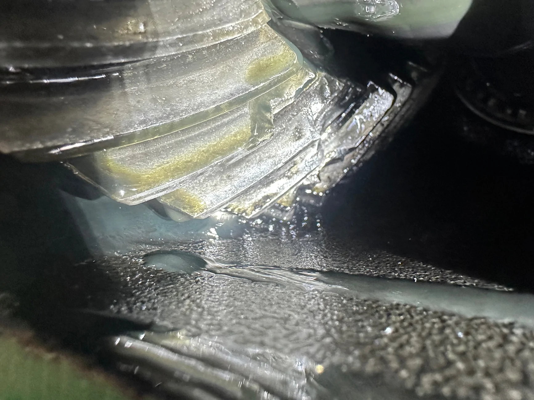

Well fellas, I decided to drop the rear diff cover just to check things out and found some nice sized chunks out of the ring gear. I’ll be dropping it off at the shop who did the gear install on Monday. Im fairly certain this is the issue now after looking at it lol.

ouch

Sheeeeesh

Oof!
Hopefully the shop makes it right for ya!
But hey! Better than a t-case/transmission issue 😀
That looks iffy...

Let us know how it goes. Will be interesting to hear if they were set up improperly or if this is a case of junk parts in the aftermarket.
