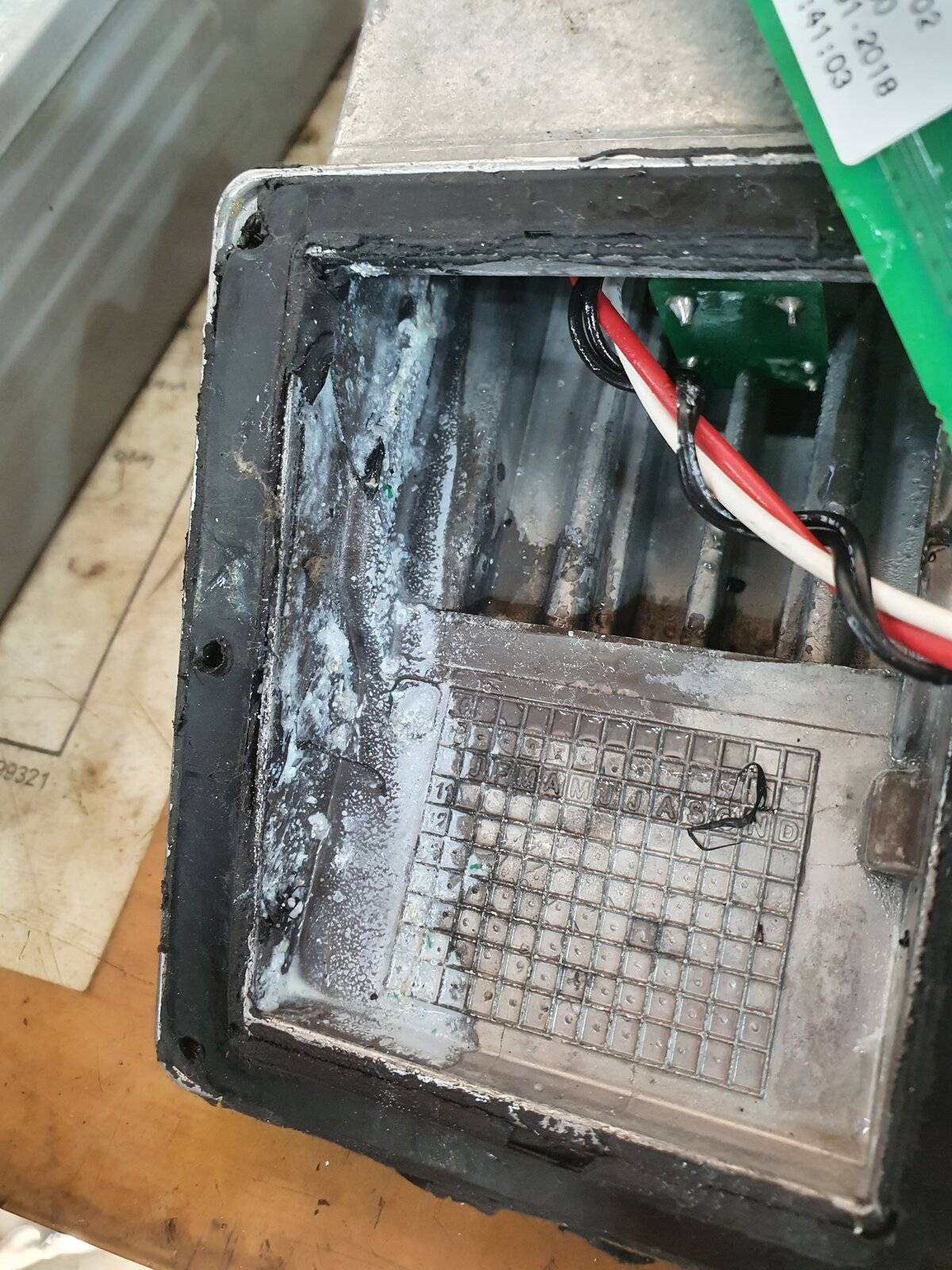

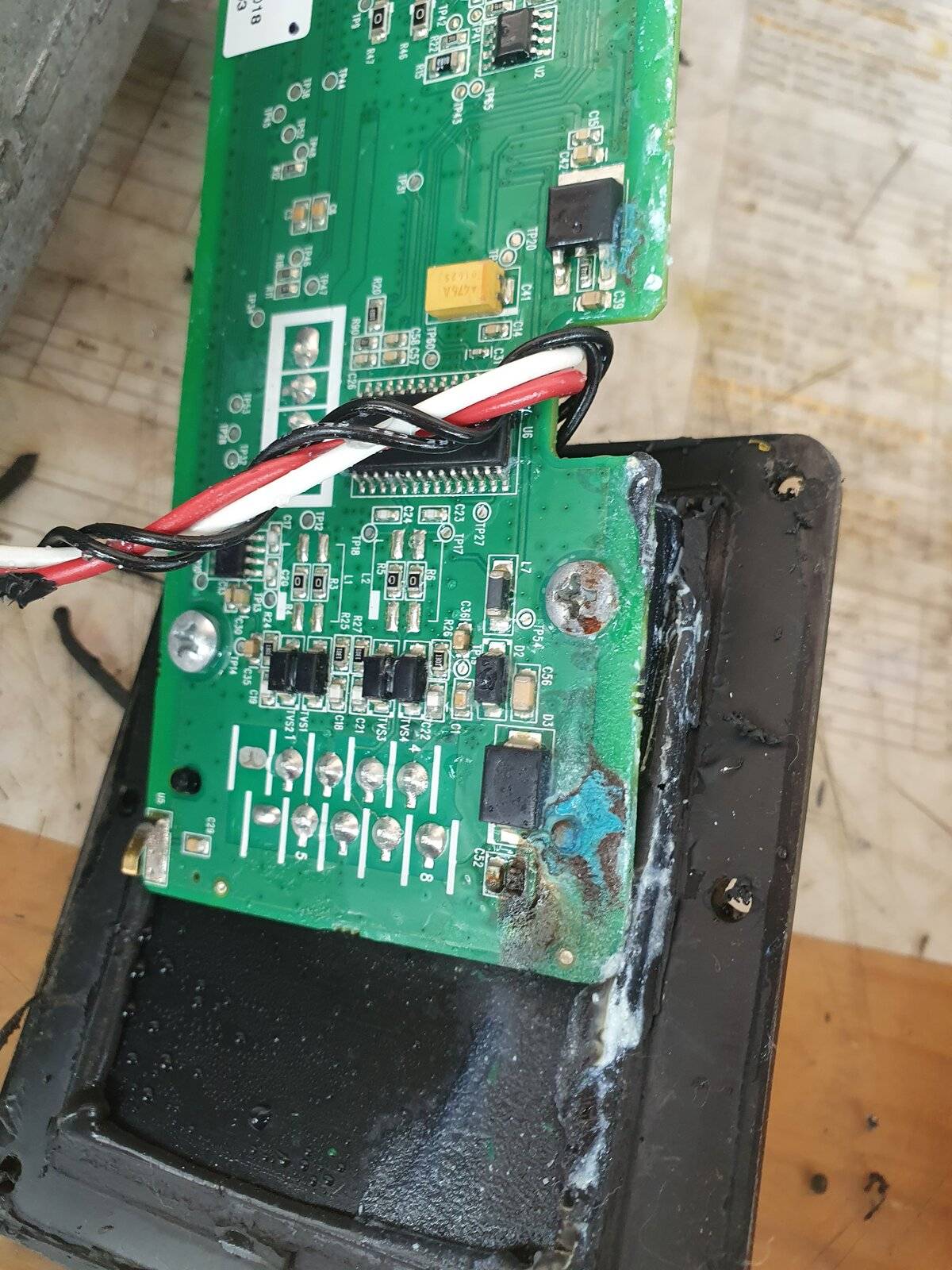

I got a problem in my JEEP
The sway bar warning light is on.
At the official repair shop in Korea,
They say you have to exchange this for a whole.
SMARTBAR seems to have a problem to me
Not sold separately
In my opinion,
Looks like this smart bar got stained
Isn't it waterproof?
If you look at GOOGLE
The car went well even if the water got into the interior.
What am I not mistaken?
haha....
Could it be that only the smart bar could be obtained separately?
Assey is too expensive
I'd like to let you know if there is a sale.

Hi, There is a thread somewhere on this forum titled:
"Rubicon Owners, have you waterproofed your Sway Bar connector?"
The thread discusses problems caused by water damage. Perhaps some of the participants of that thread can offer some helpful info.

May also consider getting a stock one from a sport or sahara and add some quick disconnects or if it's in the budget an anti rock and just upgrade the whole thing.
