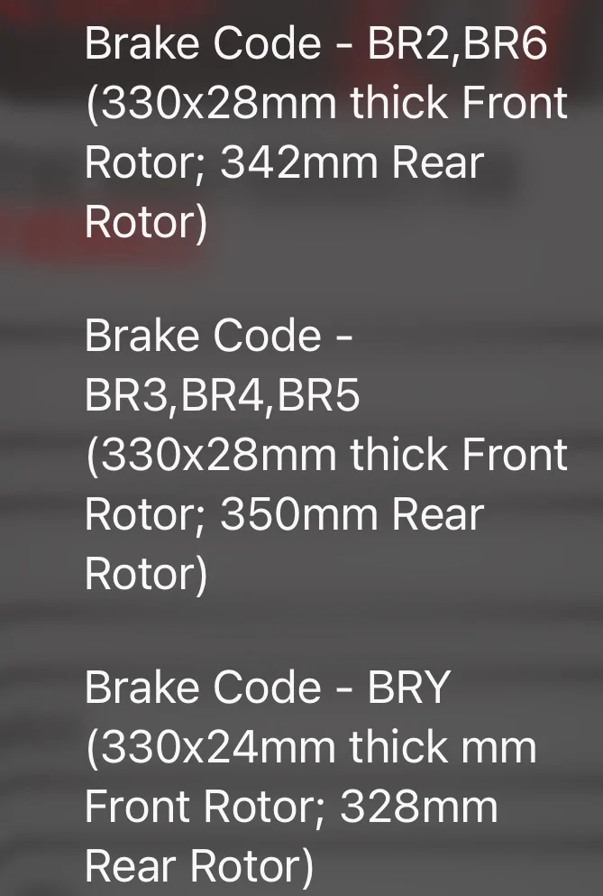

So I've got 89K on my original brakes. It's time to do the front's. There are so many different pads and brake rotor sizes: how do I know what I have. 2021 Sahara, trailer tow package, trac-lock, 2.0. Is there a code in my vin # that tells me what I have?

BRY - base Sport and Sport S
BR2 - Right hand drive(RHD)
BR3 - 4XE models
BR4 - Xtreme Recon pkg, 392
BR5 - Sahara High Altitude
BR6 - Willys, Sahara, Rubicon, and all w/Eco Diesel
Jeep Wrangler JL What brake pad do I order? 1778246776283-jg

I'll be the dumb one... Where may I find the brake code? It's not on my build sheet or window sticker. I know for certain I have the larger front brakes. 2020 build 2 door Sport. I have ordered brakes for the Sport and had to return them, too small.

You don't need to find it. It's by model. You have a Sahara. You need BR6. Unless you have the high altitude then you need BR5.
