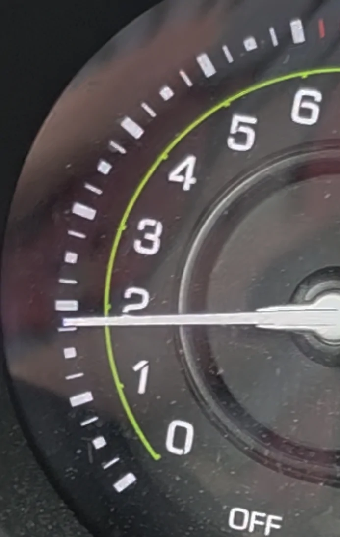

Okay so on the drive home today, i noticed that it was primarily happening while I was maintaining speed - like consistently going 45 mph or something. When it would happen, the RPM needle stayed where it had previously been, but when it stopped, it would drop down 1-2 lines.
So for example, if the needle was on the 2, it would drop to the line or two below it when the sound/vibrating stopped. Then repeat shortly after

Clutch slipping? The 4xe doesn't have a torque converter and uses a computer controlled clutch to engage the ICE-transmission. If that's out of adjustment or having issues it could cause your sound and the RPM changes. Take it in and let the dealer take care of it before it goes bad and leaves you stranded.

I guess it could be the trans when it happens next take not of your trans temps if the wet clutch is slipping it will build heat like crazy, maybe look at the gear your in also. I feel like it’s weird to be coming from the left side of the jeep almost where the T case is but no one can tell from not being there or experiencing it.
