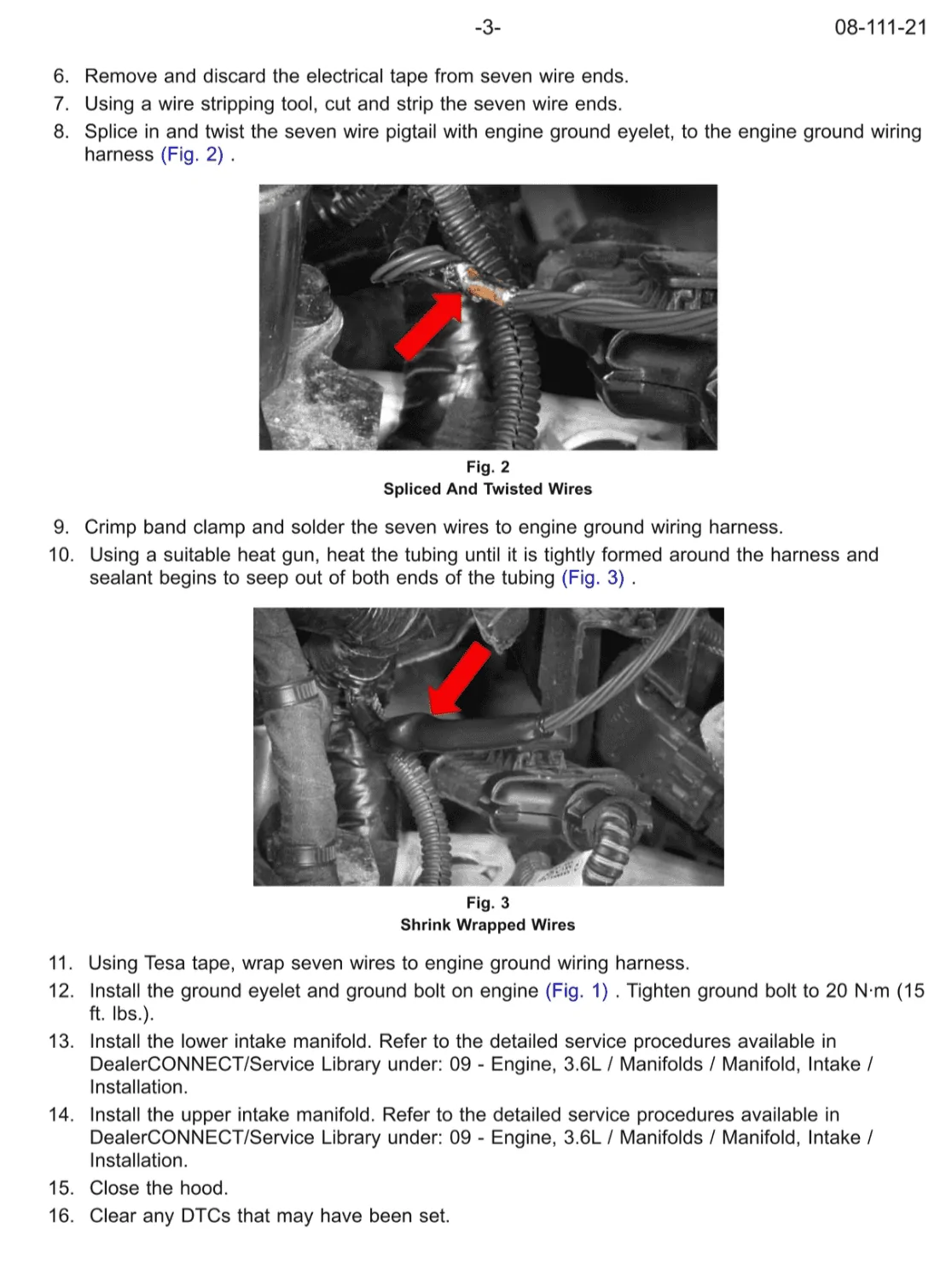

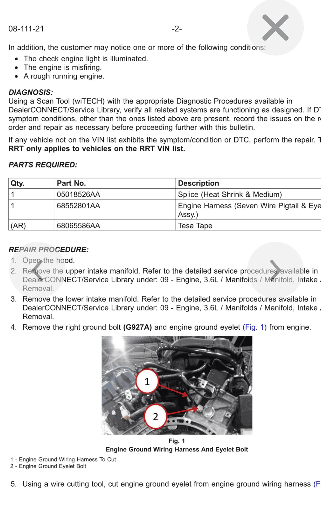

There’s a TSB issued for a rough engine that may trigger the MIL…

Page 2…

Page 3…

Yep, dealer will see it when it breaks down and no sooner. BTW those bulletins are for the 3.8 V6. This is the 3.0 Diesel. I really don't think its much of a concern, more of an observation. Im chalking it up to "its a diesel" until something happens.
