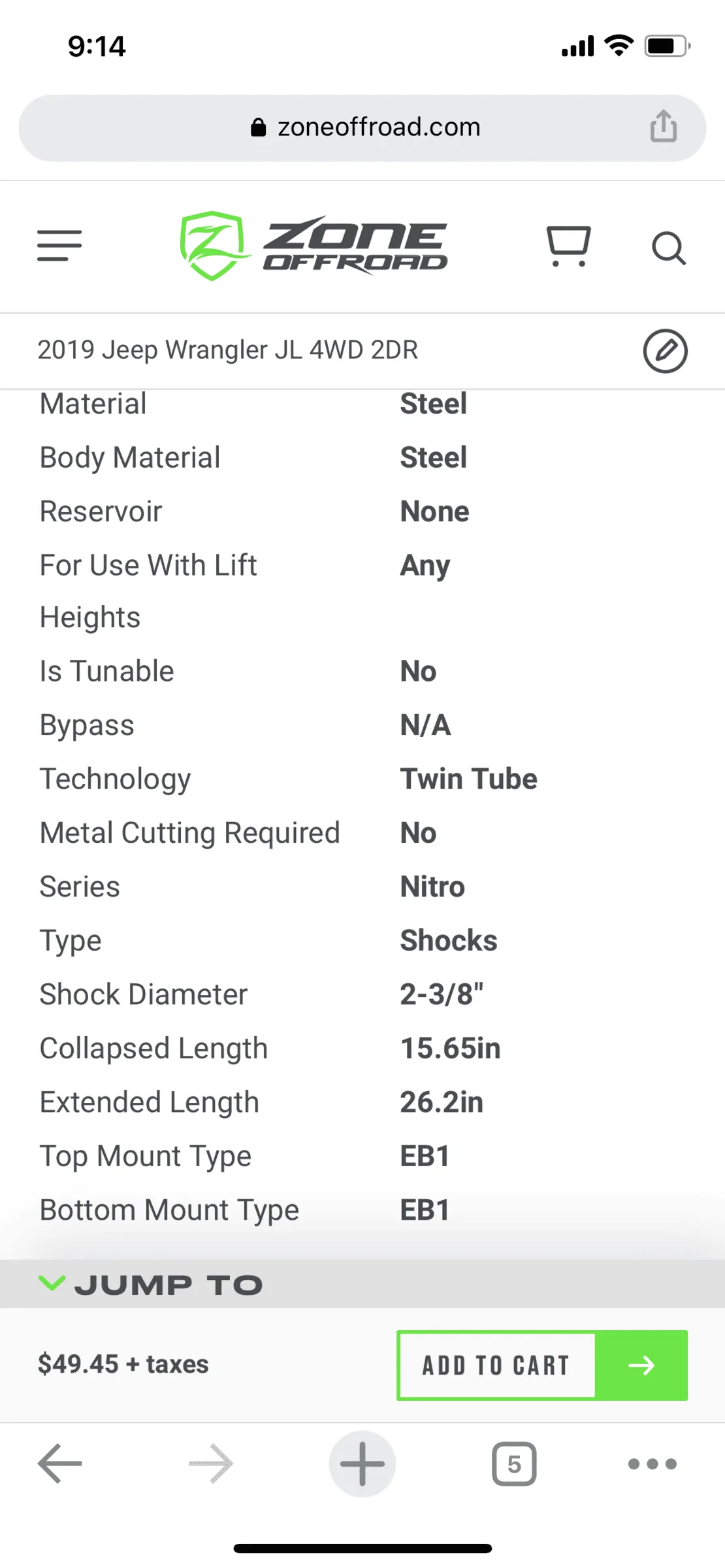

Hey everyone,
I recently purchased a 2018 JLUS, I pretty much immediately put in a zone 3” lift kit, JKS control arm drop bracket and a RC adjustable front track bar. I’m looking to upgrade the kit I have, while still using some of the parts that are already on the jeep. Any insight would be much appreciated.

Can you post a link to the specific lift you installed so we know what parts were included?

What are you looking to improve?
Height, flex, ride?

hight and ride are both pretty good, would like to get more flex out of it
What tires/wheels are you running? Any rub currently inside the fenders?
How much you looking to invest?

right now I’m running 35x12.5r18 toyo R/T on black rhino wheels. No rubbing made sure I got the proper back spacing ??. Honestly right now it doesn’t really matter wife gave me the go ahead to build it however I want it. In the new year I’ll be going with take off rubicon axles

Assuming the included bump stop extensions are 2” in the front, you need to look for a minimum extended shock around 18.25” or less and as close to 29”, but not over if you want to keep the stock driveshaft , extended as you can get.
Really, you have that in your current front shocks (if I pulled the right stats) if you add 2” extensions. Several options of varying price in that range for a new set.
