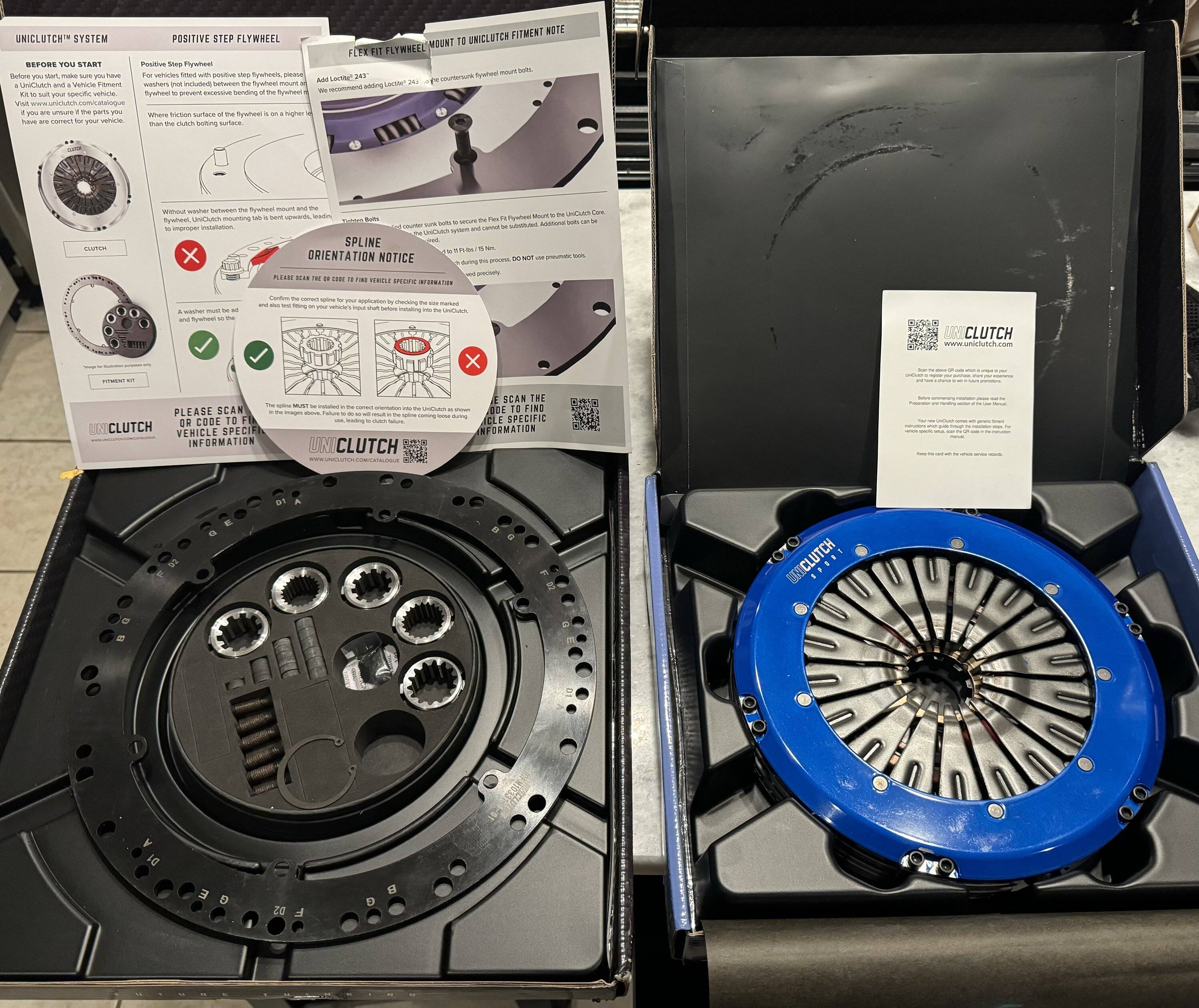

Got my new clutch in. I’m rolling the dice on a new product. I should be ordering my Atlas tomorrow and both will install at the same time.
If anyone is interested in specific information about the uniclutch let me know and I’ll get the photos, measurements, etc. This will be my first clutch swap.

Are you reusing the OE flywheel like they suggest or using something else?

I’m using the OE flywheel. I’m at about 8,100 miles. I tried corresponding with them about an aftermarket flywheel but couldn’t articulate myself well. Since it bolts to the flywheel it seems irrelevant if the flywheel friction surface is worn or not.
