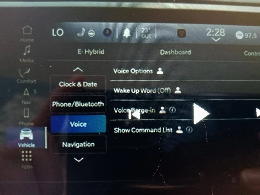

My VC buttons don't work to make or answer calls. Took to dealer, they told me "The VC buttons don't work unless you have phone connected" ? my phone is connected ?
Then they told me VC only works when using Android Auto, that I can confirm the voice control does work, but I hardly ever use AA because I find it very frustrating ?
Owners manual makes no such statement about VC buttons and Android Auto.
Can anyone confirm dealership tech is correct?
TIA

Could this be a trim level issue? Voice Connect only on....
Willys? Sahara Altitude Rubicon?

Anyone with a 2024 JLU Sport S have this menu option?

Can someone confirm Voice Control steering wheel buttons will only work if you have factory NAV?
Not so. They should work with a non-nav radio. They worked on my 7” before I swapped it for an 8” nav unit.
As previously mentioned, if the phone is paired via Uconnect, the steering wheel controls should work.
I suggest factory resetting your radio.

Stopped by my dealer again today, salesperson came out to my Jeep to take a look at my Uconnect etc. Seemed perplexed so they went inside to talk to tech ?.....
Now they are telling me I need ALEXA or WiFi to use the Voice Command Buttons !!!!
I did a factory reset and I'm seeing things I didn't have initially but still no VOICE selection like in this picture...
