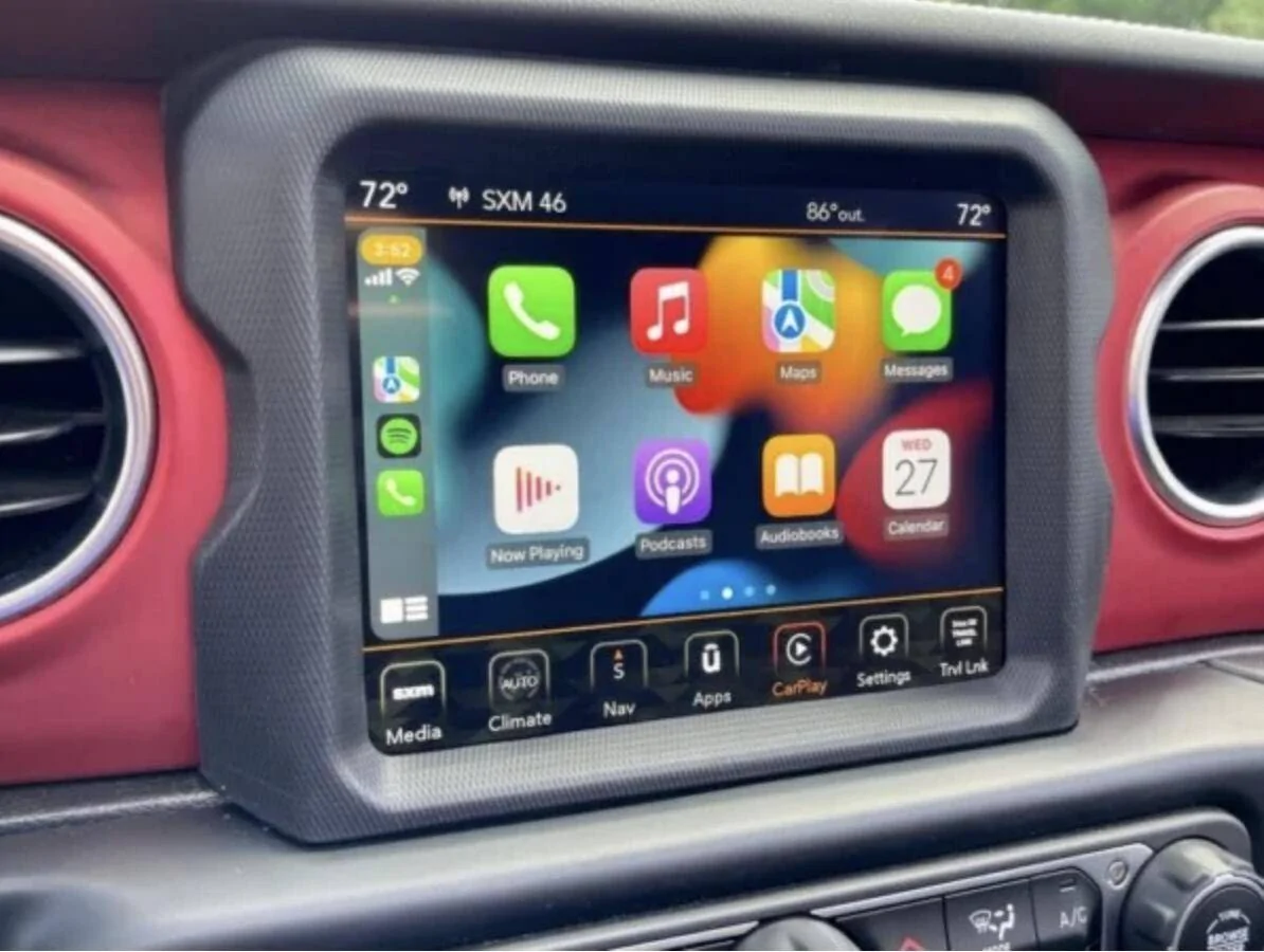

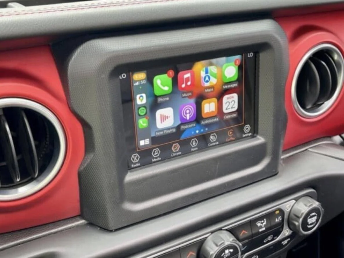

UCONNECT 4 Identification (pictures from infotainment.com, a forum sponsor):
7"
Jeep Wrangler JL U Connect replacement 1746474191897-m3
8.4"
Jeep Wrangler JL U Connect replacement 1746474160433-y

Is that even a path you're interested in going down? Ordering a used one from the US and getting it shipped there?
7"
8.4"
Probably don't want to put a US-based 8.4 in a UK Jeep as it wouldn't have the maps, but I could be wrong.
True, but we really don't know what he has or how he uses it. An 8.4 for Gaia via Android Auto or CarPlay? A US one should work just fine. If it's even an option to OP, Infotainment might know about non-US Jeeps and maps. I haven't tagged them yet because it might not even be an option to OP.
