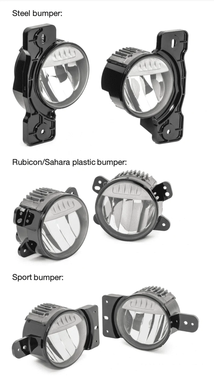

OK… so I have a 2021 JLUR and am going to be replacing the front bumper. Additionally, I have the LED lighting group on it and plan to keep using the fog lights. I have researched a number of threads and am not 100% sure I understand everything completely.
I currently have the normal plastic bumpers. I have also read that the LED Fog Lights on a Rubi don’t work with many bumpers. What’s the difference? I saw a graphic that shows that the rubi fog lights in the plastic bumper are the same as other trims. The one thing I saw was that if you have the steel bumper group on your rubi, then those fog lights won’t work. So here’s my questions…
1. In a plastic bumper on a Rubi… is it the same 4 mounting points… kind of at 2, 5, 7, 10 o’clock… that I see in many videos for other types of JLUs?
2. Is it only the steel group LEDs that are not often compatible or different?
Help me understand :)

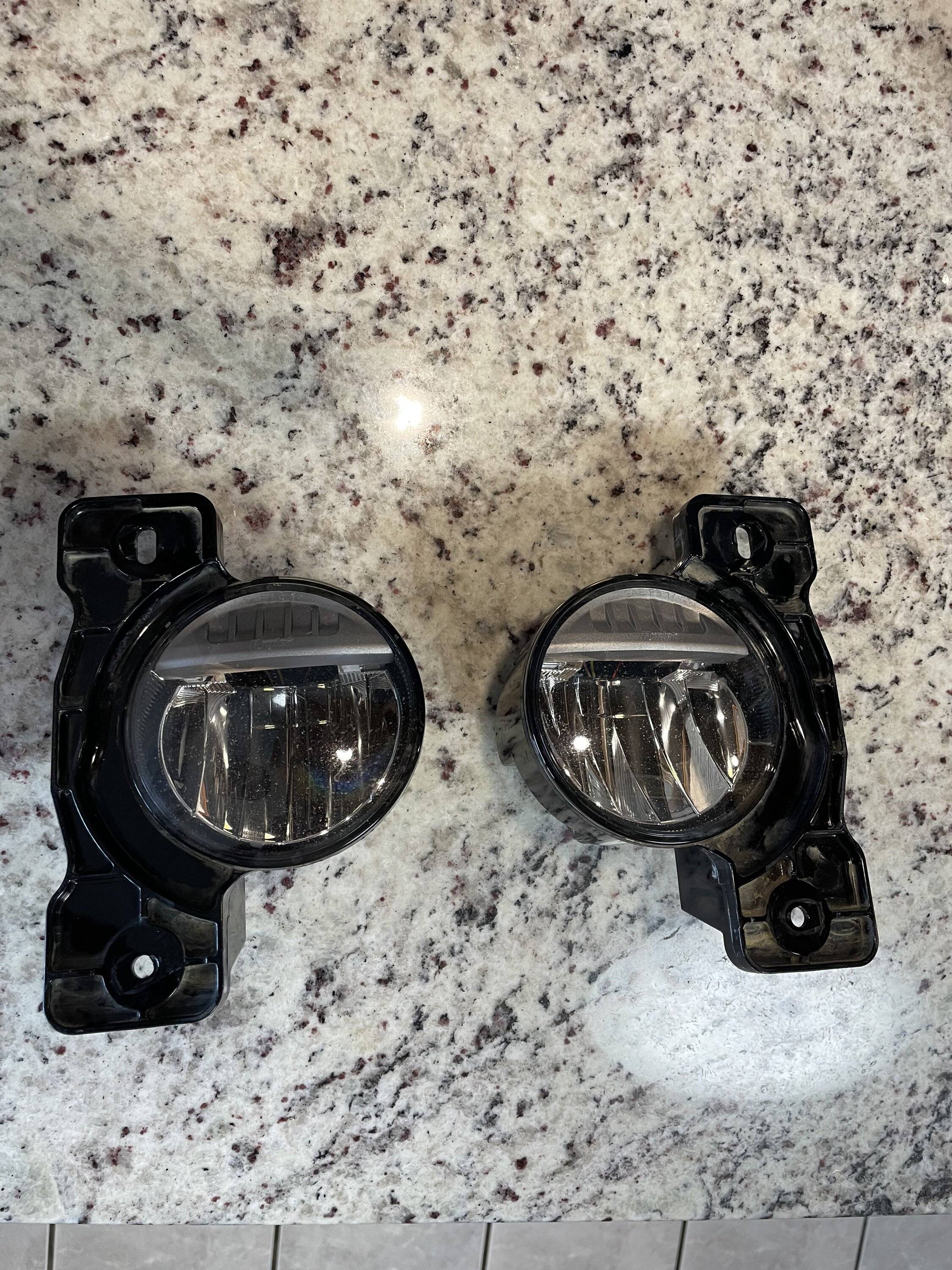

There are three styles of fog lights, Sport, Rubicon/Sahara/etc premium bumper, and steel bumper. As you noted the premium bumper fog lights have four mounting holes. Here are a pair of steel bumper fog lights.
Jeep Wrangler JL Trying to understand Fog Light differences BE67C31E-7AB4-40C6-8D57-C7A8B469B5DF
The Sport fog lights have three mounting holes, two on one side and one on the other.
