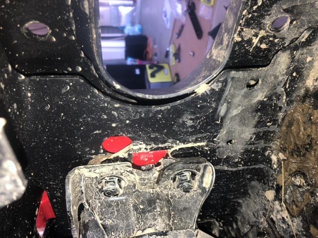

I ordered a 3 piece bumper with no fog lights because I was planning on reinstalling the stock ones. It looks like a hole is missing on the bumper to install the brackets. It has two holes horizontal but not one at the top. I’m debating just drilling the hole. Anyone else have this issue?

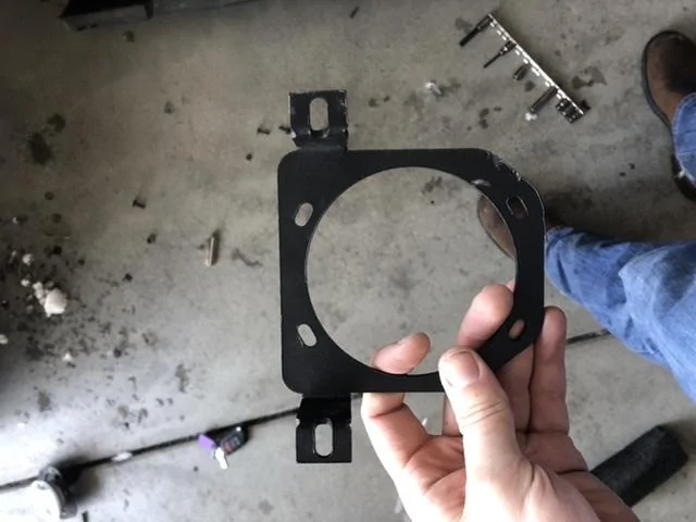

So here is what I have found. I swapped the stock piece (left) with the adapter piece (middle) to attach to bracket (right). Still missing a hole for the right bracket... bumper taken apart and the drilling will commence!

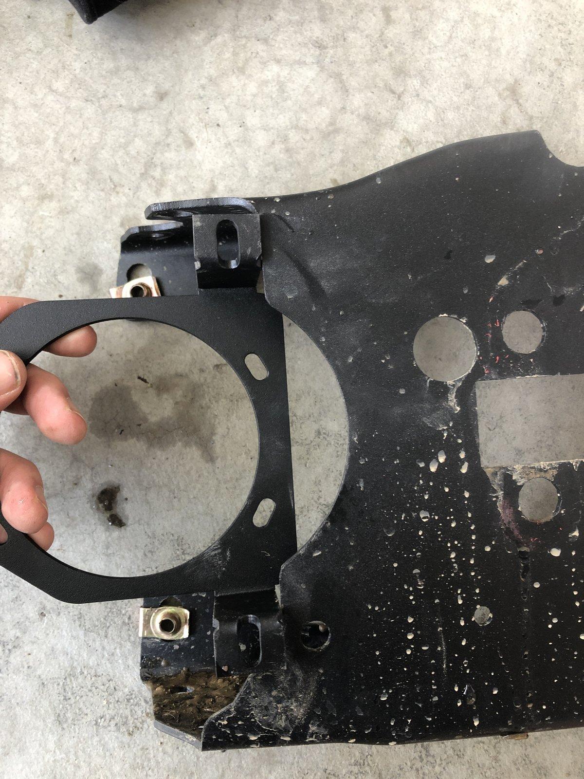

Wait... Are you sure you are mounting the lights in the correct spot? Seems like they mount using the "push nuts" on the backside of that last pic you have.
Seems to me like what you have should work to mount the halogen fogs to the steel bumper, at least according to what I have read in other posts.
Or maybe perhaps your bumper is missing a part? Check out the pics here of the steel bumper.

Thanks for the photo! It is definitely missing the nut and the hole for it. Otherwise, I have all the brackets.

I have the adapter to work with the bracket that came with the bumper. The problem is the bracket that came with the bumper (used with LEDs) does not work with the bumper. I found a fix for it and will post pics later.

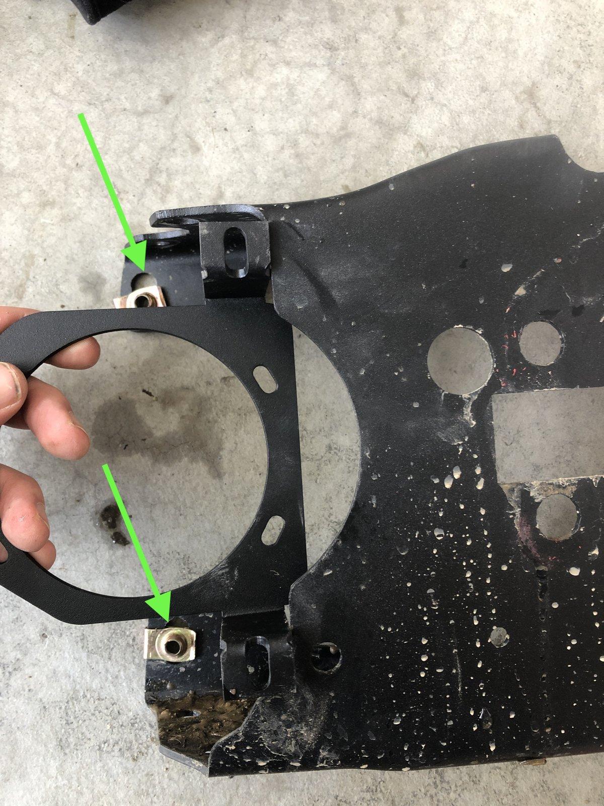

I was thinking that the green arrows in the pic below point to holes are where your bracket should mount (I could be wrong).
