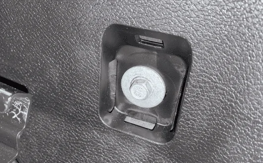

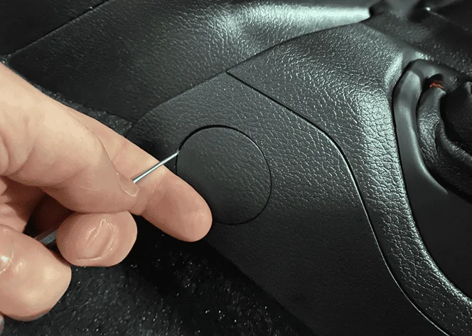

Drivers side, push seat back. I used a dental pick to pull the plug out but something plastic would work better. Insert and pry from the front. As mentioned - 10mm bolt underneath

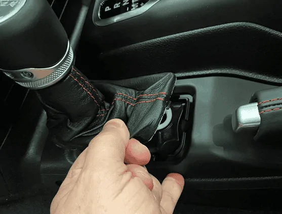

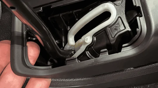

Pull the boot off the transfer case shifter. I just pulled on the leather and it came out nicely but I was worried I'd rip something. A plastic pry tool would probably work better.

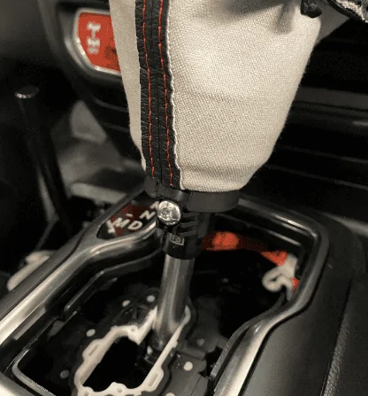

Back out the #20 Torx on the side of the shifter. You don't remove it completely.

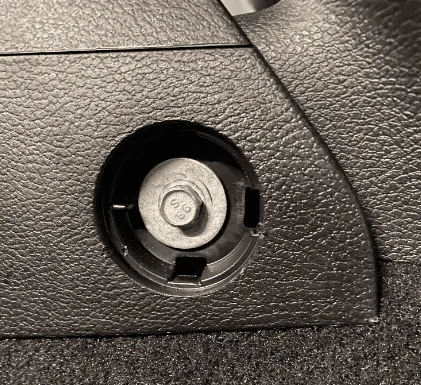

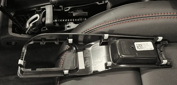

Push drivers seat forwards, pry the cover off from the top, remove the 10mm from the back of the console. Move to the passenger seat forwards and from the rear remove the 10mm the same way.
Move the passenger seat back, remove the 10mm bolt the same as before but pry from the 9 o'clock position. It's hard to see in the picture but the cover with its 3 clips on the underside are oriented opposite the one on the drivers side.

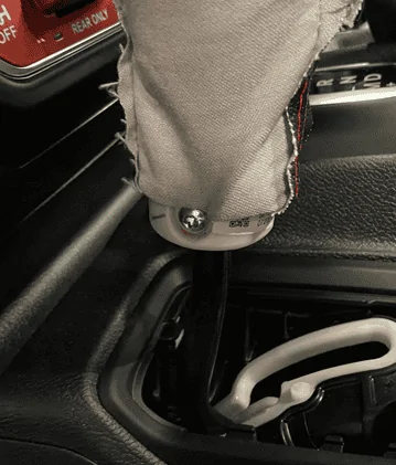

Back out the #20 torx and push in the shift release button on the front so the handle will come off.

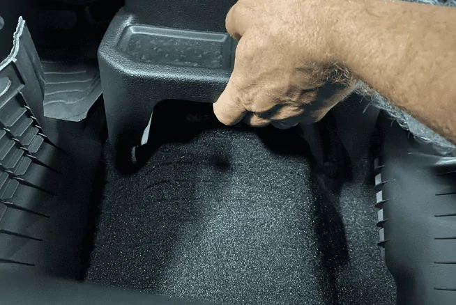

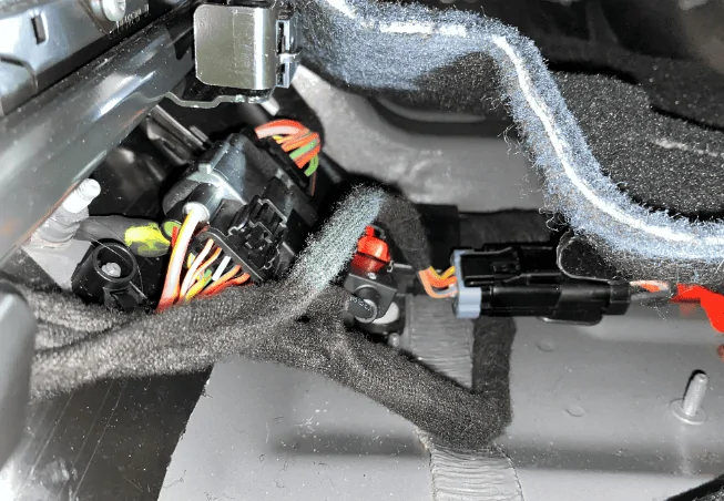

Push the passenger seat forwards again, return to the rear seat and pull the carpet back to reveal three electrical connectors. The one in the middle is the type that has a sliding red lock, the other two are just squeeze and pull. You can lift the rear of the console up to help push the wires under the seat rail.

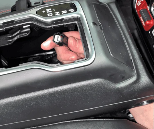

Push the front passenger seat to the rear and lift the front of the console a bit so you can reach underneath and unplug the gear selector backlight.

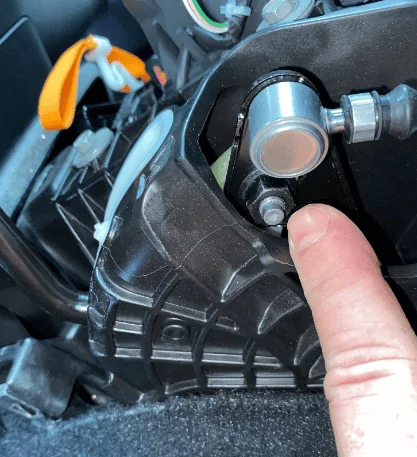

Pull the console out and go to the drivers seat. Just beneath the silver transfer case linkage is the nut that rides in the slot Abrice37 described.
The first time I opened it up the nut was all the way to the right in the slot. I moved it all the way to the left which gave me a positive shift into 4-Lo but it started popping out of 4-Hi... =/
The second time loosened the nut, then pulled the transfer case into 4-Hi by the linkage. Then I stuck the dental pick into the track between the lever and the white track to give it a little slop. The pick is about 1/16th of an inch so tip of a screw driver or a tooth pick would probably work too. Pick not inserted in this picture but I put it in right under the bend in the shift lever.
