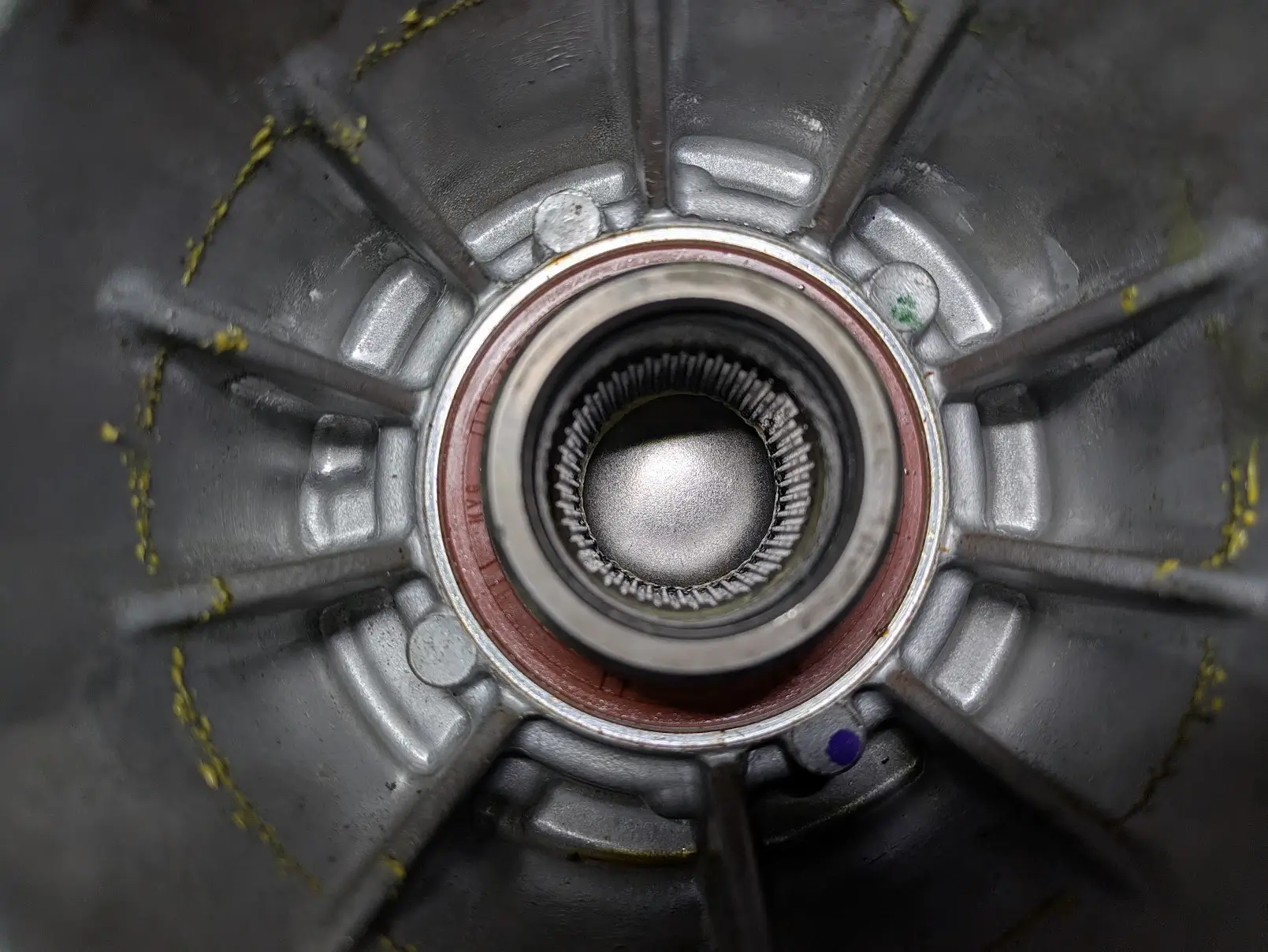

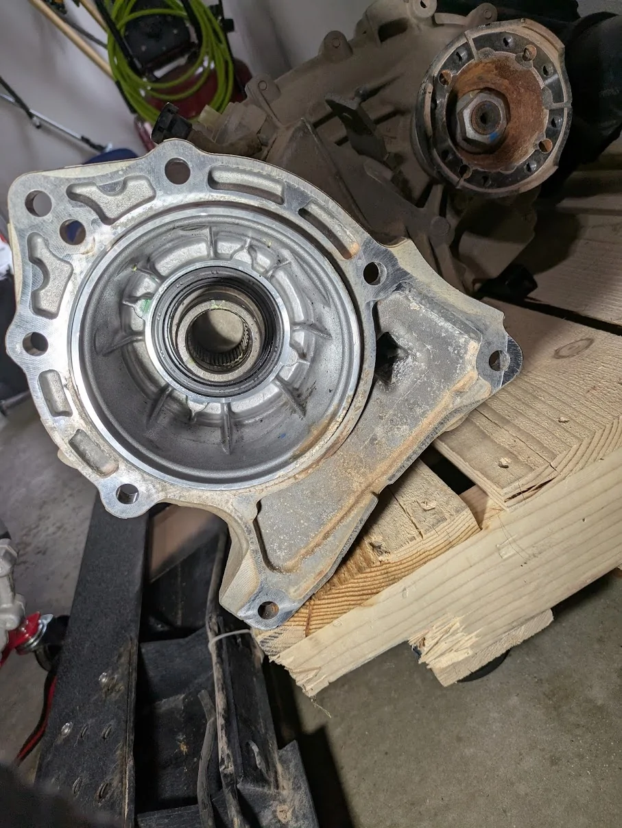

I believe the main difference, if not the only difference, is input shaft spline count. Manual has more, Iirc it was 45 or so. I am not 100% but I think if you can get the correct input shaft it should work.
pic of the manual splines:

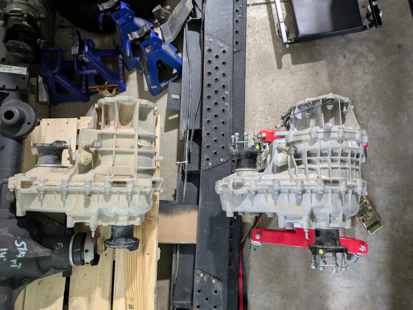

sport housing and rubi housing are quite different
Sport on the left, rubi on the right:
Oh. I was looking for my automatic and the housing was the same. I know the auto 4wd units are different from the part time ones.

Second what @gek said that the cases are physically different. Rubi is bigger so you would not be able to take the insides out of a Rubi and put into a Sport. I also don't know how you would buy just the splines and swap that in either.
