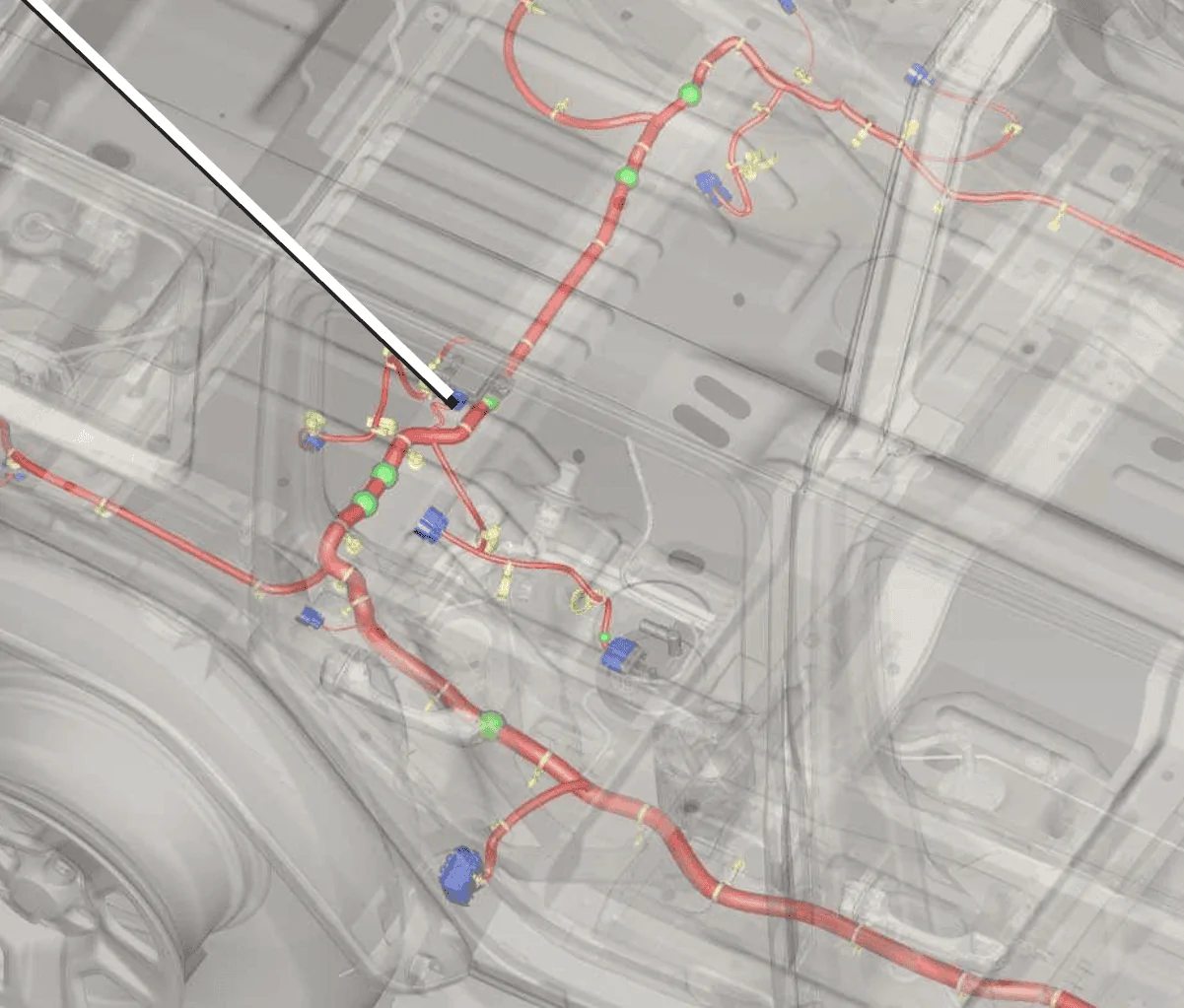

Most likely water intrusion into your TPM module or the TPM module itself is failing. Replace it and inspect the connector for corrosion while you're there.

awesome thanks. Yes it definitely started after I drove through a big puddle. I’ll google it but, any idea where the Tpm module is located?
