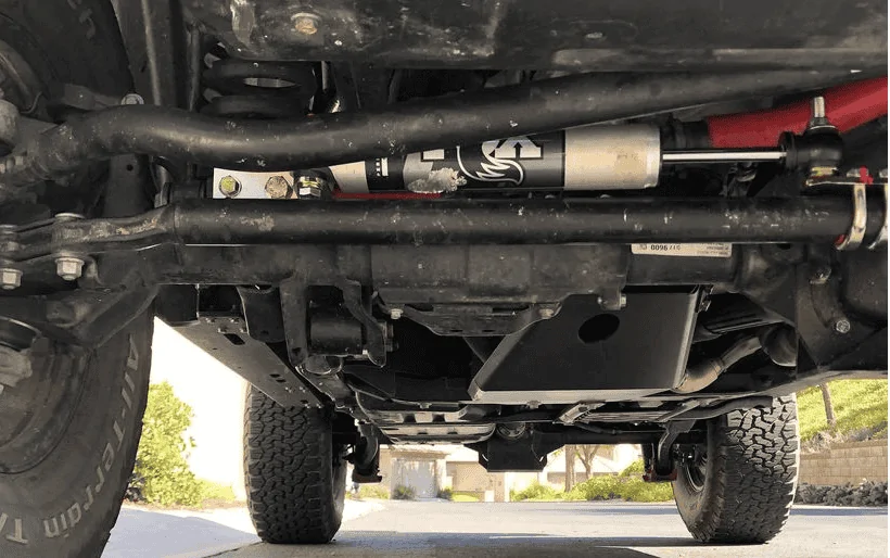

A 2-dr Willys Sarge Green is sooo cool! Congrats on the new Jeep. I think your list is solid. The only thing I would change to save some $$ is the stabilizer. I have run the Fox one and you won't notice much difference (if any at all) between the stock and the Fox stabilizer. The Fox stabilizer does have the "look cool" factor and will match your Fox shocks on the lift but IMO not necessary. The factory stabilizer location does hang low though so one recommendation when it comes to stabilizers (especially if you spend money on an upgraded one) is a kit to relocate it to above your tie rod if you plan to off-road in tall rocks.

As far as the Fox stabilizer. Go with the TS version. The ifp version will cause steering to pull slightly to the right.

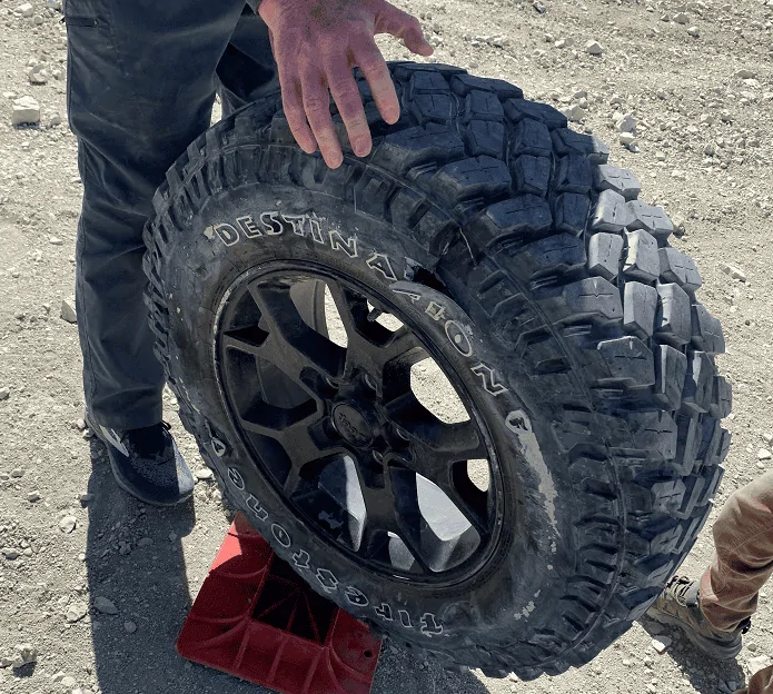

That said, the stock Willys tires are junk.
