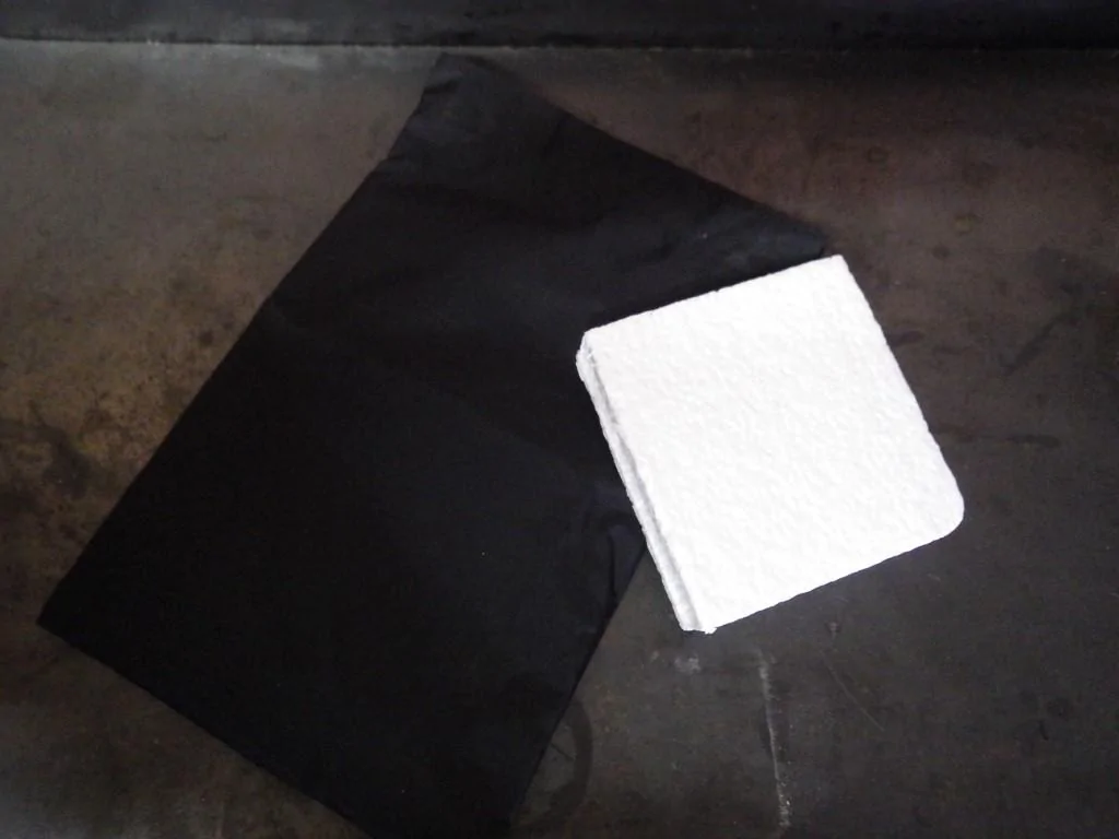

Not sure whether someone else had a good idea, but this is what I came up with, as I do not like to rest the hood straight on the body when tipped over.
I took a piece of styrofoam, and a small bag I had around:

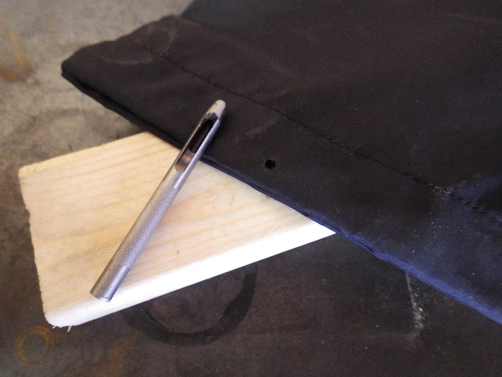

I then punched a hole in the bag:

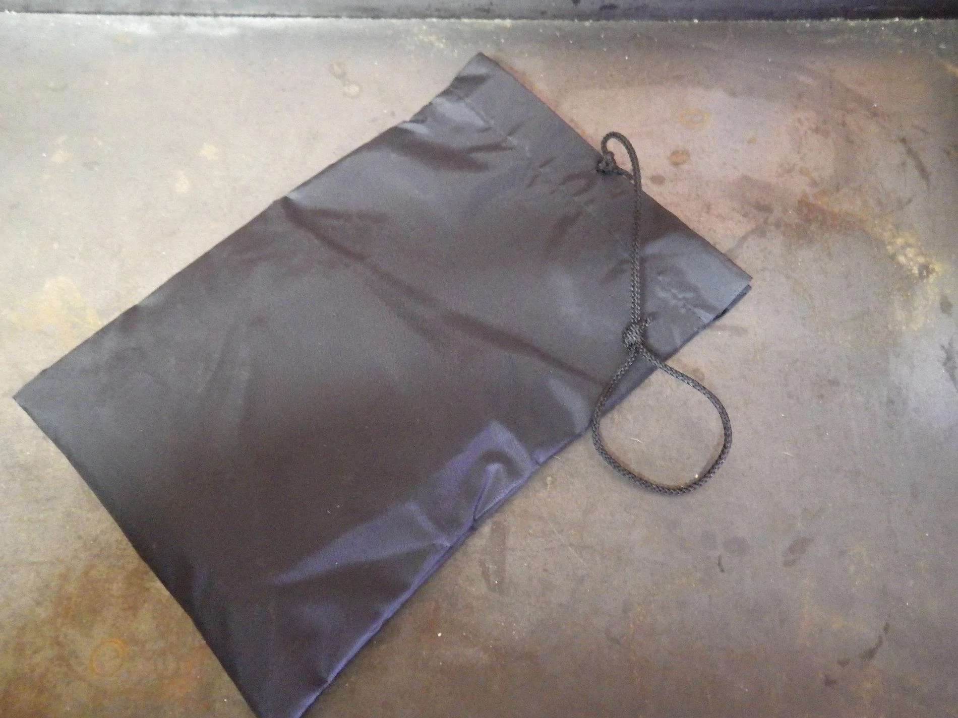

Slid the styrofoam in the bag, and closed it with a shoe lace:
Jeep Wrangler JL Tip hood over protection 2020-05-31 Hood protection (3)
Et voila, tze protection izze ready :)

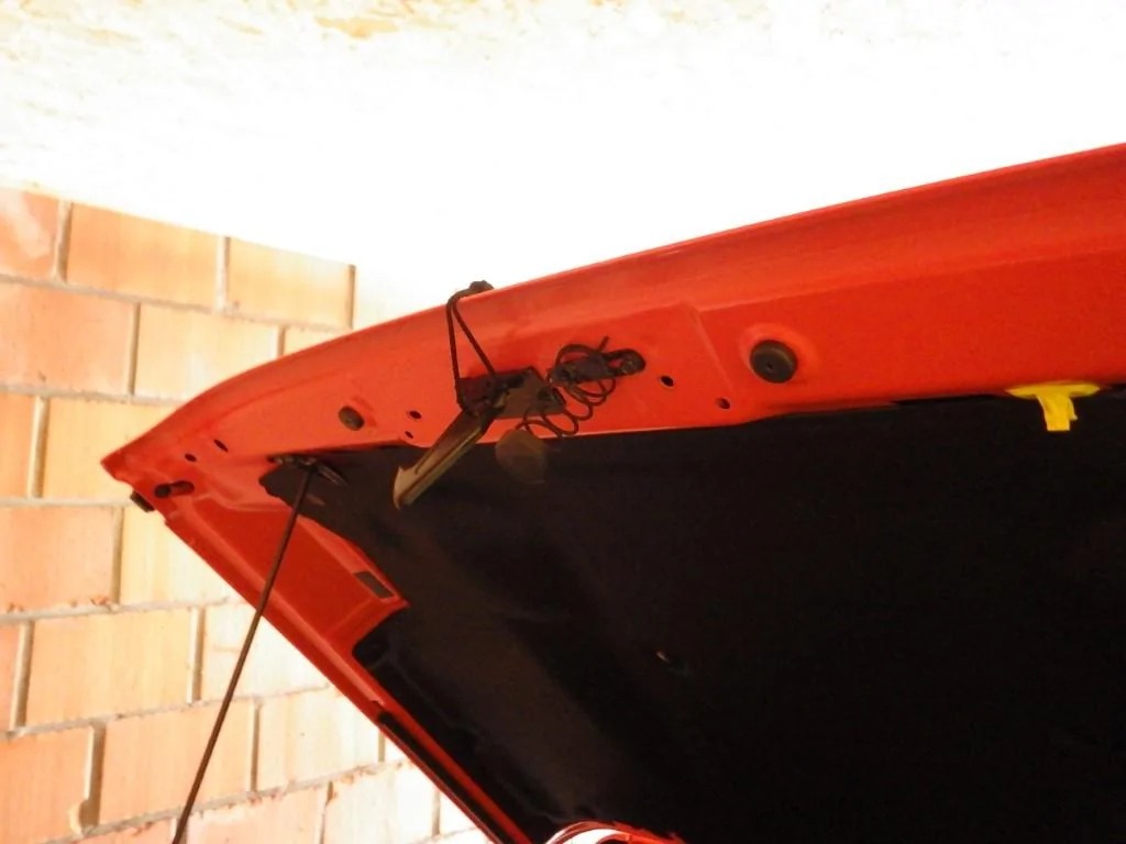

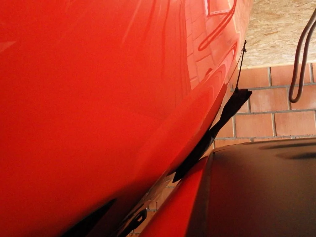

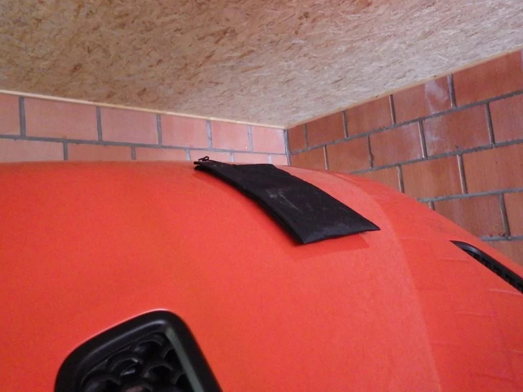

When attached this way, and when tipping over the hood, the little bag with styrofoam will slide by gravity in between hood and body. Cheap, easy, small, and light.
