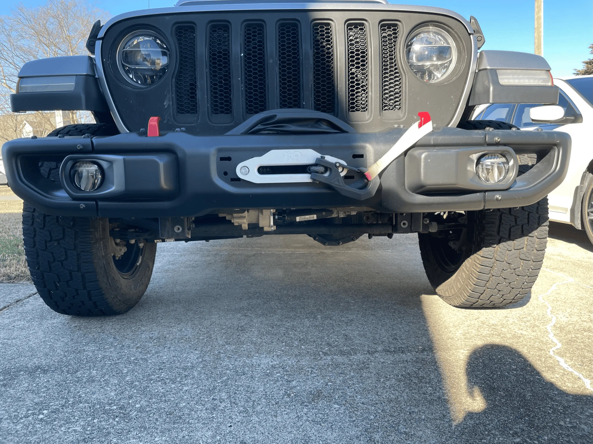

I've got the Rubi steel bumper on my Jeep, a 2018 Sahara. Swapping bumpers was pretty easy but if you're using your old fog lights, you'll need adapters. They're readily available on Amazon or any 4x4 outfitter.

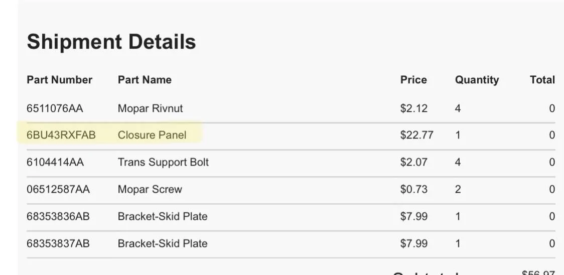

Also, there are 2 small brackets that get bolted to the lower frame tusks for the steel skid plate.

this part number should also be the complete kit. I ordered it and it included the hardware and brackets. 82215183AB
Good point. If OP is buying new skid definitely buy kit ??. My reference list above is for folks that pickup a skid with the bumper (takeoff/resale). Many times they are missing hardware. (Ask me how I know lol)
