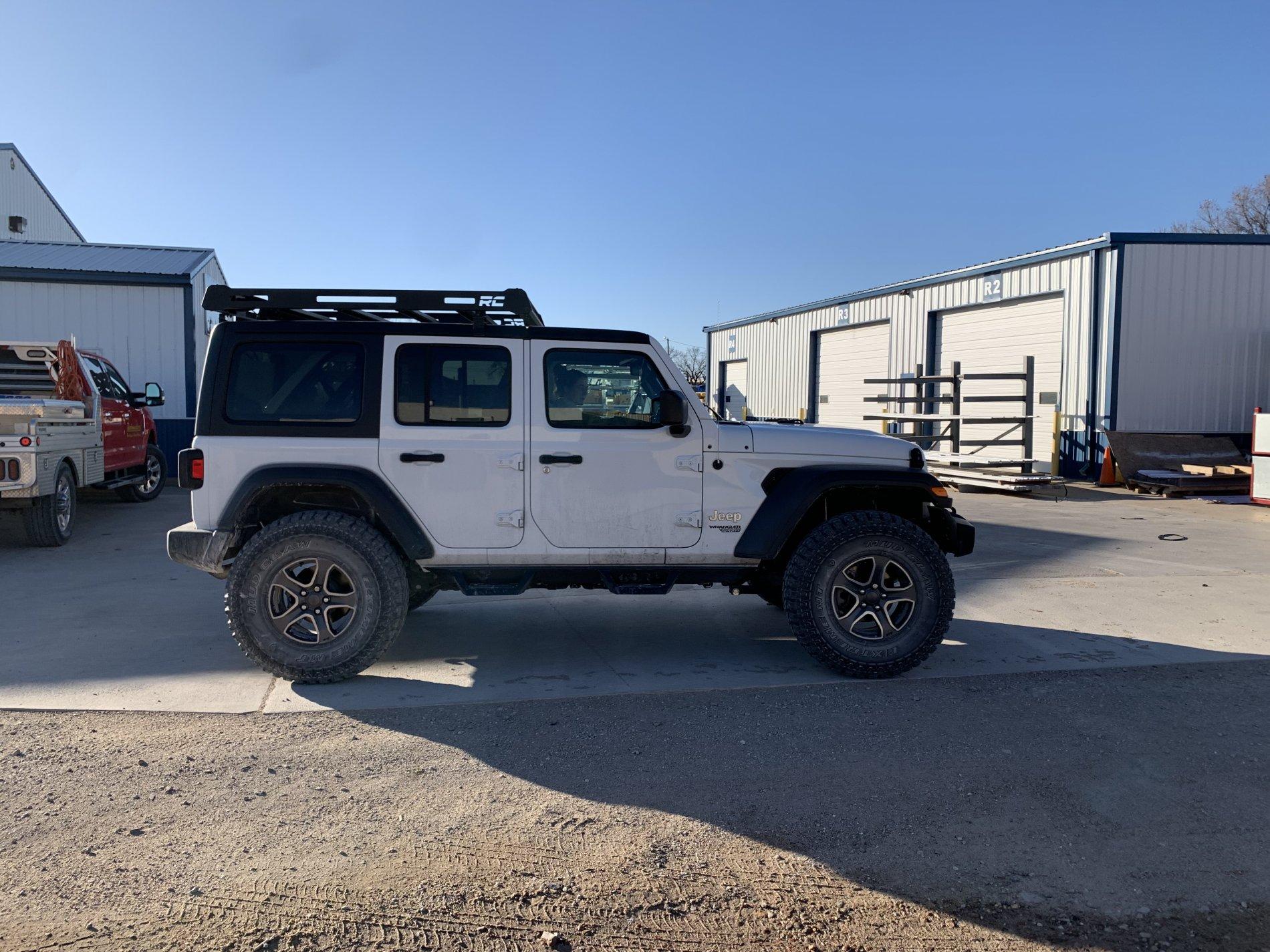

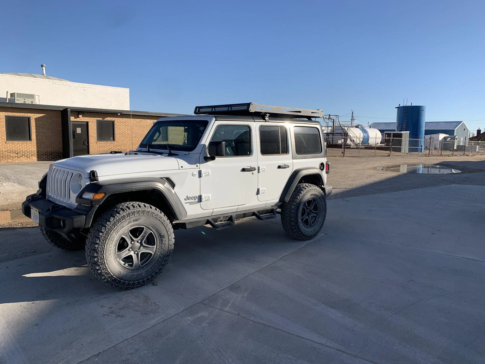

I have recently put a 3.5” lift, 2” wheel spacers, kept the factory wheels cause my wife liked them, and topped it all off with a set of 37x12.5x17 Mud Claw Extreme M/T.
(also, running boards, a roof rack cause we travel a fair amount and the wife insist the dogs kennel be in the trunk forcing our luggage to be relocated, and a different spare tire holder for the larger tire)
Currently, we have no issues or wobble. The steering is just fine, it runs straight as an arrow, and no wobble even upwards of 80mph. All we have is a slight whistle from the rack which is to be expected.
All this leads me to my next mod; a aftermarket steering stabilizer, beings as I’m not using this to hide some issue I am wondering which stabilizer everyone else is running and why? Single vs Dual. Brand. How you like it. Things you’d change.
