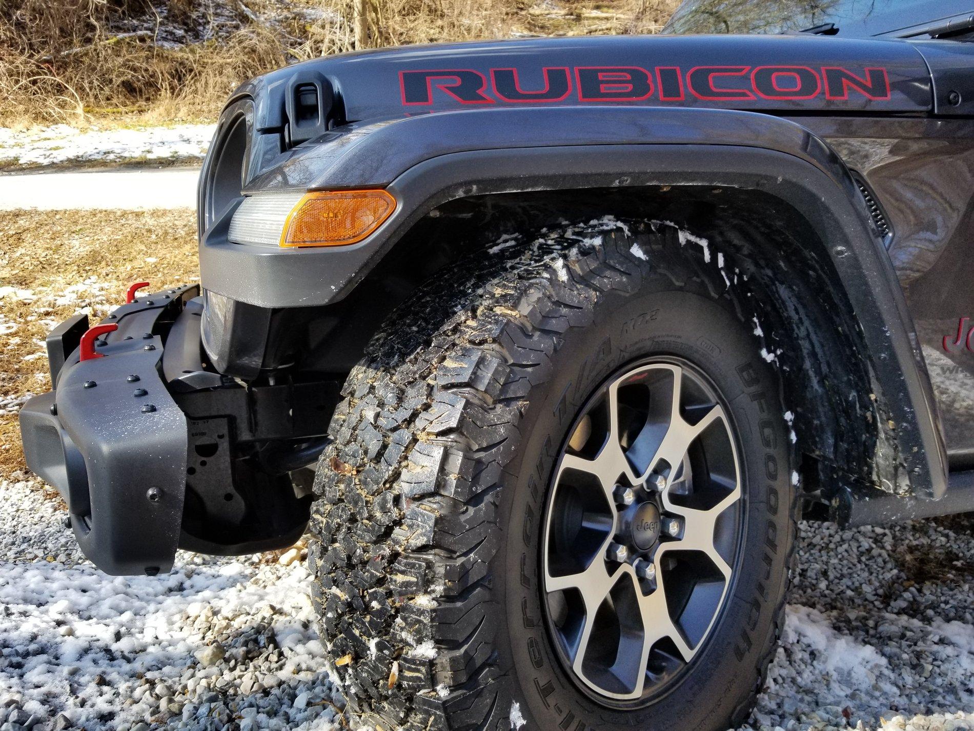

I found a big rock pile (ok, not big) best I could do....
Jeep Wrangler JL Testing lockers and sway bar - dumb question. 20180313_105459
