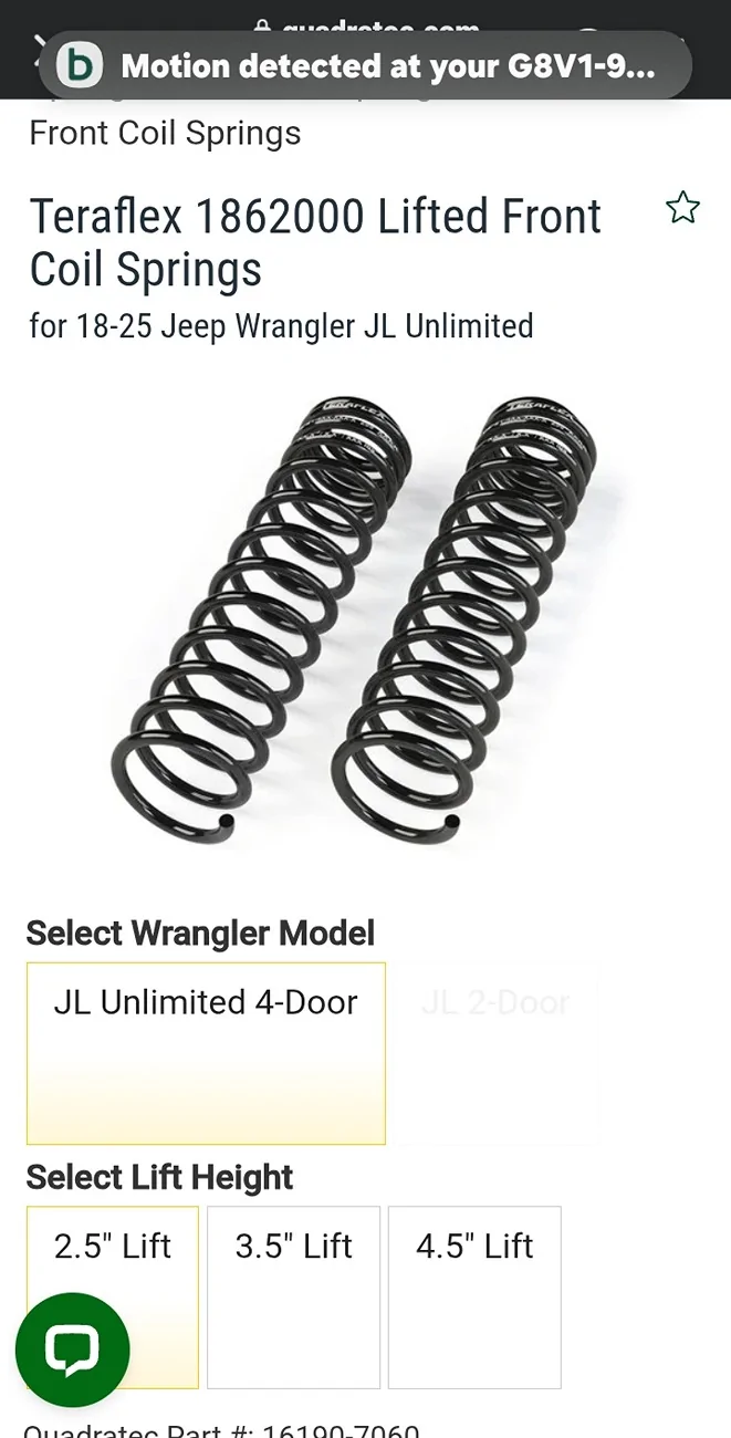

I have a 2024 willys 2.0 4 door and planning on putting this on. It doesnt say if it is for 3 .6 or 2.0, will it give me 2.5" lift exactly?

no coil will give you an exact lift number...if you want exactly 2" you could use spacers that are 2" that is the only way otherwise there are too many variables...most coil lifts give more than advertised unless you are really heavy then they could be less.

. Reason i asked is i want to make front and rear even height, right now my front is 1 inch heigher.

just add 1" spacers to to the rear and you will be level.

I already did teraflex 1 inch to the rear. I didnt mention i have take offs 392 final edition suspension spring/ shocks 2" but mines 2.0 i ended up with 3.5" front and 2" back now 3" with teraflex 1" spacers. The front is stiff as hell i could feel everybump. With teraflex 2.5" springs i might even out the height with the rear and soften the front a bit with lower spring rate.
