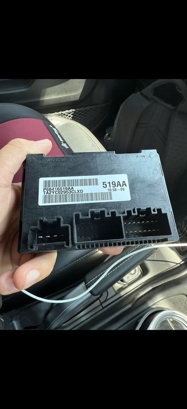

This is the replacement

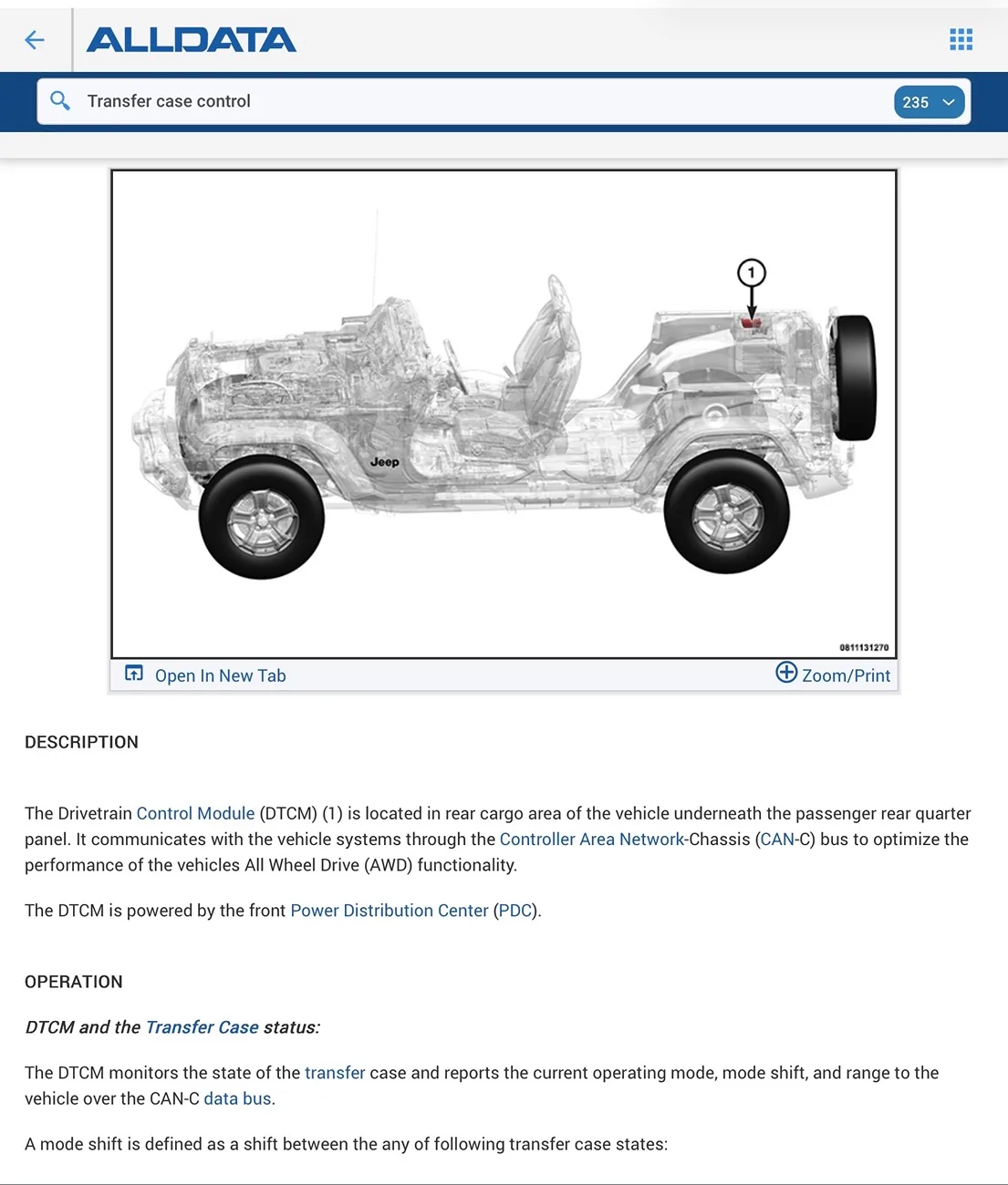

Just guessing here .Not a mechanic and not familiar with right hand drive. Here is what AllDataDIY shows for a module that monitors the transfer case for an 2023. And a possible pic of the location from an 2021 although when I look up your part number it shows a different kind of mount. This is an older pic so Im guessing the part number has been superseded or I am completed off base.

Wow 😲 nothing ever showed that the module would be there? I will have a look tomorrow and let you know! Thank you soooo much for this 🙏

Well if I’m right thats cool…but it’s just a guess.

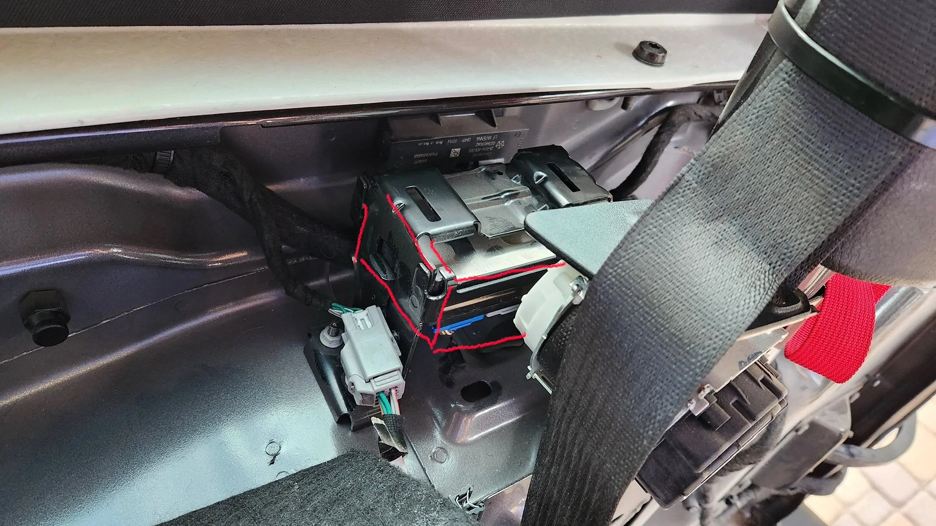

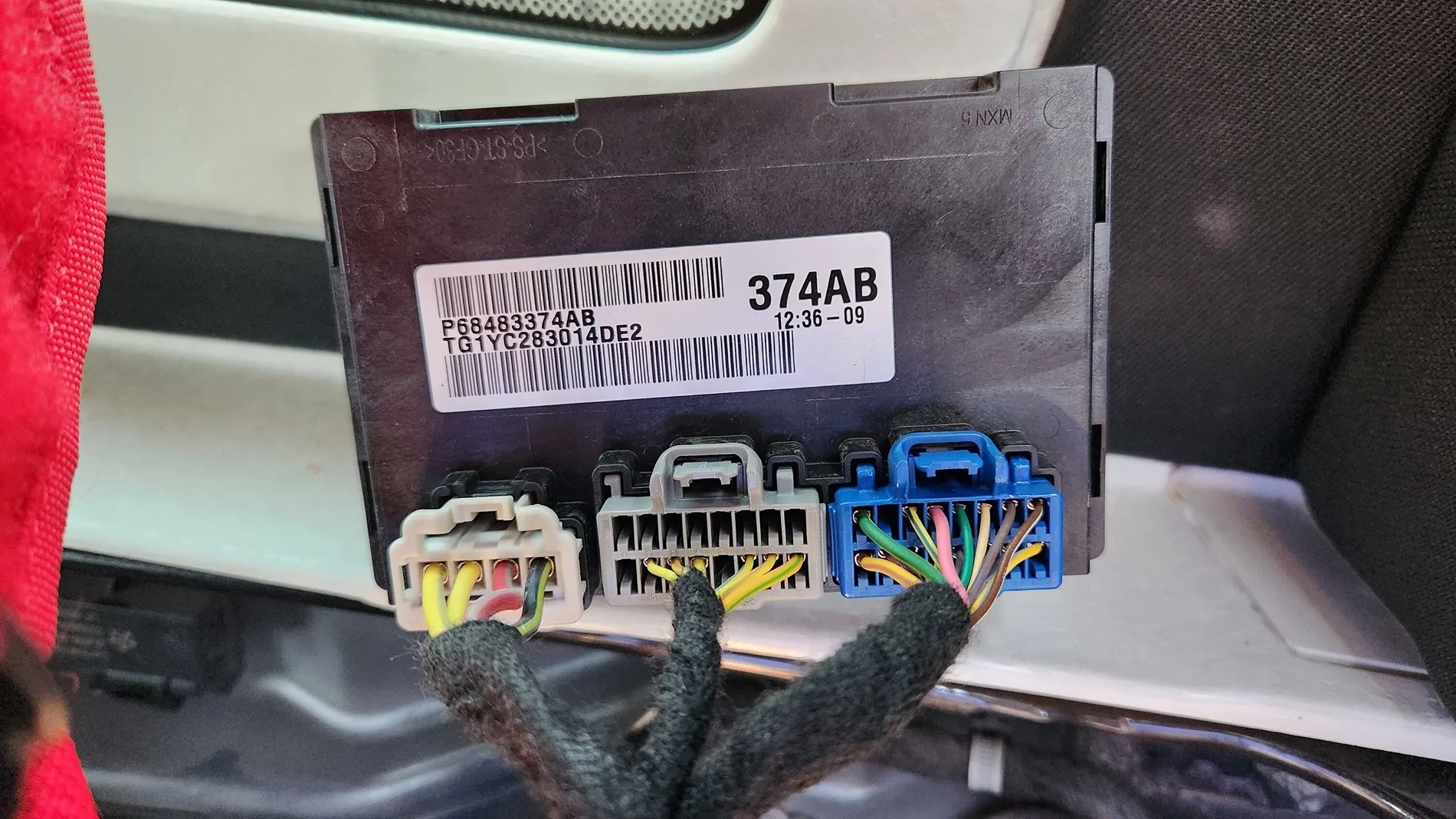

Was it there?
It was THERE!!! UNBELIEVABLE!! Thank you
