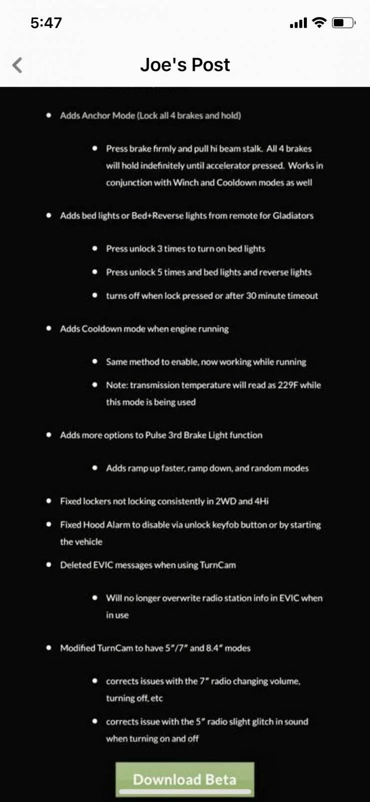

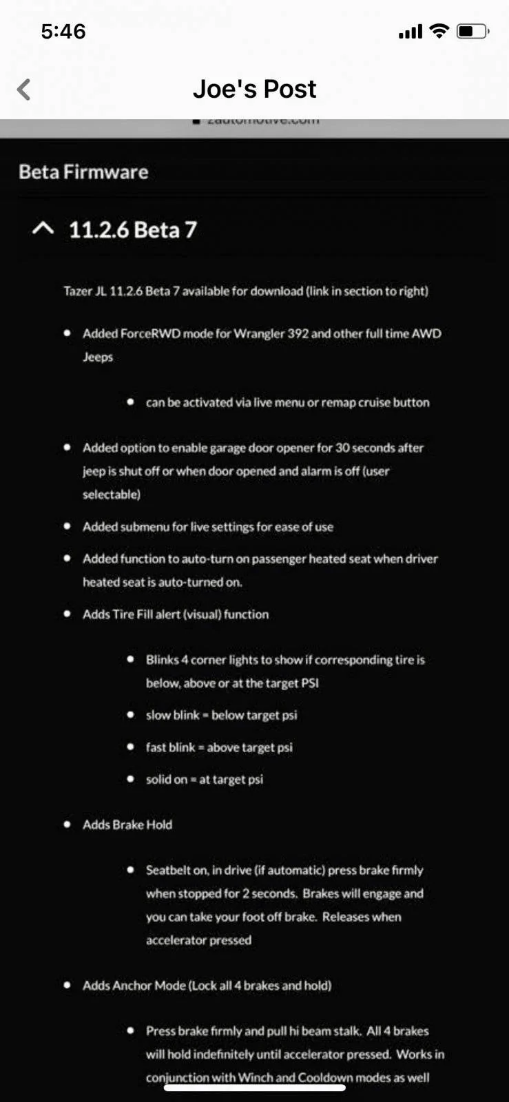

Joe @Joe@zauto just posted on 392 FB page that he has uploaded a new beta. Some cool features.

Those are some nice additions, Tire fill alert function is going to be super convenient at night. 2wd mode for the 392's, oh boy! Had just been sitting in the cart...Purchased

Anybody know how to install the new beta onto the the Tazer JL? I open the Tazer program on my computer and it says that I already have the most up to date firmware (11.2.5). When I download the beta file the computer doesn’t know how to open the .zfw file.

At the place where you hit update, should be a tab that says manual, next to the auto tab. From there, select the file you downloaded and then hit flash. It’ll update with the beta version.
