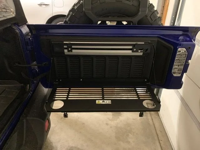

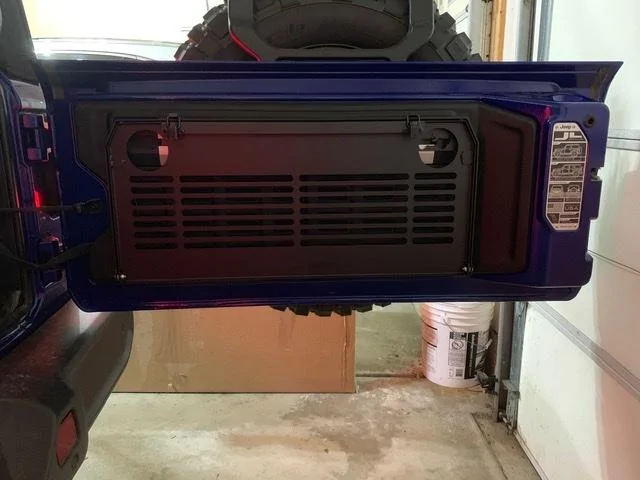

KCC_703
Ken
Jan 25, 2019
97
2019 Sting-Gray MOAB
Please send pics when you have a chance, appreciate it brother
Sorry, forgot to snap some pics of the gap before removing the entire tailgate trim piece. Removing the trim and upper standoffs got me another inch of space. The cargo mat still needs another inch to sit flat... but this might help folks with the table that doesn't have the additional slide out board.
The tailgate table use the two outside holes of the TRMS rail. Longer M6 screws and longer standoffs on the bottom should allow the table to fit over the TRMS. The table will cover the rail when stowed...
