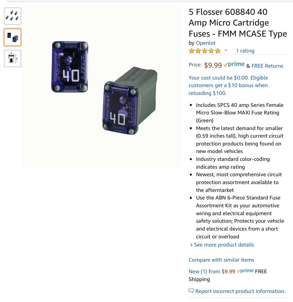

The 40 amp fuses or the smaller 15 amp one? I somehow blew a 40 amp one and they are a mopar only part apparently as I can’t find them anywhere. If anyone has a part number for the 40 amp slot style fuse that would be great.
These fuses are the right size but the slots have to be fully open and these aren’t.
