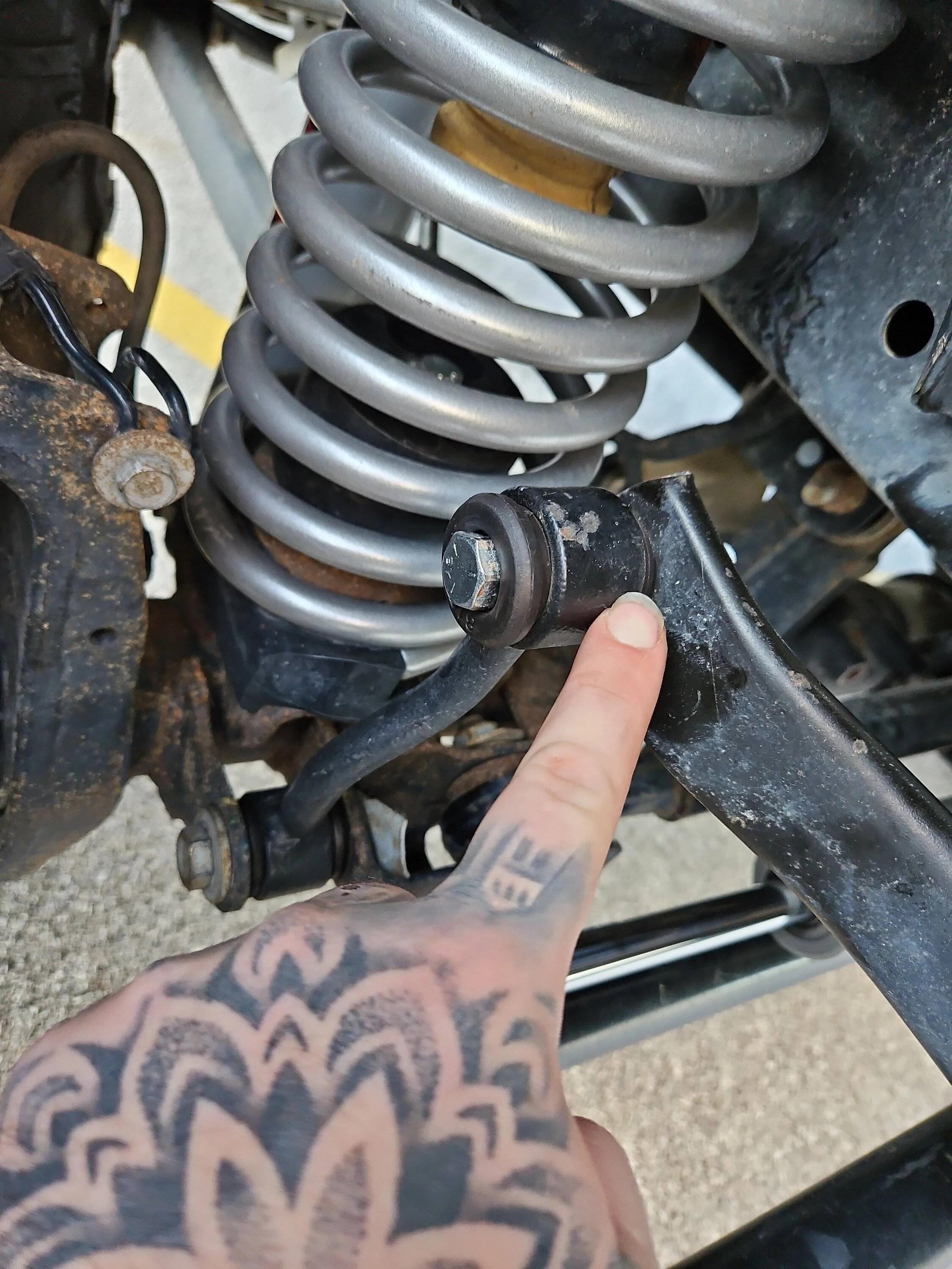

I noticed that my right side end link nut was almost coming off. I can't seem to tighten it ant further... like it's stripped.
I was wondering if anyone knew the size or nut size of this bolt?

is there an allen key on the inside side? there should be, you put the key inside and tighten the nut from the outside

Lol no it's a regular nut on there. Completely different from the other side.

So, normally the top bolt is part of the end link (on stock end links at least) and not a thru bolt... That swaybar end link looks funky (to me) unless they've changed them for later/different models... if so, then just ignore my post.
My stock sway bar links looked like these: https://www.quadratec.com/p/mopar/f...UVtyxU1hlDnGasARHaaiVom8cn3z9Wq0aAio8EALw_wcB
Those are long gone now, otherwise I'd be able to confirm for ya.
If you're still looking to replace the nut only, then maybe the guys are @AllMoparParts.com can help you find the part. They're pretty darn good at tracking things down.

Running a 2.5 inch rough country lift. If I remember correctly they came with Endlinks.

Usually there’sa 6mm hex opening in the end of the bolt. Motor side. You are also missing the outer washer. There should be one between the bolt head and the bushing. Like you have on the axle link. Could be why you can’t torque it enough since you’re crushing the bushing.
